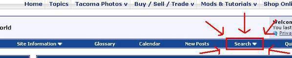

    I love when I get to bust this out
    naw but seriously you just need to lube up the bushings
