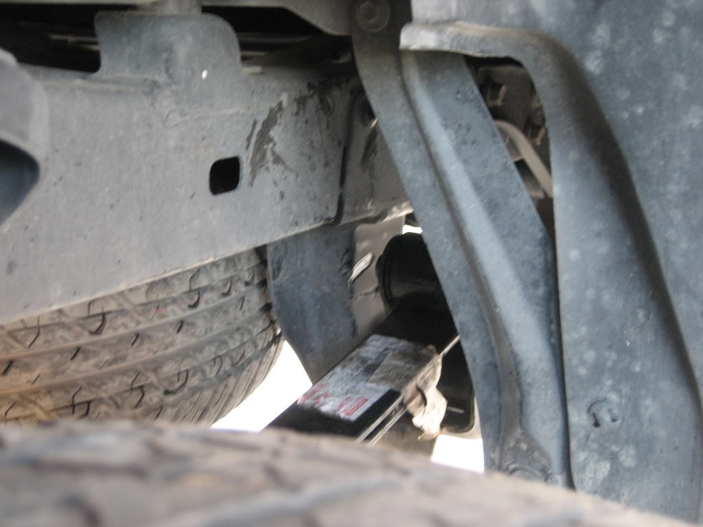

    Figured out what it was. The dealership had put the mounting bolt in the wrong way. The way they had it in it was grinding away at the bracket thus making the squeaky noise. The dealership just took the bolt out and turned it around. It left a really good grind mark on the bracket. I'll take a pic whenever I get the chance.

    Here is the scrape mark that the bolt had left on the bracket. Let me know if you don't see it, i'll put an arrow on it. Its right above the leaf spring.

    I see it. What a bunch of incompetants at that dealership! What did they say when you pointed that out?

    hey moto.........you may wanna get a little primer/paint on that scar so it doesnt start to rust.

    Here's the story, I took it in and said "hey, listen to this. It shouldn't sound like that." Mitch, one of the service managers said they will take the springs off and lube them. At the time I still couldn't figure out what was causing the noise. I just wasn't looking at it at the right angle. Mitch calls me a couple hours later and says my truck is ready. I get to the parking lot and push down on the bumper and it still freakin squeaked. So I went and talked to Mitch about it again. And he was like "what the hell, I watched the guys lube those springs. Him and I went under it to figure it out and thats when we spotted what was causing it. I don't blame Mitch for not knowing what was causing it. He's in a manager's position and he puts about a 100 cars through their service center a day. I blame the people that were actually working on my truck and gave the go ahead saying my truck was ready without even checking to see if it still squeaked anymore. Bottom line the people cranking the wrenches back there need to know what they are doing and what the problem is. So much money and time is wasted on nonsense like that.

    Yeah I thought about that. I'll pick some up this weekend. Have any suggestions on what to put on it? It needs to be some heavy duty stuff to put up with the crap that gets kicked up there.

    i think i'd get some rustoleum primer, then go over it with 3 or 4 coats of some rustoleum flat black, then spray some undercoating on it. you should be good with just the paint......the undercoating is just a little extra protection for the spot.
