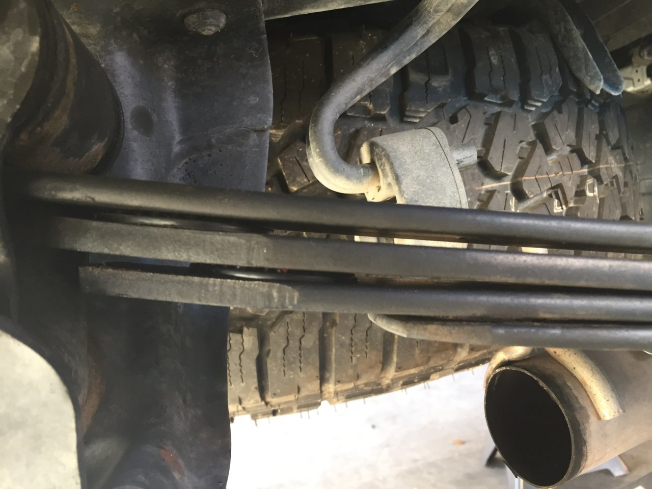

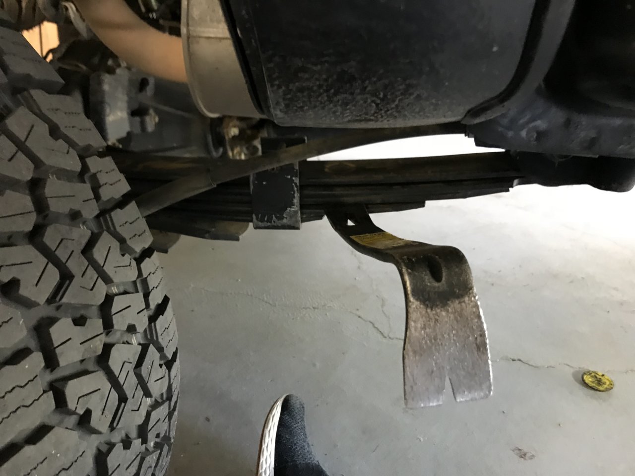

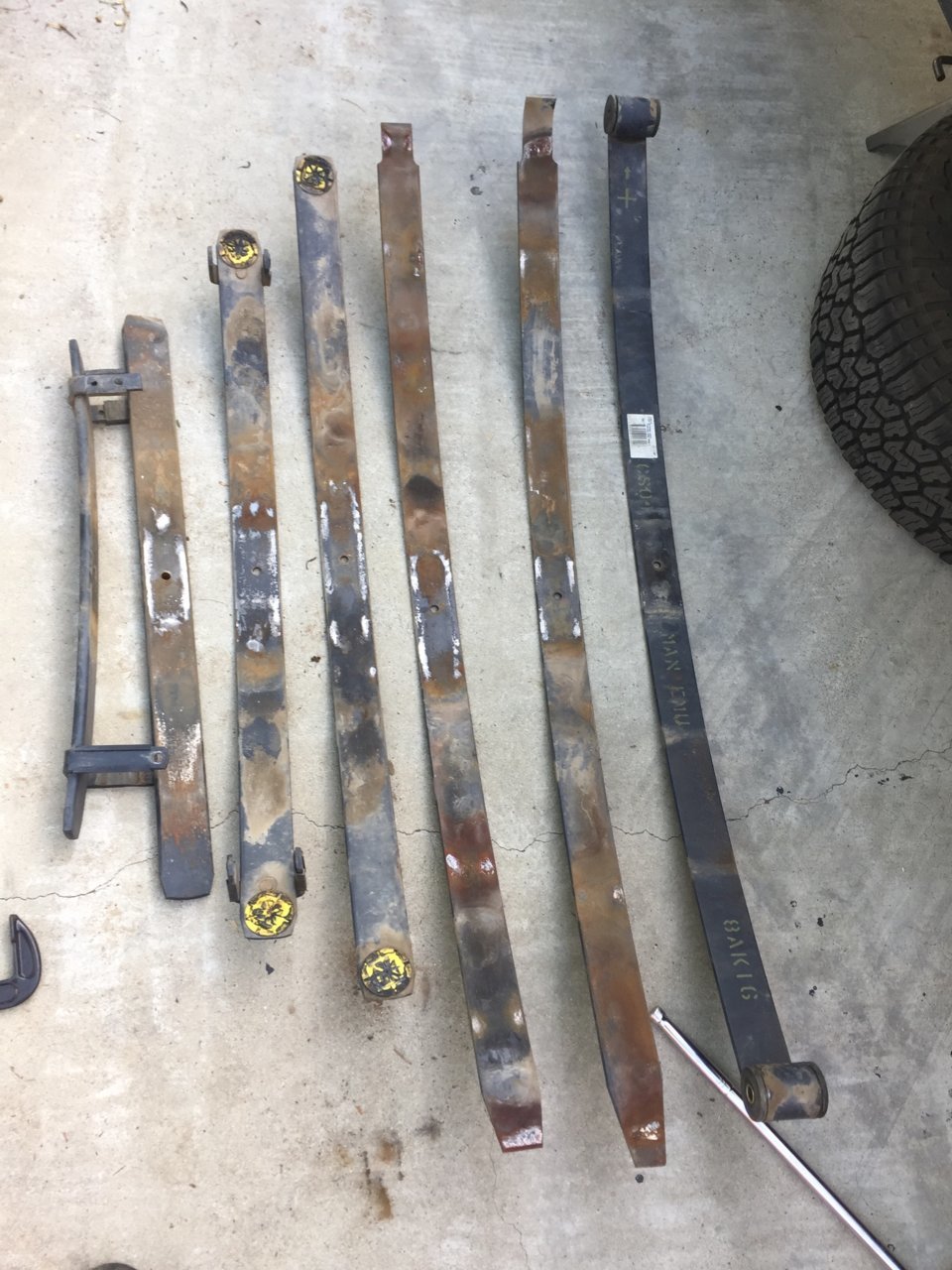

    This is what I use.
    Recoated leaf pack...
    Add some new leaf liner, and Silicone that that to the leaf pack... and added grease like crazy...
    Also added these bad boy.
    Problem solve.. For now....

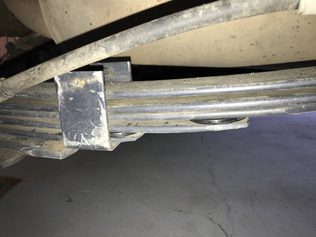

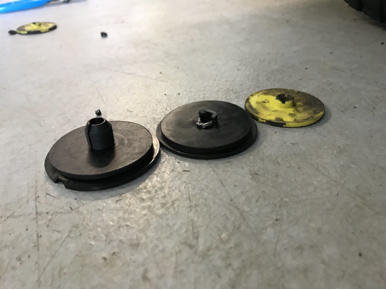

    These leaf isolators definitely helped. For them to fit the dakar leafs, one half of the alignment pin needs to be cut off and the remainder shortened. Now, the only squeak I hear is from the shackle mounts.

    They're designed for the fixed end, but you can also buy a 2nd pair for the shackle end, they work the same on both ends.
