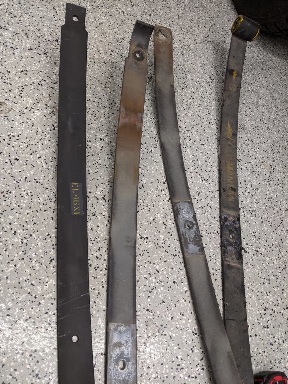

    Don't buy ARB's overpriced isolators or any ARB/OME replacement parts if you can avoid it. Invest in a better leaf pack. Dakars are great on a fireroad, at speed. Anything else and they are garbage. Speed bumps, driveway curbs crossings. I know, I have them and they have been a constant regret. Anyone ever been in a bouncy house?? You can expect a similar experience when you are traveling on terrain that isn't in Dakar's sweet spot. They have 2 strikes against them without the squeaking. They are still SOA (spring over axle, VERY limited uptravel which is the MOST important part) and they don't perform as marketed.
    Back to the topic ... The new isolators. They are mild steel that has been cnc/plasma cut and painted. NOTHING SPECIAL! Make your own. They just made them thicker. Half-ass move that doesn't solve the problem of the leaves coming into contact in between the pads and isolators. How do I know?
    Can you see the rust where they are rubbing. Unless you put some really thick pads, this is always going to be a problem. There is a way to help this but it will not permanently eliminate their poor design.
    I tore apart my leaf packs this week and did this and a AAL to get me buy time until I go LT/SUA because SOA is fine for driving off the dealer lot and picking up groceries.
    • Go to a hardware store, buy a 18" x 6" x 16ga sheet metal.
    • Cut them in 2.25" strips and drill a hole for the center pin.
    • Deburr and paint if you want (I did)
    • Butter all the leaves with red tacky #2 or heavy grease that will not wash off.
    • Reassemble leaf pack
    • Apply Moly grease to the bushings, sleeve and bolts.
    • Torque and re-check after 50miles and 150miles.
    • STOP AND RE-READ THE PREVIOUS STEP.
    • READ THE NEXT STEP LIKE YOUR LIFE DEPENDS ON IT
    • Torque and re-check after 50miles and 150miles. (I typed this twice because ITS IMPORTANT AND PEOPLE DON'T CHECK)
    Word of caution. Be liberal with the red grease but not sloppy. You don't want this oozing all over the place. Same goes with Moly grease! It's incredible and you could probably paint a car with only a cap-full. It likes to coat...everything.
    Final notes: ARB changed the design on the leaf pads. They no longer have the grooves to hold grease. you can still add grease from below but will have to do this ALL the time because there is no way to reservoir grease to last longer. Oh, and they retail for $4 EACH for a 2.5" piece of round plastic with a pin hole in the middle. You will need 2 per leaf = 12(standard) or 16(heavy duty).
    If you are still having squeaks after this, its something else or the leafs are flat (they can be re-arched). Let's stop and think about how much time and money is going into low performing leaf pack. Don't! Go invest in a better pack and give them away, sell them, melt them down into rebar...anything would be more useful.
    Cheers everyone!
