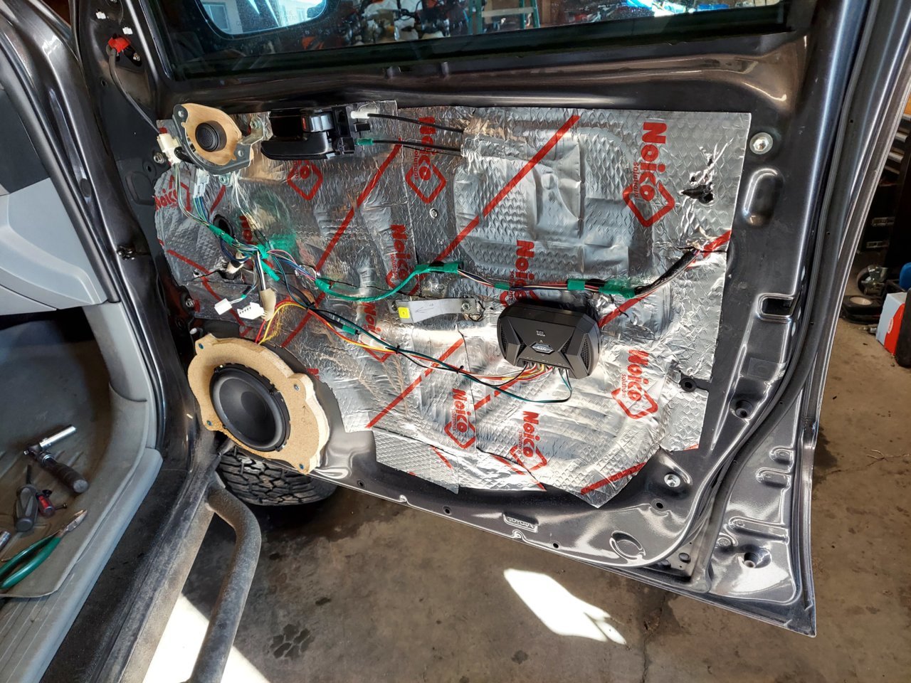

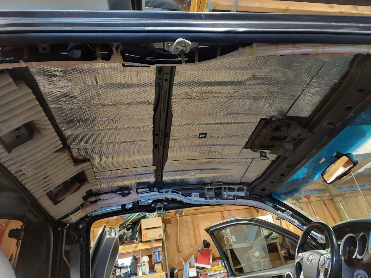

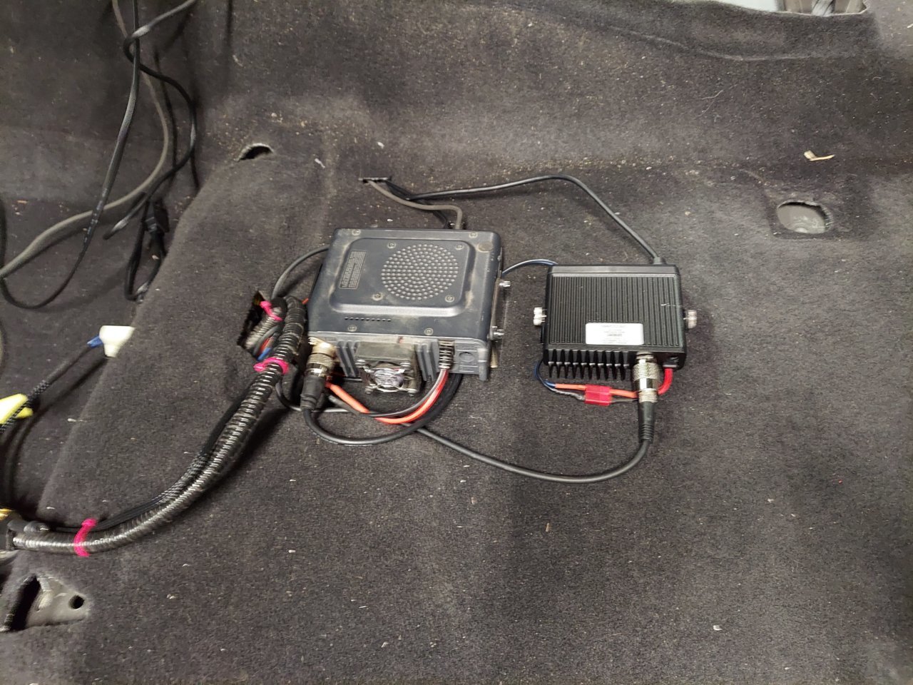

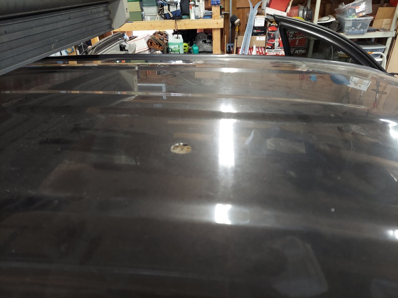

    Lots of sound deadening installed. Butyl and closed cell foam on the roof, added some foam to the butyl that was already on the back panel, and butyl plus Second Skin mlv/foam on the floor. Sounds like the doors are already deadened, but I'll give them a once over when I have a chance. Also installed my Ham and CB radios under the drivers seat.
    Nothing like drilling a big, irreversible hole in the roof.
    Very pleased with noise levels now.

    Sound deadening on the doors looked sufficient, so I moved on to fabbing a bike mount for the bed to make use of space as efficiently as possible.

    Is there vapor barrier under the MLV over the big hole in the door? Doing my rear doors now and get mixed opinions on whether just the MLV is fine without the vapor barrier

    They looked pretty solid. :notsure:
    I was just happy to see the JBL components. I assumed they were takeoffs from a factory JBL truck.
    That's all foil covered butyl, I only used MLV on the floor.
    Didn't look like the vapor barrier was still there. I threw it out on my 1st gen too and it's been fine for a couple years.

    OK, that's what I'm using, wrong term :thumbsup:
