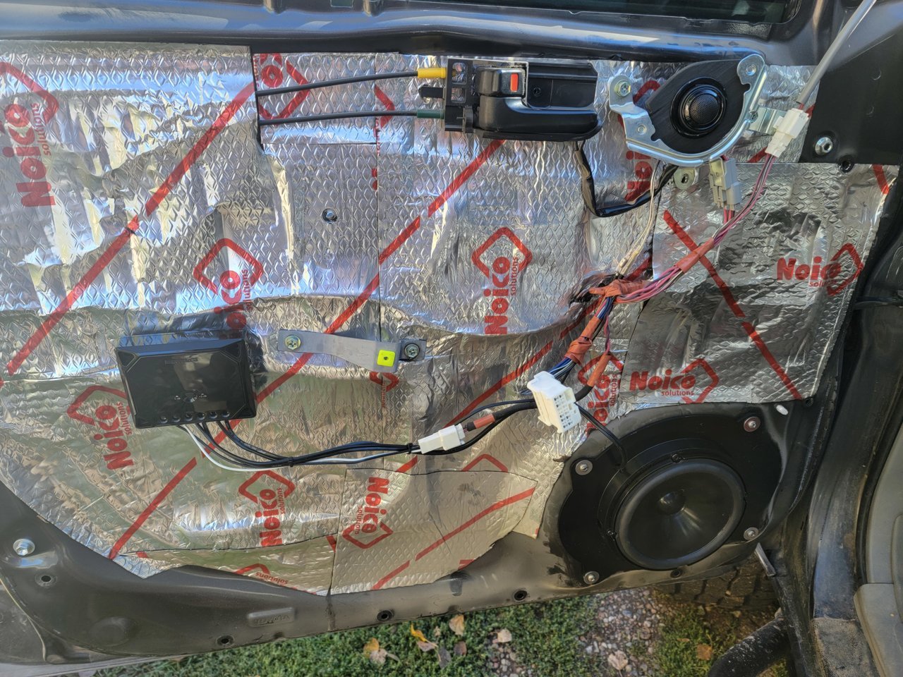

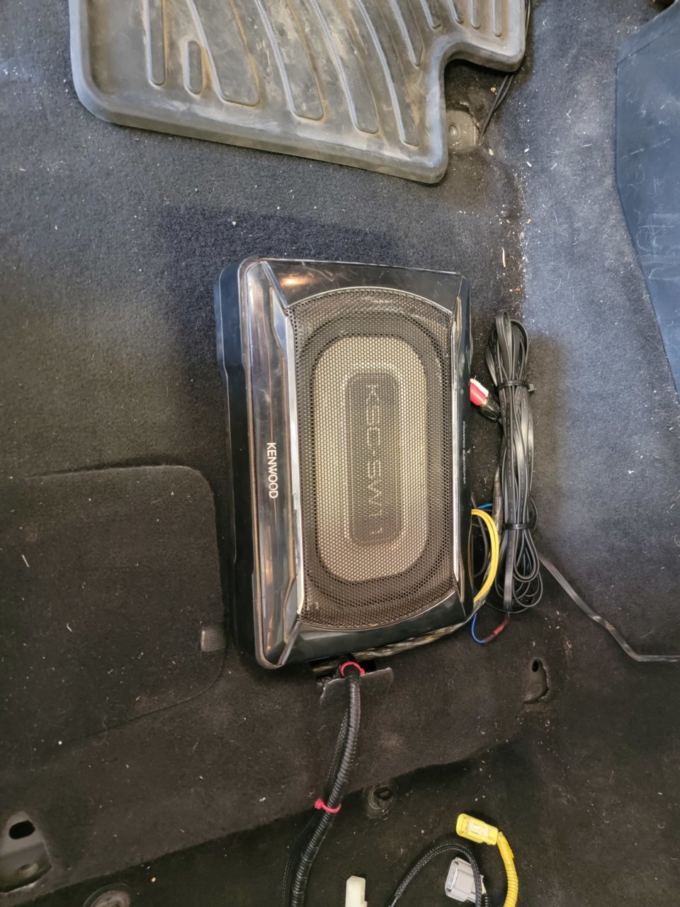

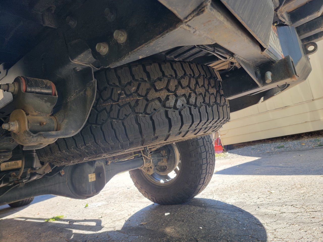

    I have done a bit of audio work recently. One of my tweeters was dead, so replaced the JBLs with some Infinity reference components, and swapped the powered sub from the 1st gen over being it didn't fit anymore. :anonymous:
    And finally got a full-size ish spare by the way of a 255/80r17 Wildpeak. Kinda debating going down to that size so I don't have to do more tire clearancing anyways. I do need to do the mod to move the spare tire winch back an inch for diff clearance though.

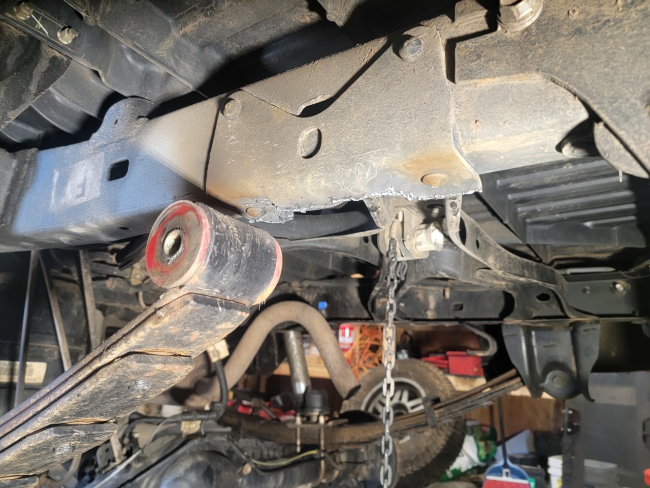

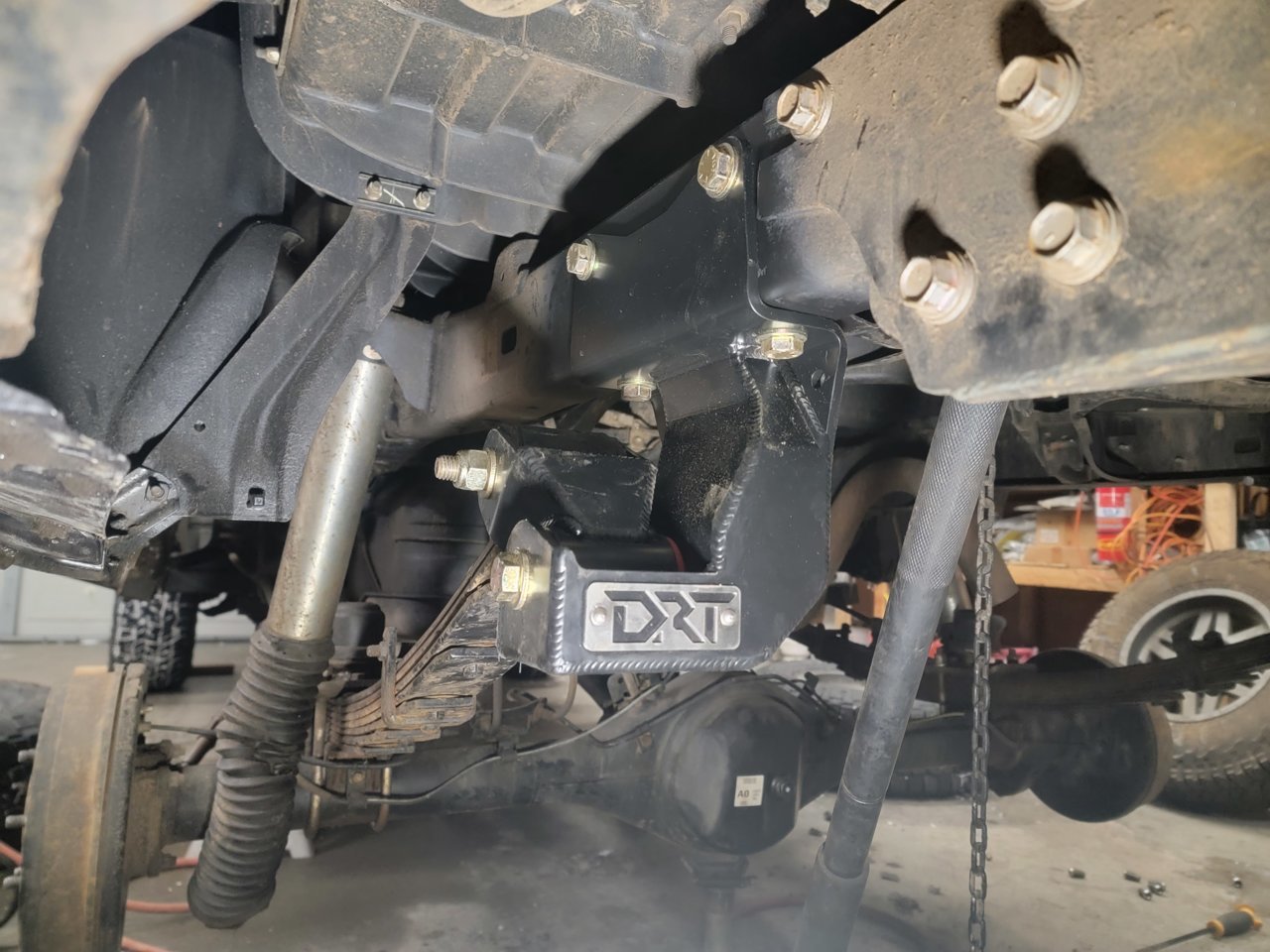

    Decided it was time to replace the bent hangers.

    Cant really call the stock hangers hangers. they are rear leaf spring locators made out of warm butter

    Heimed uppers and gussets installed.
