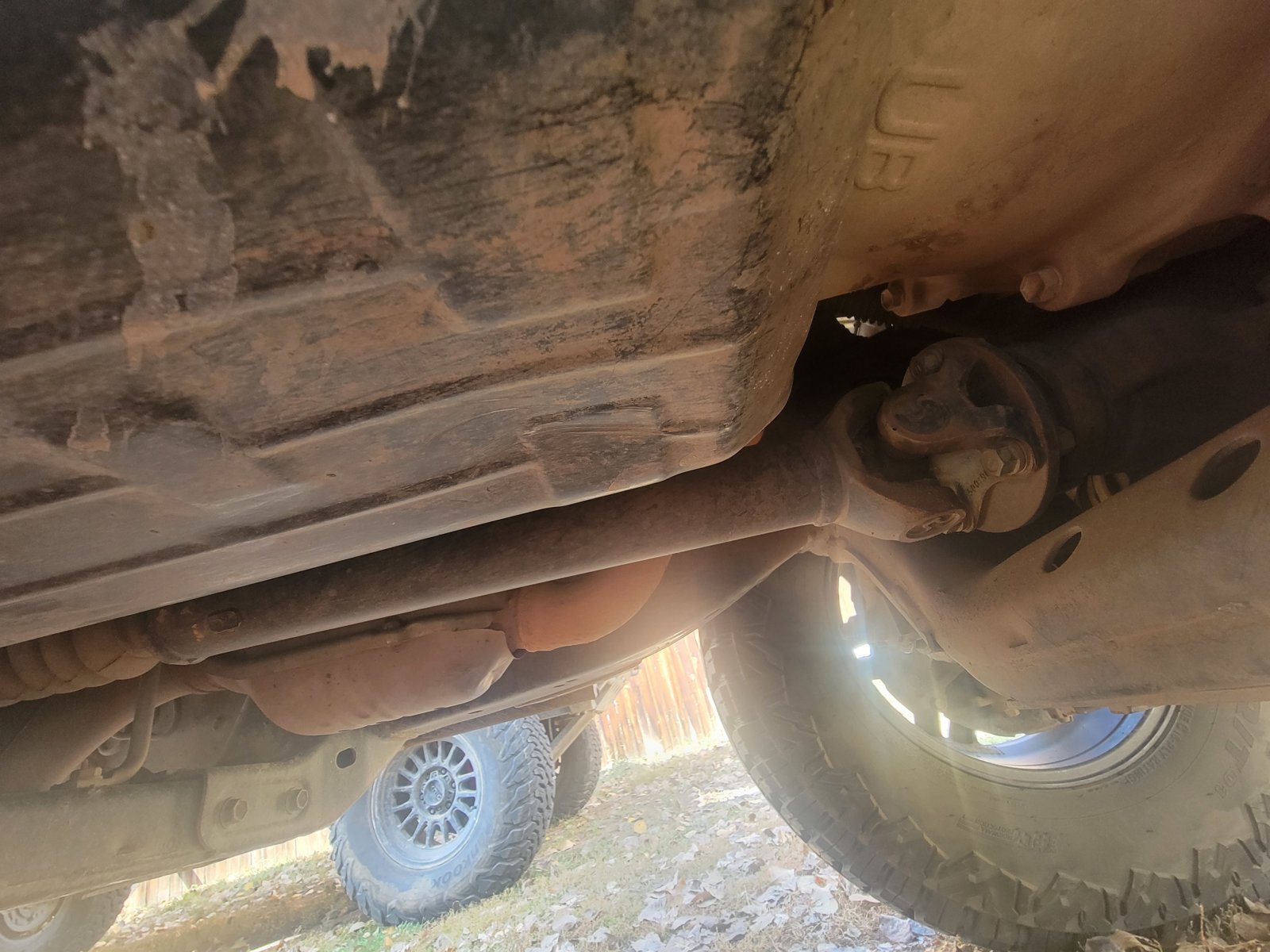

    Oops. Maybe I should get some aluminum skids...

    Barely touched it.
    Now that it's self-cleared, shouldn't happen again.

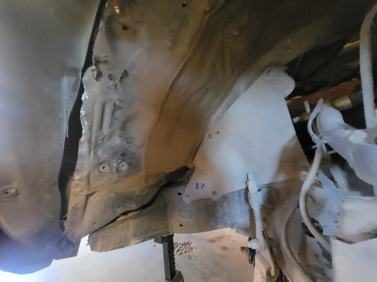

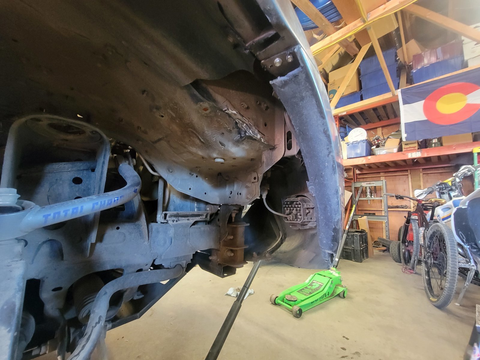

    Another year with hardly any updates in here. Which was kinda the goal of this truck....

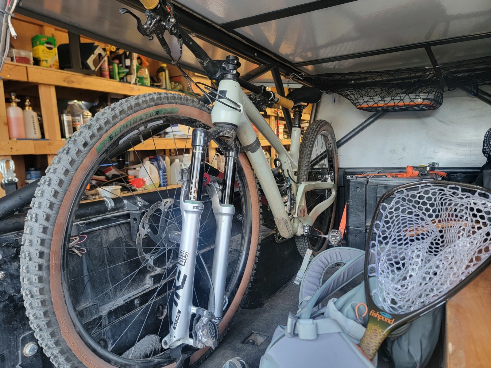

    I finally pulled the coilovers and actually clearanced the tires. Took removing all the fender liner up front and some more in the back, a little bit at the top of the flares, hammering over all of the pinch weld and some of the firewall, and was rubbing a spot up front on the inner fender that took some BFHing. Luckily no issue with my first CMC.

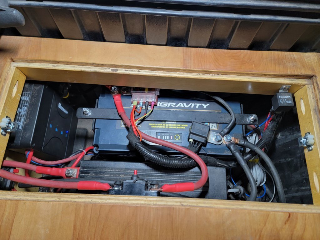

    A dead starter battery prompted me to upgrade my house battery to a lithium and move the heavy Northstar up front. I was a bit concerned about how the self heating would work in the cold, but everything seems to be working great.
