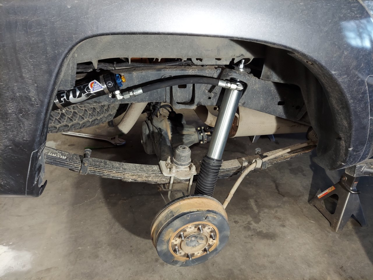

    Modified Fox Tundra rears with DSC setup by @TMFF are installed. Hoping the fronts show up soon.
    Been working on several other projects getting this thing ready for its first proper trip in a couple weeks. More updates to come soon.

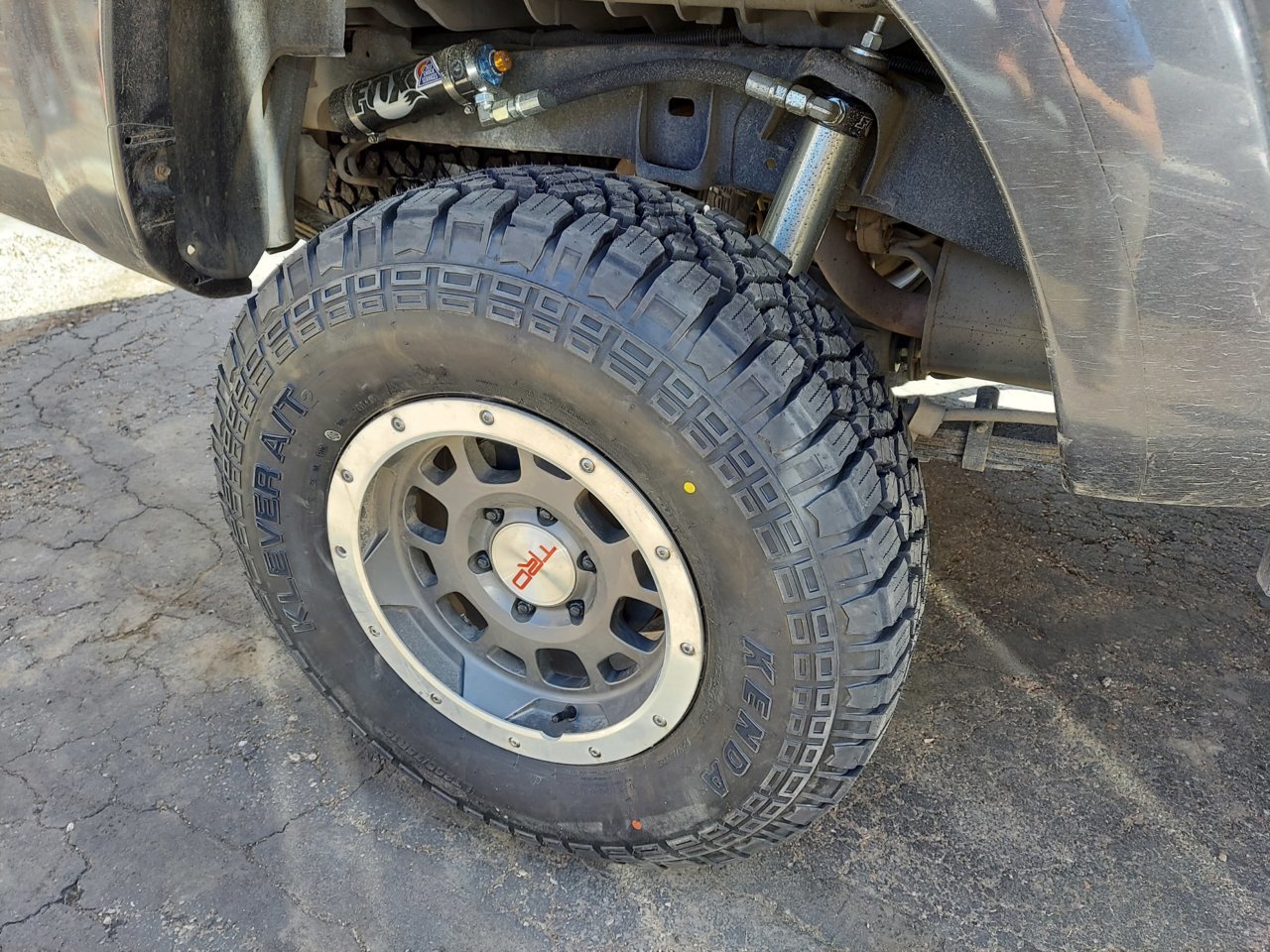

    265/75 Kenda Klever ATs are on.
    Was very tempted to go up in size, but sticking with little tires for now in favor of weight and milage.
    Also pulled the tpms sensors so I don't ever have to deal with them, need to cut the wire behind behind dash now to get rid of the light.

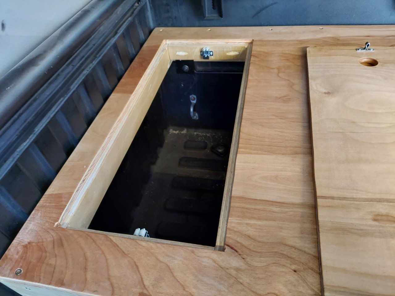

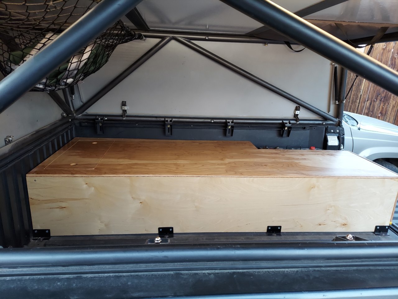

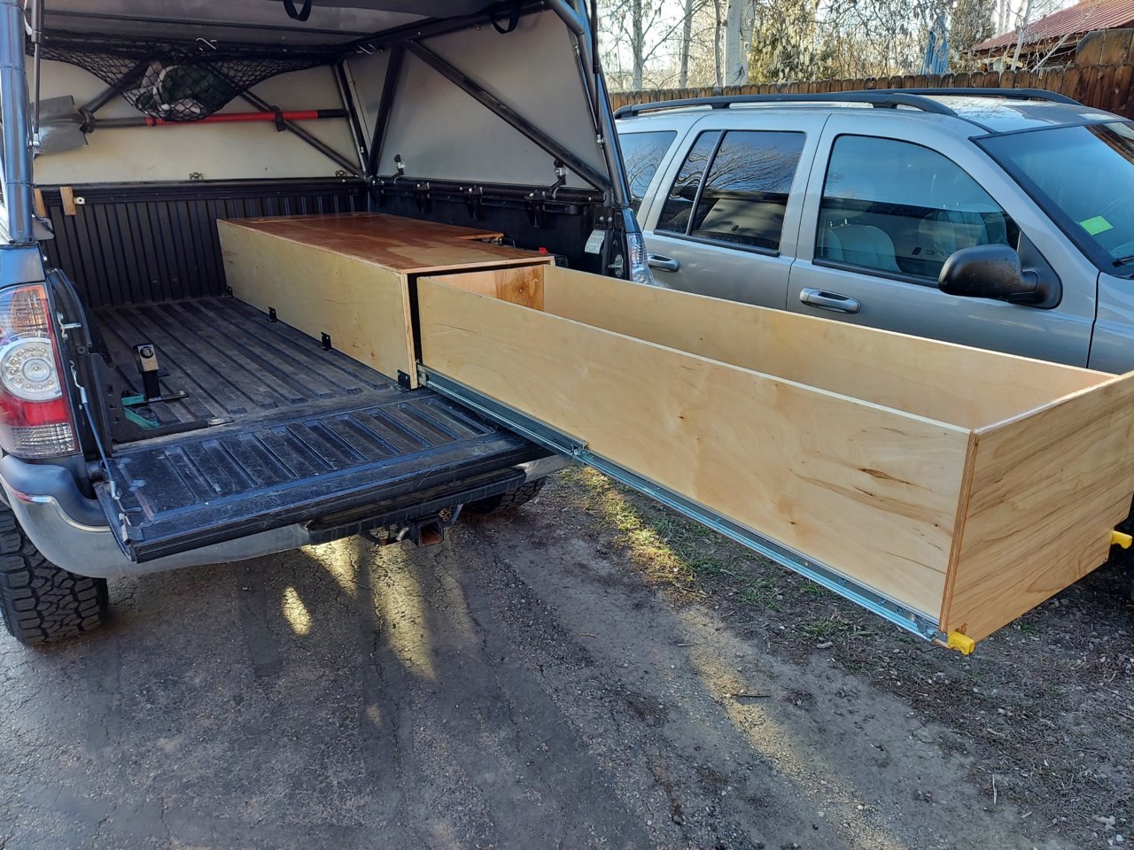

    One more project kinda done. I'm not great at woodworking, so this was a bit of challenge and is far from perfect, but I think it should hold up alright. 60" drawer slides and a cubby up front for my battery and electrical.

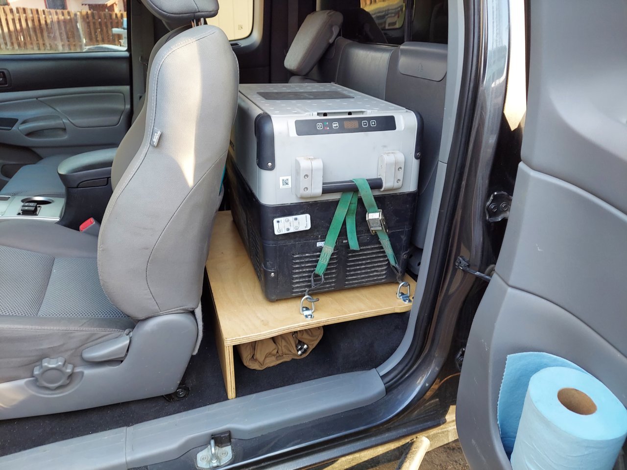

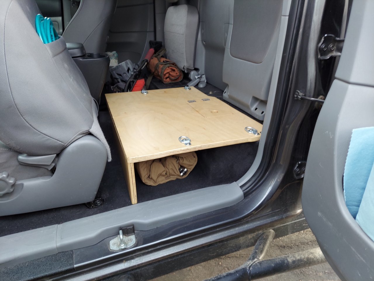

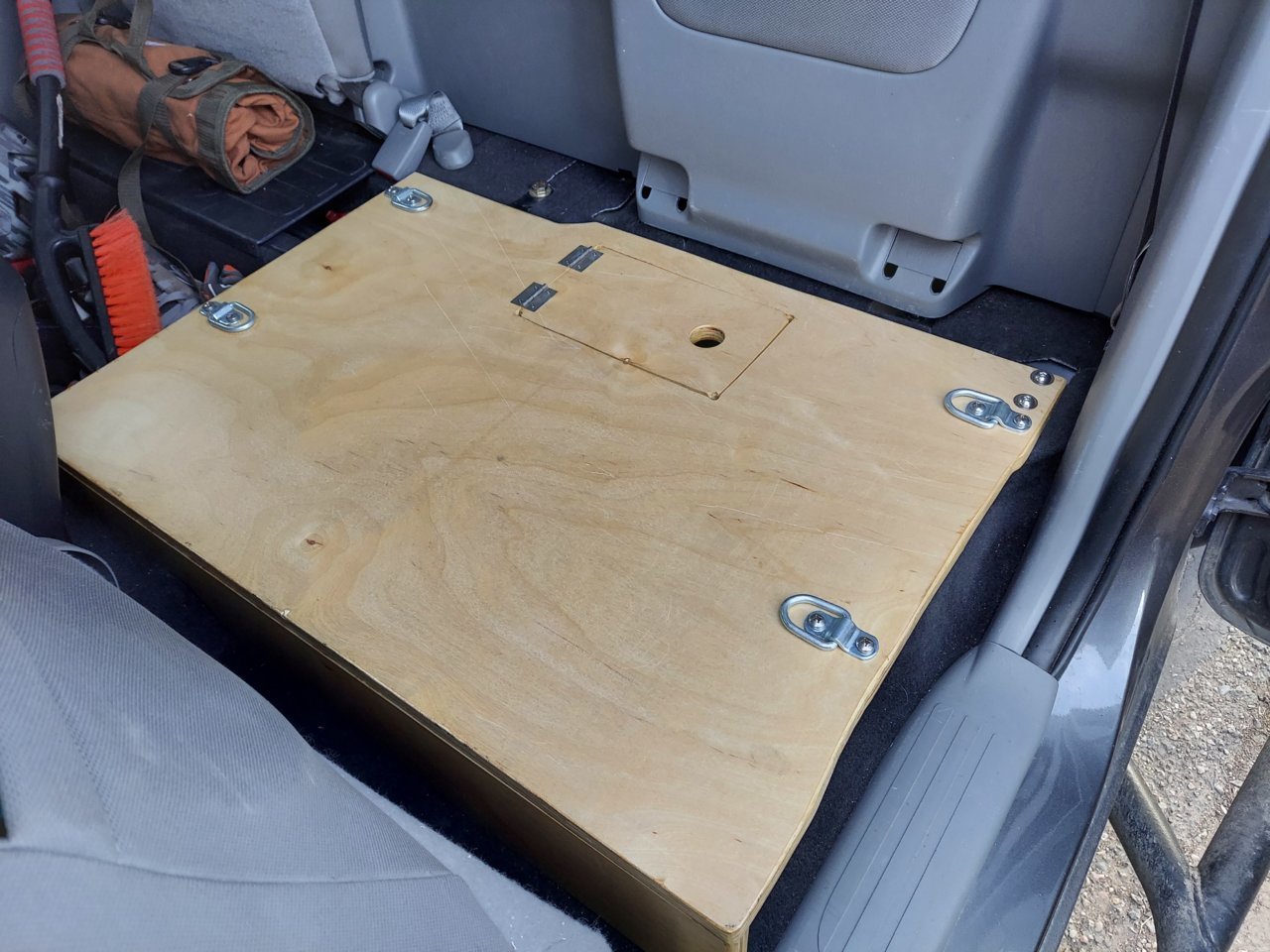

    Back seat fridge platform done.
    And that's probably it for woodworking. :rofl:

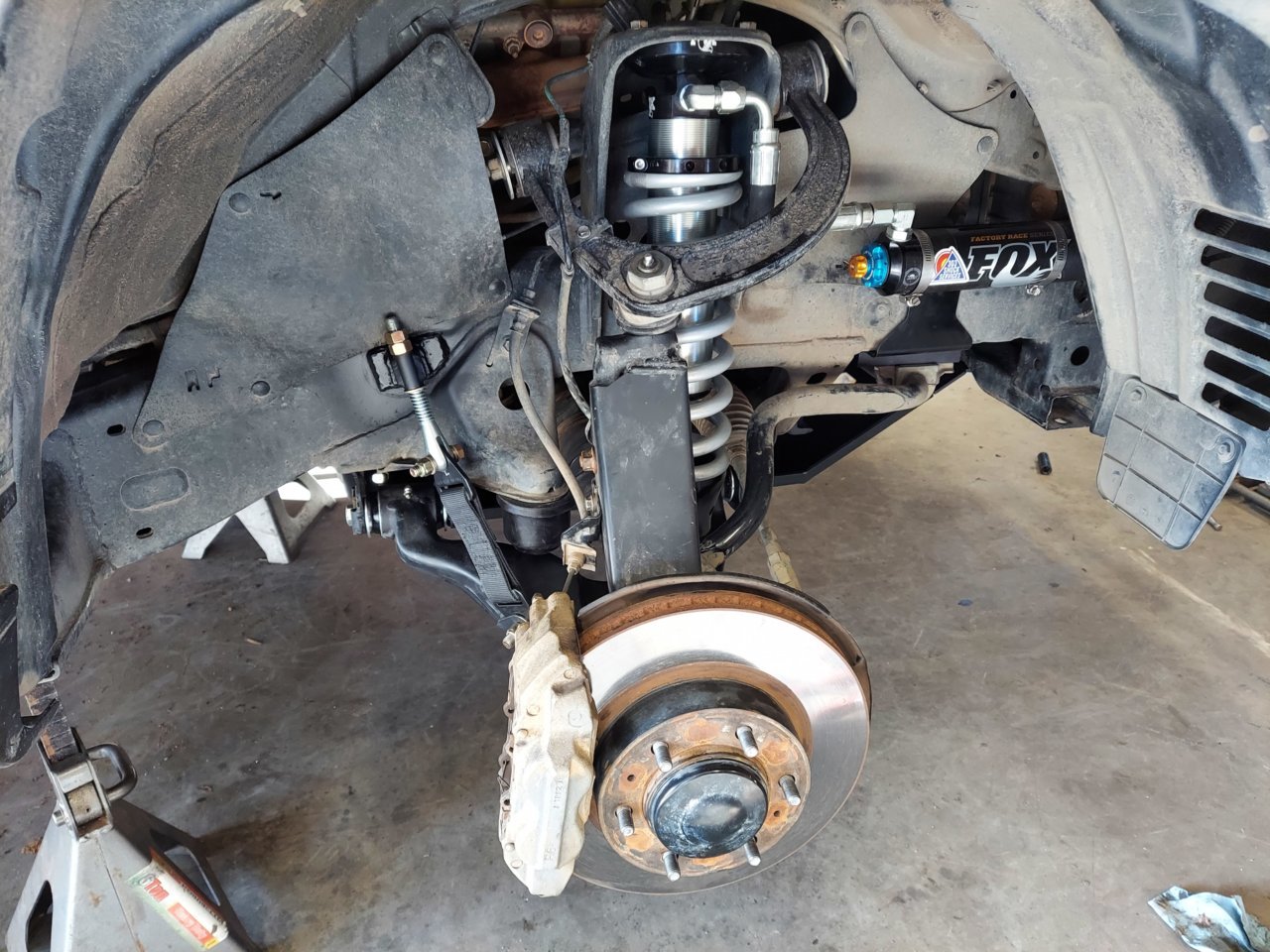

  18. Apr 17, 2021 at 7:12 PM
    #58
    Squeaky Penguin
    Squeaky Penguin [OP] Nothing Ventured, Nothing Gained
    Apr 5, 2012
    #76340
    10,067
    Brett
    Steamboat Springs, Colorado
    '01 4WD, SR5, TRD & '13 TRDOR AC
    Lots of dust and custom dents, Check Build

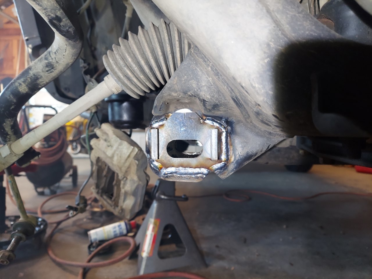

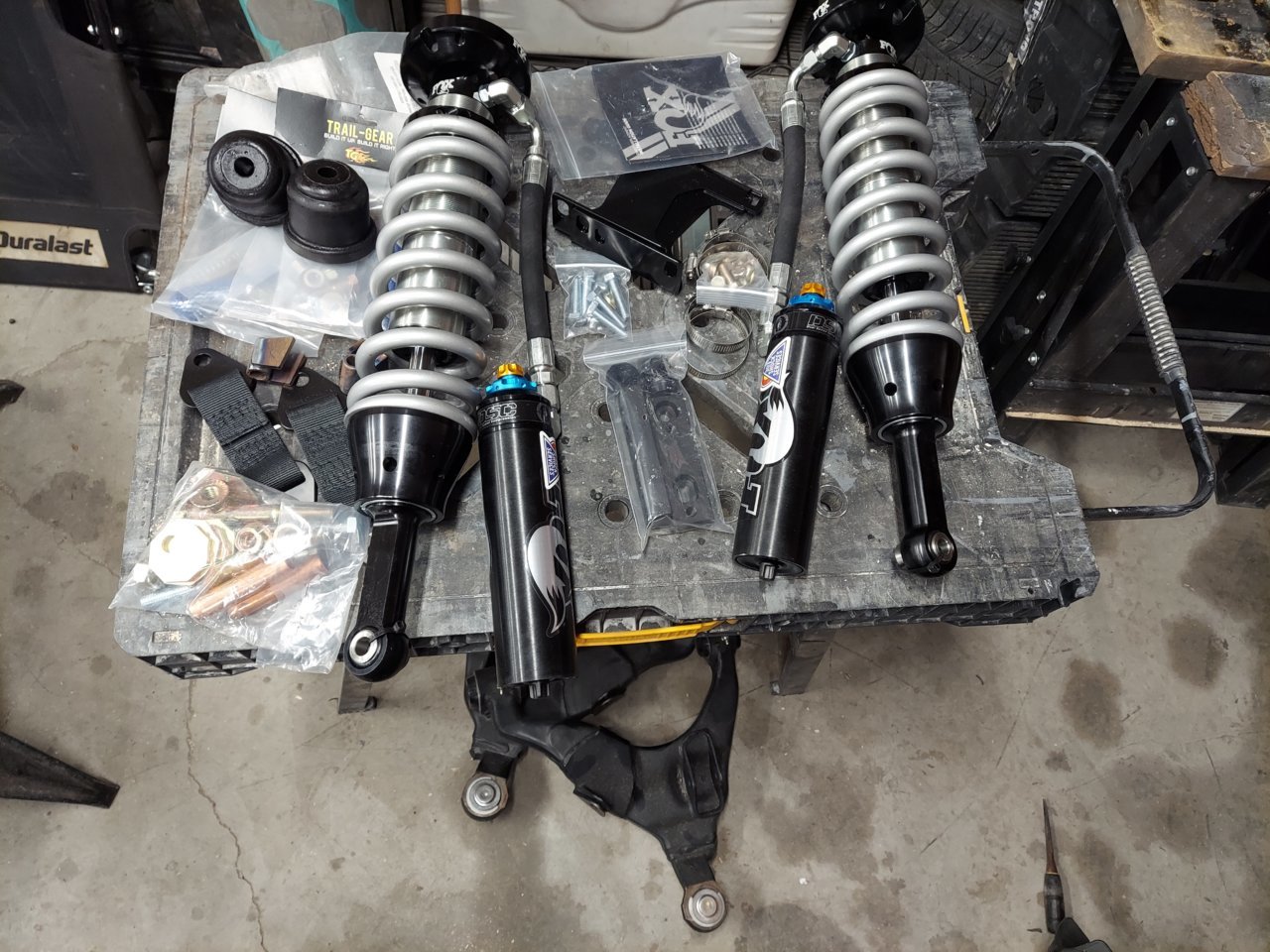

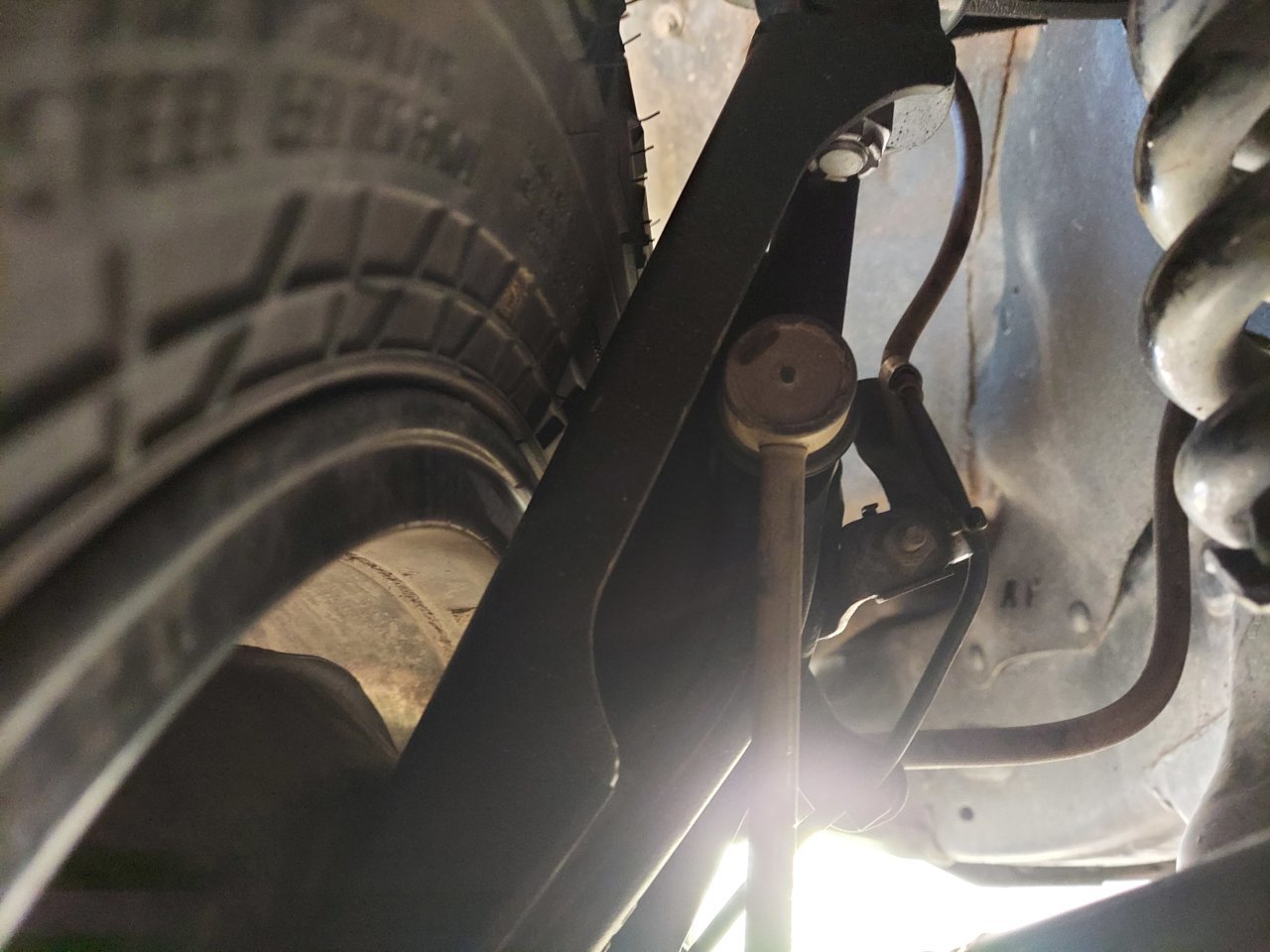

    ECGS bushing, foxes, cam tab gussets, LCAs with whitelines, Bison cams (not impressed), super bumps, limit straps and RCI skid are in.
    It's sitting pretty low currently, I'll probably crank them up a couple turns.
    Can't wait to really test it out next week.

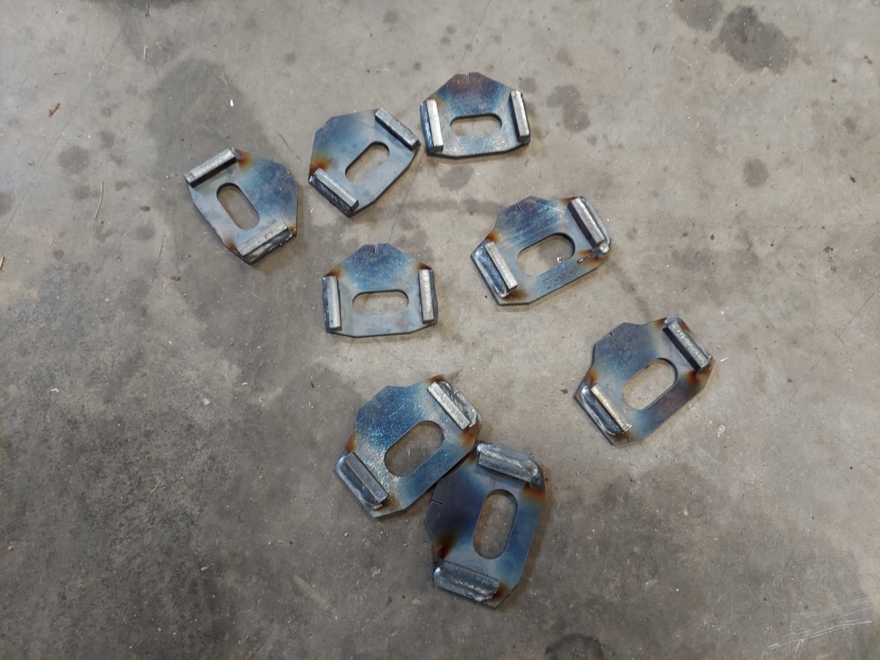

    Bison cam info:
    Bison Offroad alignment Stop Cams -- giveaway
    TLDR: go with the Taco Tabs from Poly.
