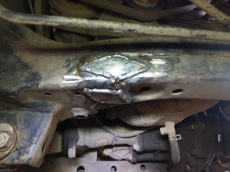

    That was just the initial pass to fill in the notch. Will grind it flat, fill in any low spots, and make some plates to go on the front and bottom faces.
    FWIW, grinding that weld out, and then cutting into with the dremel, indicated there was a very poorly fused gap between those two pieces from the factory.

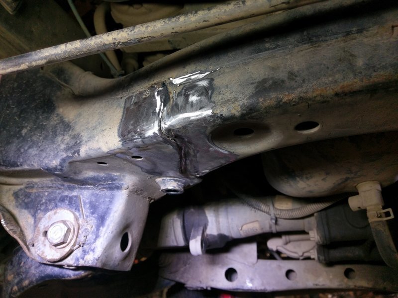

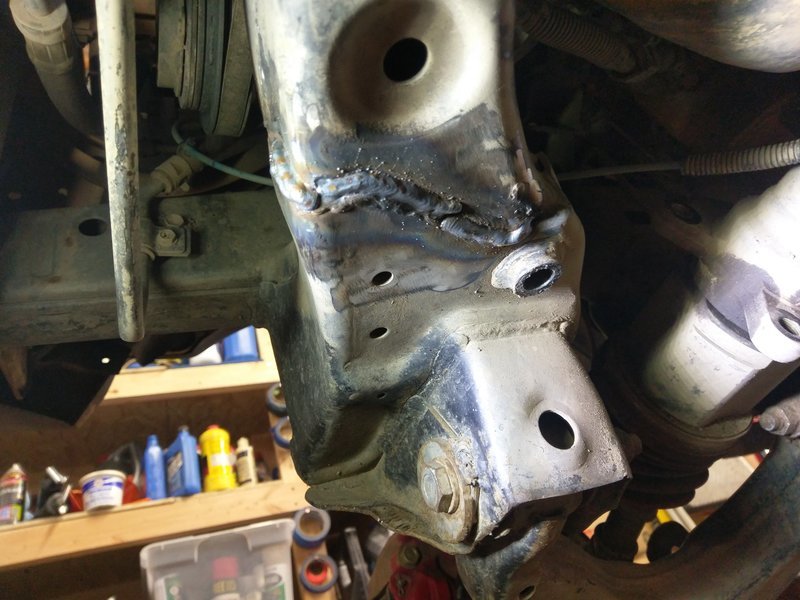

    We'll see if this holds. Laying on the concrete and welding above your head is such a PITA. So more crappy looking welds. Still got the other side to knock out too.

    Welding upside down sucks. High heat and as slow of wire speed as possible helps.

    Yes, yes it is. Overhead welding is quite difficult.

    I would rather do over head then vertical any day. I'm better at over head too. It's just dealing with burns. You get used to it after the first two burns.

    you're crazy. I can slay beads vertical.
    Upside down..still sucks. But i did get better at it.

    Only after a really hard impact. Might be time for a SAS or long travel. Or you could just clean, groove, and re-weld.

    Hmm, I was thinking there would be more stress on that crossmember for crawling and flexing than jumping. Regardless, it should be good to go again now. :thumbsup:

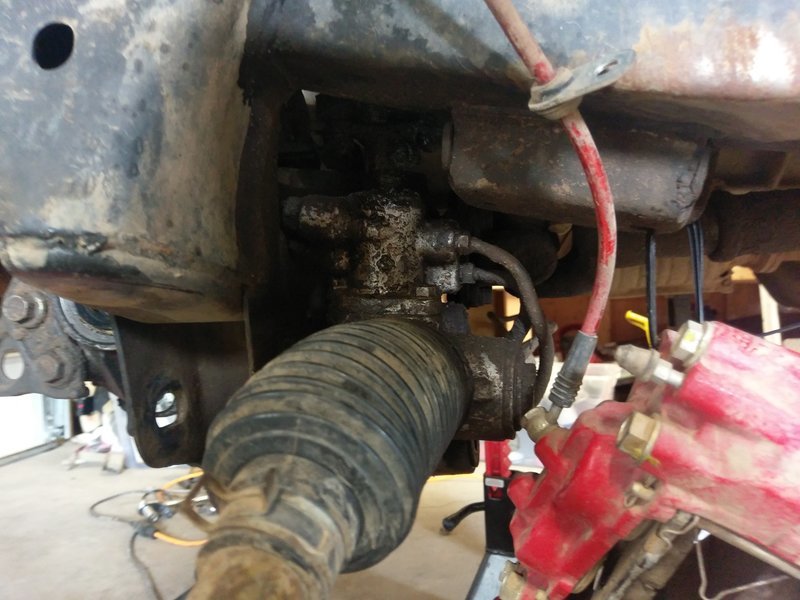

    Also, here's the sad state of affairs when it comes to my Rack Doctor steering rack. Leaking pretty bad out of the input shaft. Between this and the play in the ITREs, and the fact is already mostly removed for the cam tab gussets, I finally got enough motivation to order a new OEM rack.

    Yeah, fuck Rack Doctor, mine had play in it a month after install even before beating on it hard.

    This is my same exact experience with my rack doctor rack. It was disappointing.

    I'm getting pretty tired of working on this pile, mainly because a lot of the work is because of, or redoing, things I've done previously. This will be the third steering rack I've put in. It would have been cheaper and easier to just buy an OEM rack the first time.
