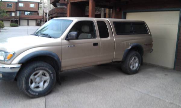

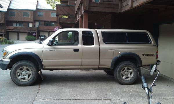

    You guys will laugh, first thing I did was peel off both the window visors things and the tint... So here it is pretty much stock and as I got it.
    Then wheeled it some:

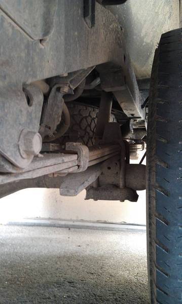

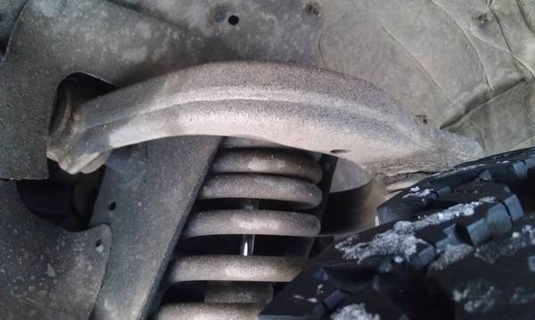

    Decided my stock leaf springs were toast, and TW was a bad influence, and ordered 5100's front and rear, and wheeler's 5 packs.
    Old leaf springs:
    Front 5100's were backordered, so I installed the rear stuff anyways. Can you say rake! Also, note the new dent from the first wheeling trip!

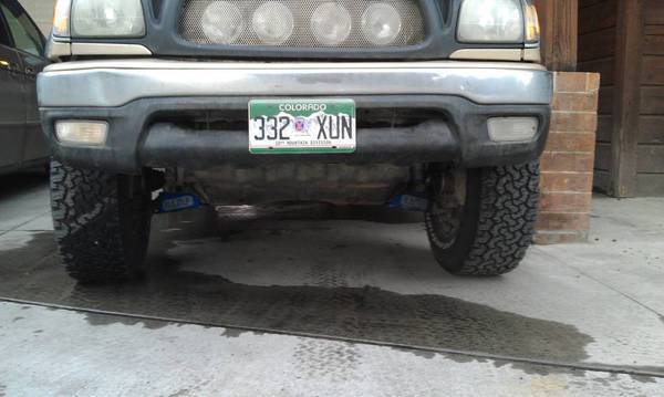

    Alignment shop made a little mistake:

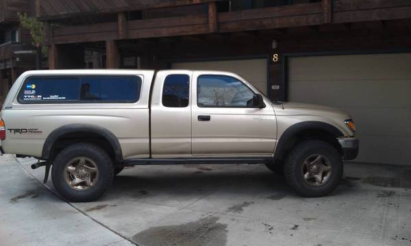

    Got some 265/75/16 BFG TA KO's to fill up the wheel wells a little more. Also, somewhere just before this I tore off one of the front mud flaps, so I took off the other, backs will stay for now.
    Looks pretty all washed and waxed...

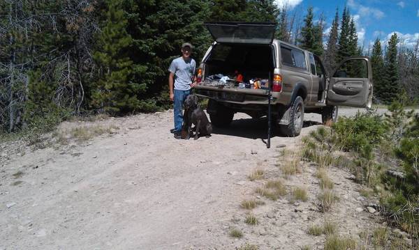

    Grouse hunting:
    Scouting for duck hunting:

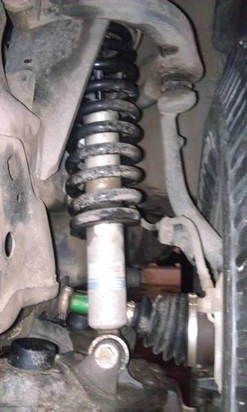

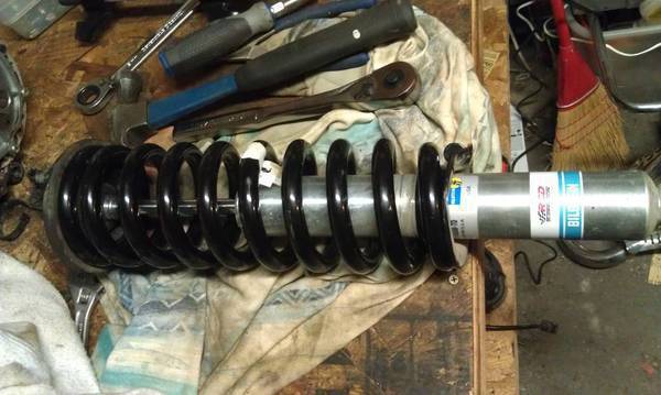

    Got the 881's installed!
    Also took the time to install some Wheeler's bumbstops and sway bar bushings.
    Think the old coils needed replacement:

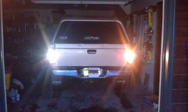

    Made an order from Superbrightleds to get a couple things:

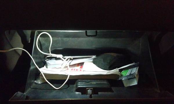

    New reverse bulb comparison
    Found out I was suppose to have a glove box light

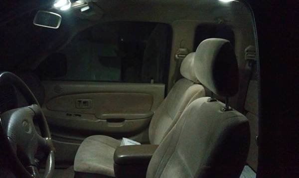

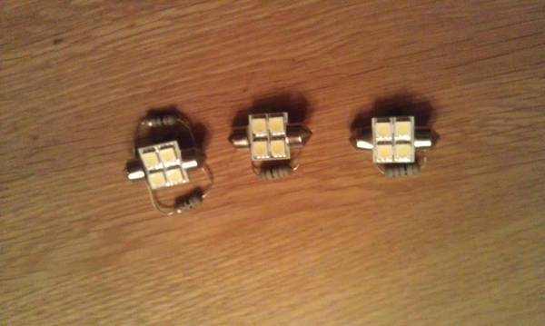

    And also got some really bright dome and map lights. I did have to add some 1w 100ohm resistors to make them work with the key off though.

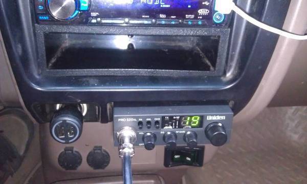

    Copied everyone on here and added an Uniden 520 in the ash tray location.
    Currently have a 3' firestik on a BAMF mount. Was a little surprised I couldn't streach the 18' coax all the way from the back to the center console, so I had to add an adapter and a 3' section of coax to the back of the radio.

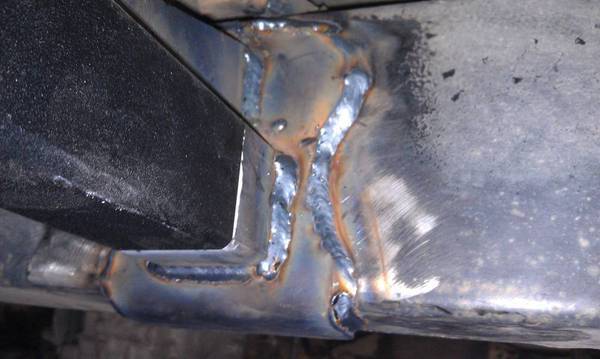

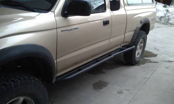

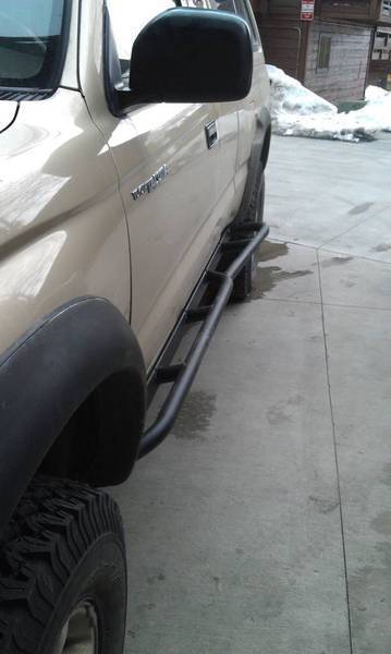

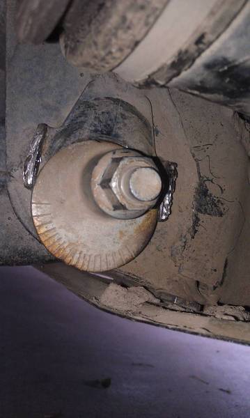

    Managed to find a stretch of decent weather to get the sliders on:
    Nice looking welds:
    And a little test:

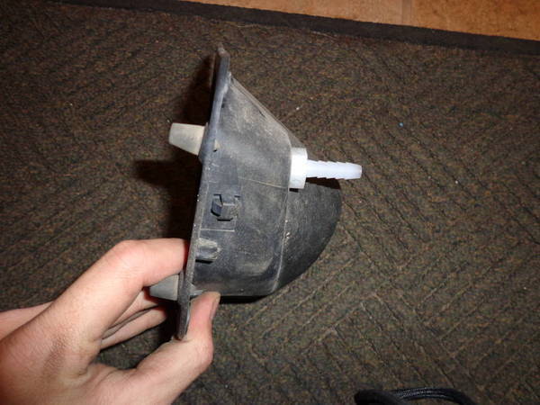

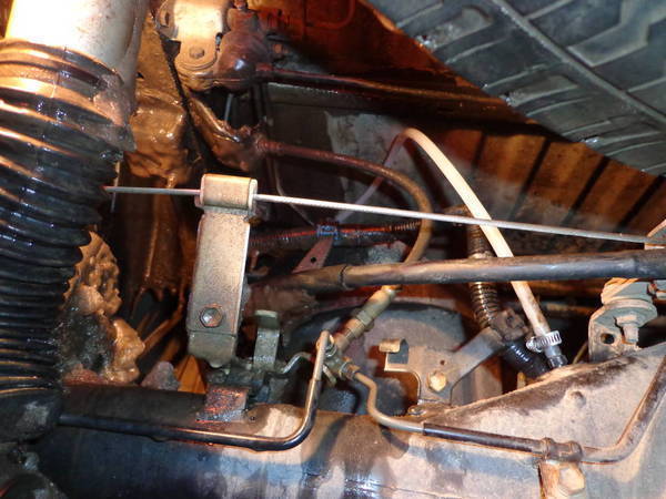

    Installed a rear diff breather extension today. $5 union from Toyota, and $8 worth of stuff from the harware store. I'll be looking into doing the front diff and transfer case next. Was a really easy install except for the ice and dripping water falling on my face....

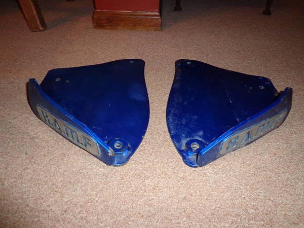

    Also, got a box from JLee:
    His old LCA skids. They'll be a nice splash of color and I should be able to get them on here pretty soon.

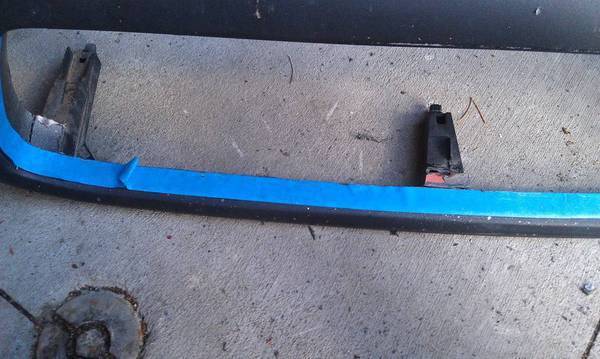

    Painted my stock wheels with Duplicolor Bronze wheel paint. Will give it awhile and decide if I want to keep it or go to graphite. Never really liked black wheels.

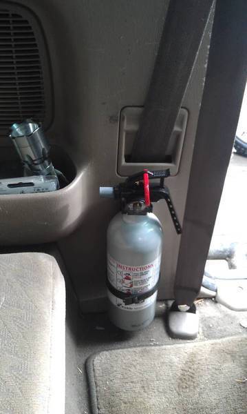

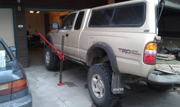

    Added a fire extinguisher behind the drivers seat:

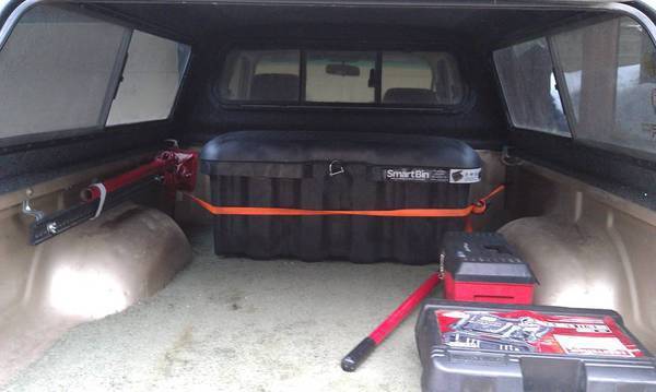

    Also reworked my Hi-Lift mount and picked up a box to keep things organized in the bed.
    Thinking I might pick up another fire extinguisher to mount in the bed just in case.

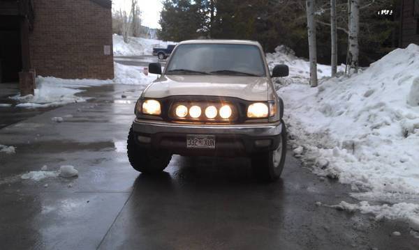

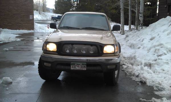

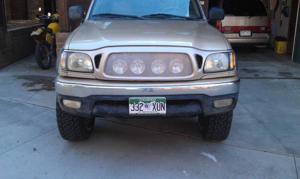

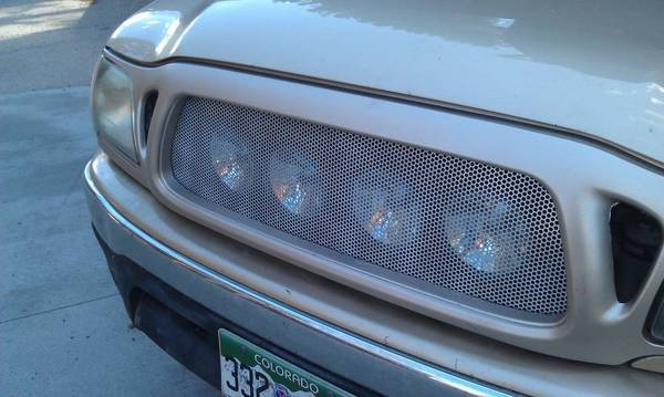

    Redid my grill. Made it only 1" deep to better fit the lights, and colored matched it. I think it looks much better this time around.

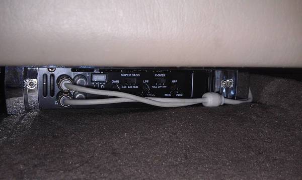

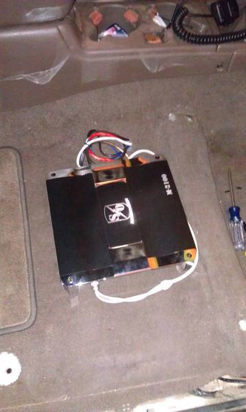

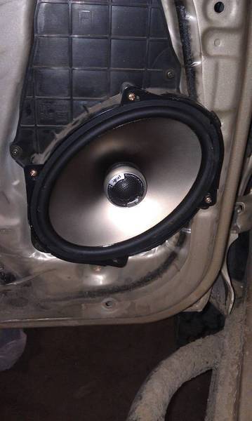

    Did a little audio work the other day. Don't want to do anything too complicated, so I added some Polk DB571's to the front door, run off of a Sound Ordnance M2100 amp under the passanger seat. So far I'm loving the sound.
    I'm going to give it awhile before I decide if I want to do anything else. Thinking about some Polk tweeters to replace the factory door ones, but dont't know yet.

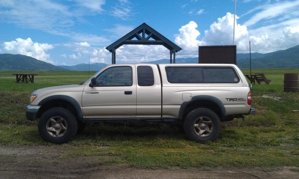

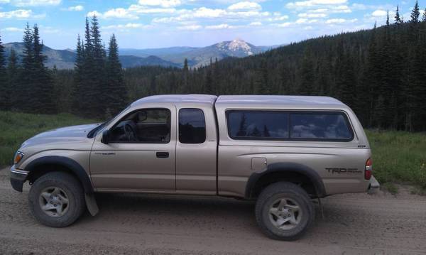

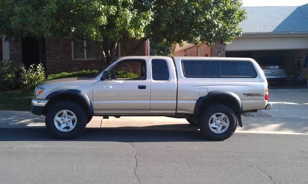

    I've really enjoy the 881's. Much better ride quality than the stock TRD coils, and an inch more of lift of the lowest setting, as opposed to the middle. It seems like they didn't settle too much, but I never did take any measurements.
    Here's my stance as of yesterday.
    I've been somewhat tempted to bump the 5100's up to the middle setting, but I'm already perfectly level as is, definetly don't want a bro lean. I've also heard mixed opinions on preloading OME coils. I ment to talk to White Toy Taco about his 881s on the middle setting when I wheeled with him in Moab. Might be worth asking him to if you're wanting a little more lift.
    My original intention was not really to lift, but now I'm wanting a little more rake. Between the topper and the 100+ pounds of crap in my bin in the bed I'm pushing the Wheeler's 5 packs. Might be looking into an AAL and/or new shackles.

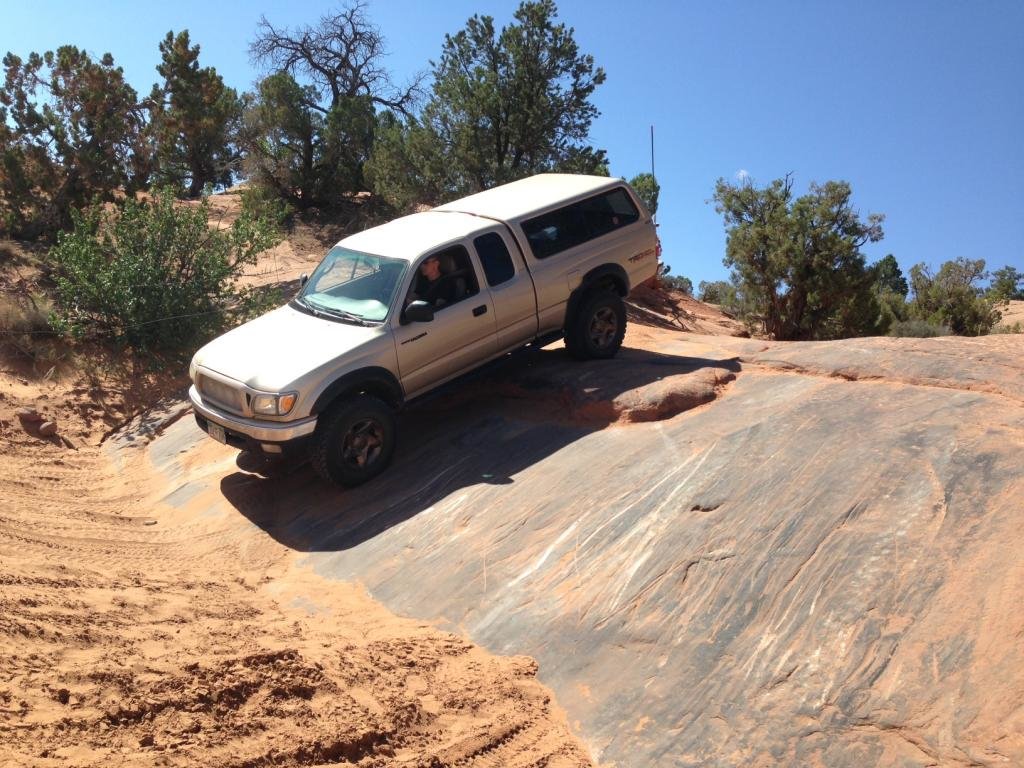

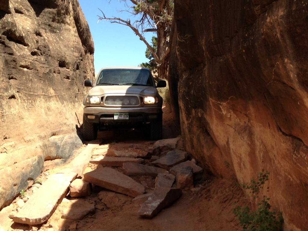

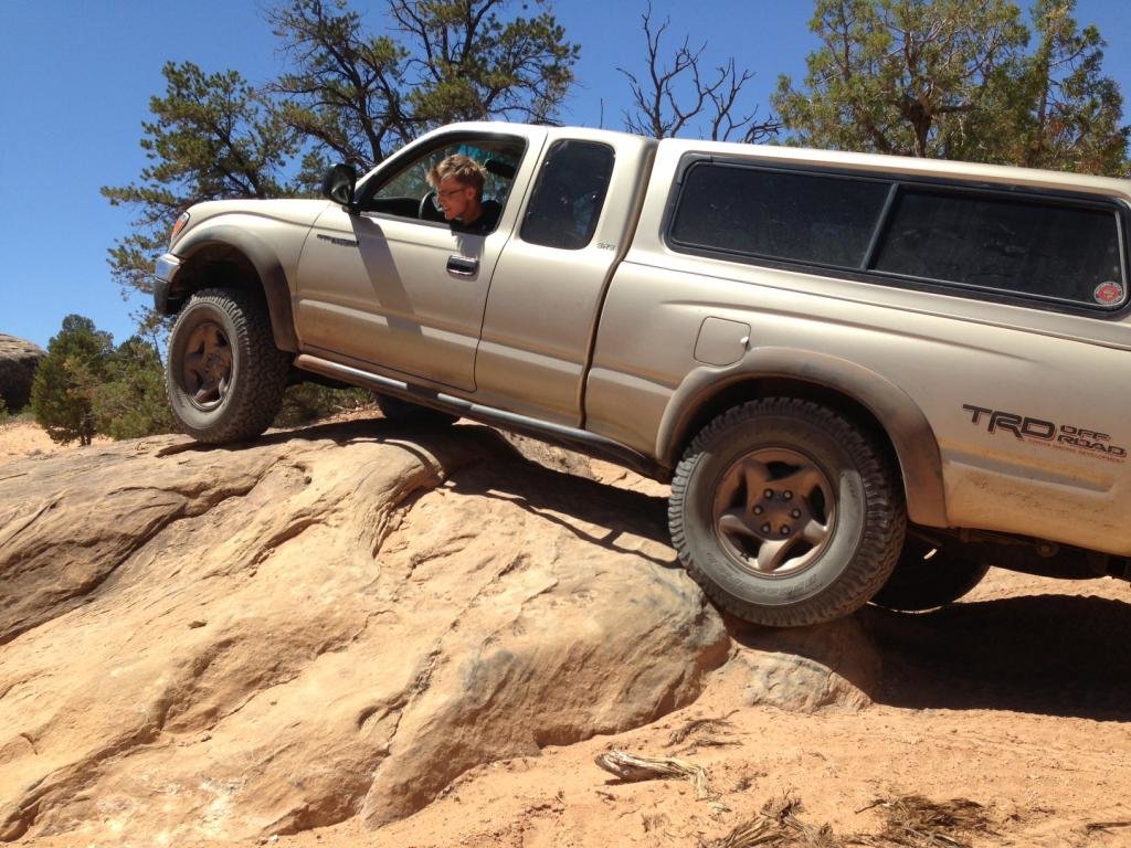

    I guess I should update this some more :eek:

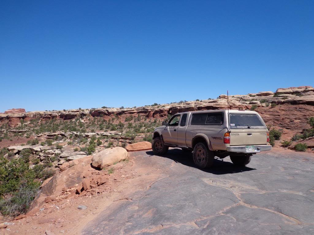

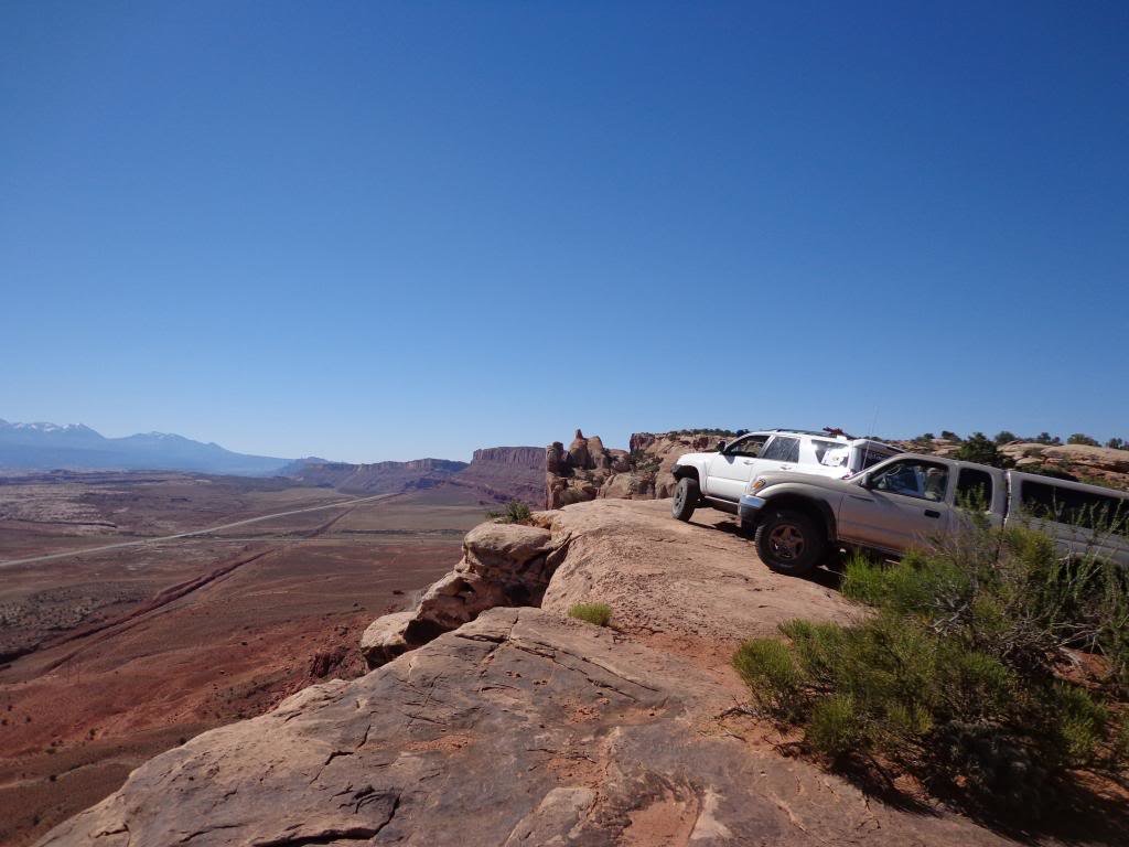

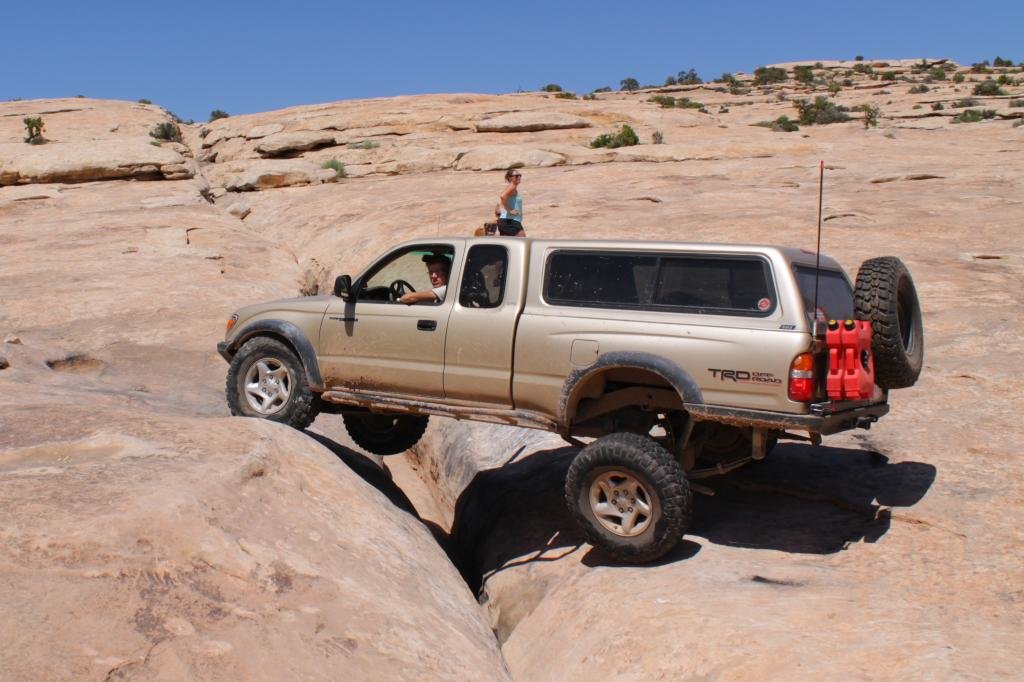

    A few pics from Moab:
