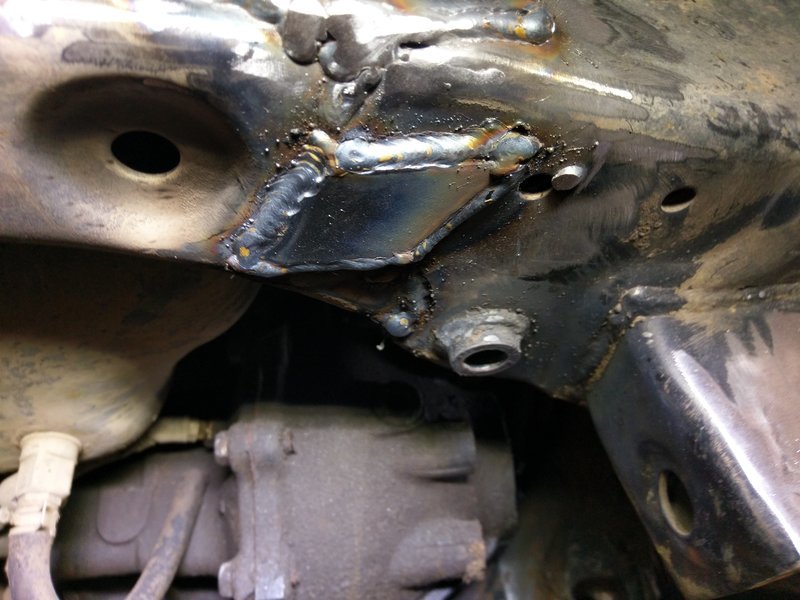

    Not enough room for a grinder with a flap disk. Only using the dremel to cut through the welds I put behind the stock tabs. Also using a spot weld drill bit to drill out the factory spot welds, and then a 60grit rollock on a die grinder to clean it up.
    No, didn't put anything behind them when I welded them.

    Very slowly improving.
    Now I can actually start working on Cam tab gussets and coil bucket gussets.

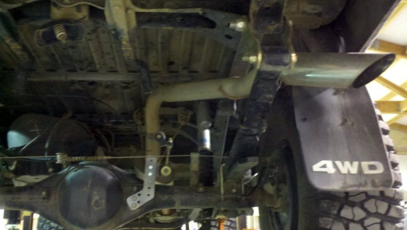

    Exhaust tube. There is a way. I seen it done. Let me find it for you. Maybe your motivated enough to try it.

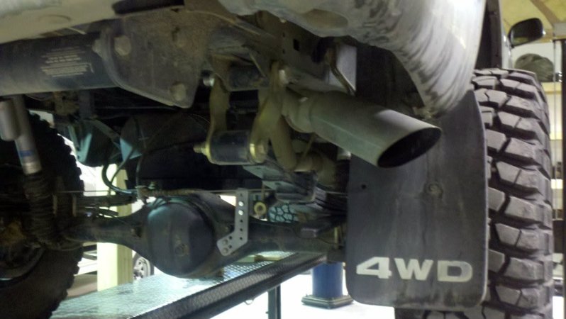

    whatever you do, go past the axle.
    piping it out the side is tricky but do able at a good exhaust place.
    Sorry, i don't have good photos like normal of this.

    That looks complicated. Probably just go straight back being I don't have anything under in the bed in the way.
    Certainly not going to dump before the axle.

    Yea, Norris is my exhaust guy. Bent Igors sliders too. He is a great guy. Went to school with his boys. He knows his shit. I had a lift and he knew id be wheeling and the rest was all him. I didn't tell him anything not even what muffler to use. Just fix it, make it sound good and look good.
