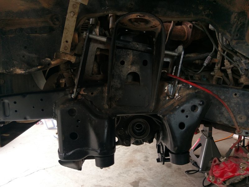

    Cam tab gussets, coil bucket gussets, daystar bumps, and new skid mounting brackets.

    Nice work Brett.

    Agreed. Nice work!
    I was talking with Ray about those bumps and I was curious if they threaded into the LCA or if you had to run them on the frame. Let me know how you like them.
    Now that I look at what you did, I need to do all of those things, except the skid stuff. Are your spindles already gusseted?

    Those bumps screw into the frame not the LCA.
    Be curious to see if you like those Daystars vs the Superbump/OEM combo.

    x2 Report back how you like those bumps

    I'm ordering some of the Daystars right now.

    Those Daystar bumps are awesome. They dealt with the pounding of my long travel for some time. I'm glad I have them.

    Had to drill and tap the frame. The bumps have a 3/8" stud on them.
    Yes spindles are already gusseted.
    Will report back on the bumps whenever I finally get a chance to drive this pile again.
