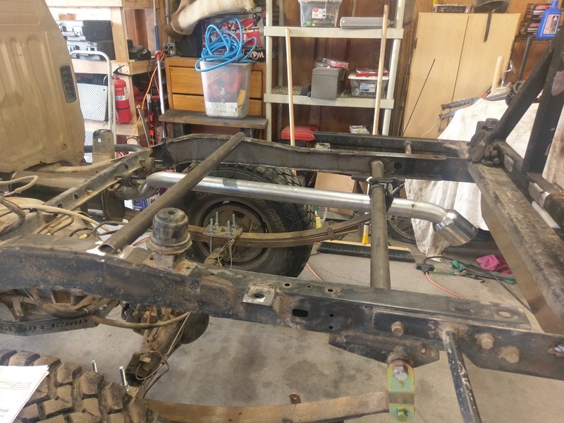

    Steering rack due in tomorrow. Exhaust is tacked up and just needs a hanger.
    And my shocks shipped. Going to try to wrap this thing up next weekend if everything goes well.

    May copy your shock mounting idea with notching the tube and welding directly to the frame...seems like it would be more solid that way with a piece of plate welded to the inside of the frame to weld the rest if yhe tube to that plate. Watching to see of the tube will clear the bed where its at. How vertical is that tube in comparison to your axle?

    It's a little optimistic, but you never know.
    Mine will be welded to the top of the frame and the frame boxing plates. FWIW, I ran my old setup with a small piece of plate welded to the inside of the frame for a couple years and it worked fine. Both would be best if you're not boxing the frame.
    This picture shows where it is in relation to the axle:
    It's only tacked on, may move it around depending on how the shocks end up.

    I'm just thinking I might not be able to get the tube high enough to accomadate my 10" shocks i have. I'm just gonna have to measure didn't scenarios I auve in my head. But I really like your idea.

    There's about an inch gap between the frame and the bed, so that crossmember is as high as you can get the mounts. Should fit....
    Will hang the lower mounts as low as needed to keep the shocks how I want them.

    Yea not like going a bit below the axle will cause that much harm.
    With 10s vertical, you'll be at least 1-1.5'' below the axle would be my guess.

    That's what I wanted to do from the start just couldnt think of the most effective way to get the tube that far up. That way I have a stationary upper and I can adjust the lower mounts as needed like you just stated. School has handed me no free time so I shall watch and wait for you to complete yours :cool:

    Yes. As close to the frame as possible.
    Rule 1 of shock mounting I should have learned the first time: get the upper mount as high as possible.
