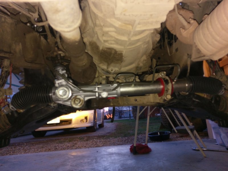

    OEM steering rack installed with fresh poly bushings.
    Front is done after an alignment.

    Nice. Why did you change. Did you take out an OE rack?
    I think this mod may be in my future.

    This is the third rack I've installed on my truck. It's replacing a leaking Rack Doctor remain with crappy ITREs. Don't waste your time with anything other than OEM for the steering rack.

    That's right. I recall now reading your comments about the rack from Rack Doctor.
    Is the one you just installed a CVJ OE reman or is it a brand new one from Toyota? Looks brand new.

    That's a brand new rack from Toyota. Found it for about $550. Price doesn't seem bad if you look at the price for the OEM ITREs by themselves.

    Wow, if it comes with ITREs for that price, that is a pretty go deal. Was that from Camelback Toyota?

    Yes it comes with the ITREs. Got it from Titus Will with the discount code they advertise on here, cheapest I could find. Although their customer service left a lot to be desired. Will not order from them again.
