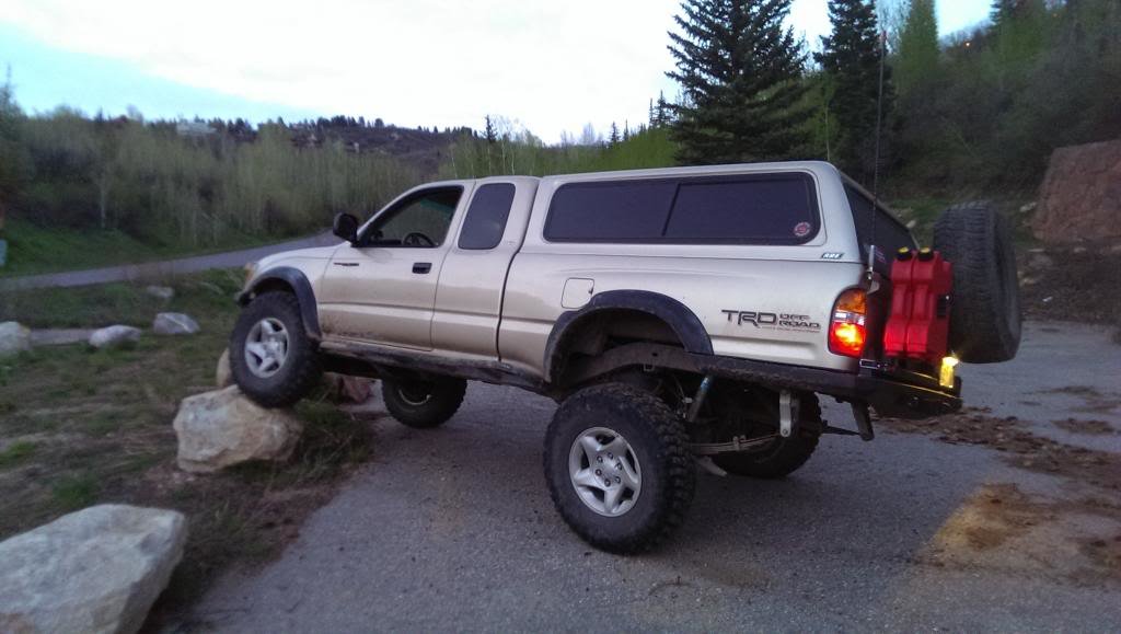

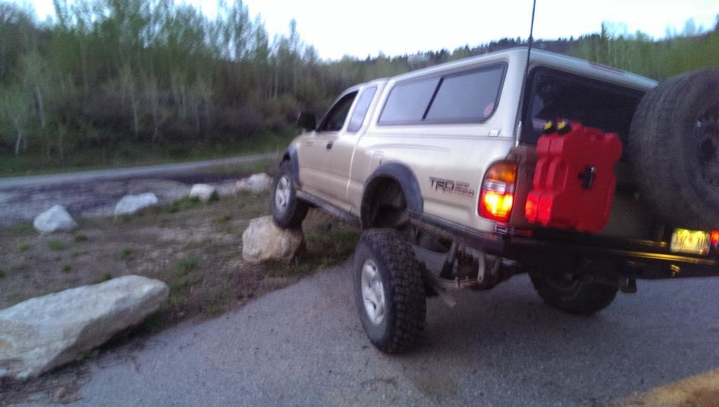

  6. May 17, 2014 at 7:00 PM
    #206
    Squeaky Penguin
    Squeaky Penguin [OP] Nothing Ventured, Nothing Gained
    Apr 5, 2012
    #76340
    10,100
    Brett
    Steamboat Springs, Colorado
    '01 4WD, SR5, TRD & '13 TRDOR AC
    Lots of dust and custom dents, Check Build

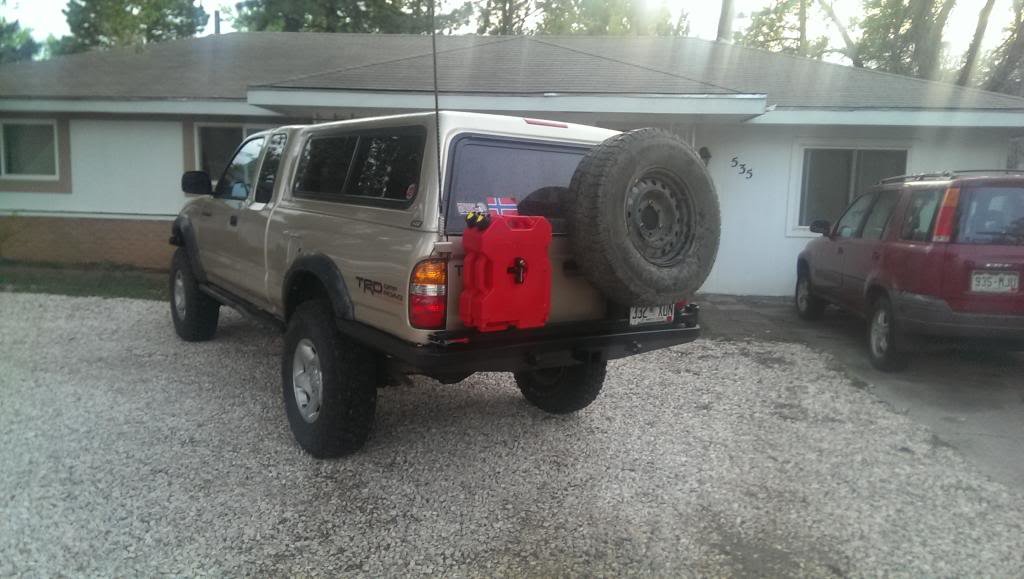

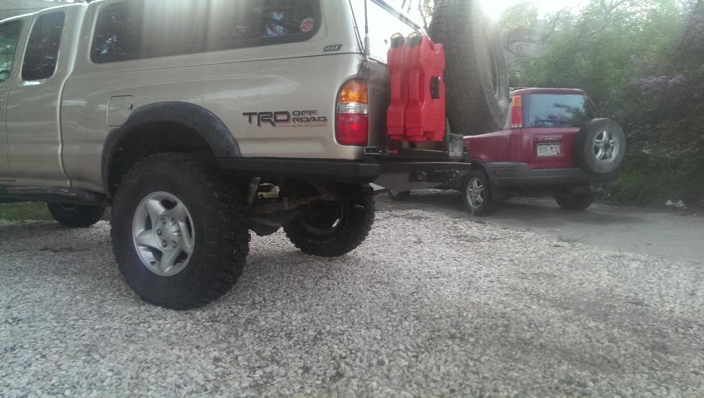

    Got my rear bumper installed. Alex took some of his fancy pics when we finished up. Should look better than these.
    Slashaar likes this.

    I have a swing out on the scout that I made that uses just a bolt for the pivot but its double shear. I see lots of single shear spindle assemblies like yours and have not seen one break. Its a popular design on jeeps too.

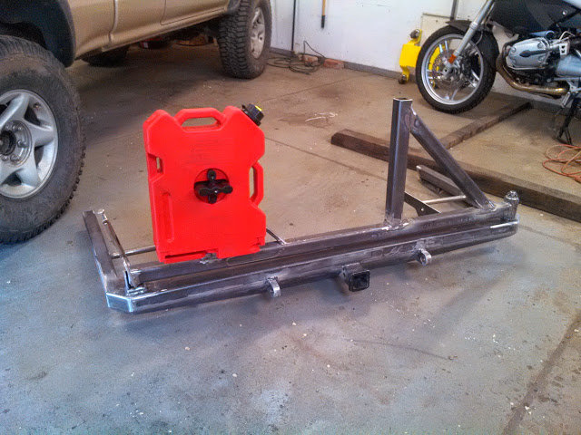

  9. May 18, 2014 at 7:36 PM
    #209
    Squeaky Penguin
    Apr 5, 2012
    #76340
    10,100
    Brett
    I don't think it's going anywhere. Trying to remember the company that makes the spindle kit. It's not just bolted through, but the bottom if fully welded to the main part of the bumper, and then he added that little side support.
    I guess we'll see though. But isn't that how most of them are?
  10. May 18, 2014 at 7:41 PM
    #210
    teamhypoxia
    teamhypoxia MichelinMan
    Aug 21, 2012
    #85247
    9,713
    Colorado
    '12 DCSB TRD OR
    Looking at that picture, if you didn't know how it was built you might think that the nut at the top was the only attachment. Obviously that probably wouldn't withstand being opened even one time.
    Maybe that's what he was thinking? :confused:

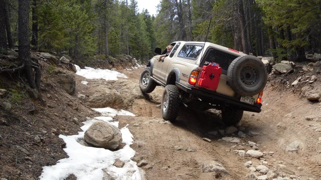

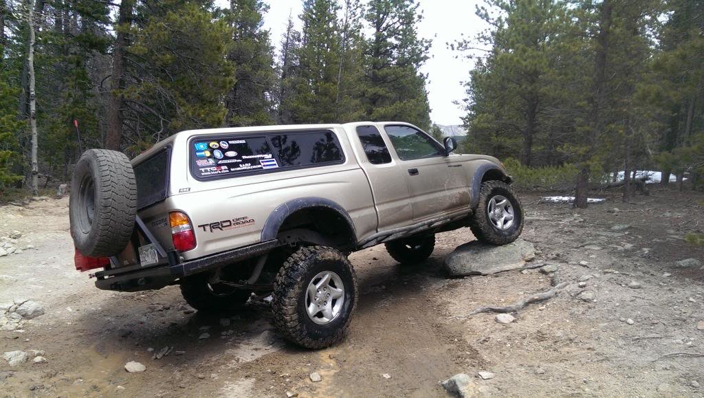

    And a few pics from a little wheeling trip yesterday. Me and my buddy Leo (Night Eagle) went out to Bunce School Road.

    Hell yeah, nice addition. That spare though . . . :facepalm:

    Working on it....
    Trying to find a matching wheel has been tougher than I thought. No one responded in the Colorado trading post, Yota Jim didn't have one, starting a thread in the wheel/tire marketplace, and have one lead on getting one shipped here. Don't know if that'll happen before Moab.
    And will be buying a another 255/85 KM2 this week.
  14. May 19, 2014 at 10:54 AM

    Haha. I think it would be good just to have the same size tire, a matching wheel is just a bonus.
  15. May 19, 2014 at 12:58 PM
    #215
    Box Rocket
    Box Rocket Well-Known Member
    Mar 1, 2010
    #32389
    7,184
    Adam
    Syracuse, Utah
    1995 FZJ80 Land Cruiser
    3xLocked, lifted, well used
    I don't see any problem with this setup, actually it is a nice solution to make the swingout double shear. Remember most people usually just run single shear with the spindle. My guess is the spindle is fully welded at the top of the bumper and runs through and is also welded at the bottom of the bumper so there isn't just one attachment taking all the force on the spindle. That would still be single shear but this setup with the double shear just adds some support. Should be trouble free from what I can see. Nicely done.

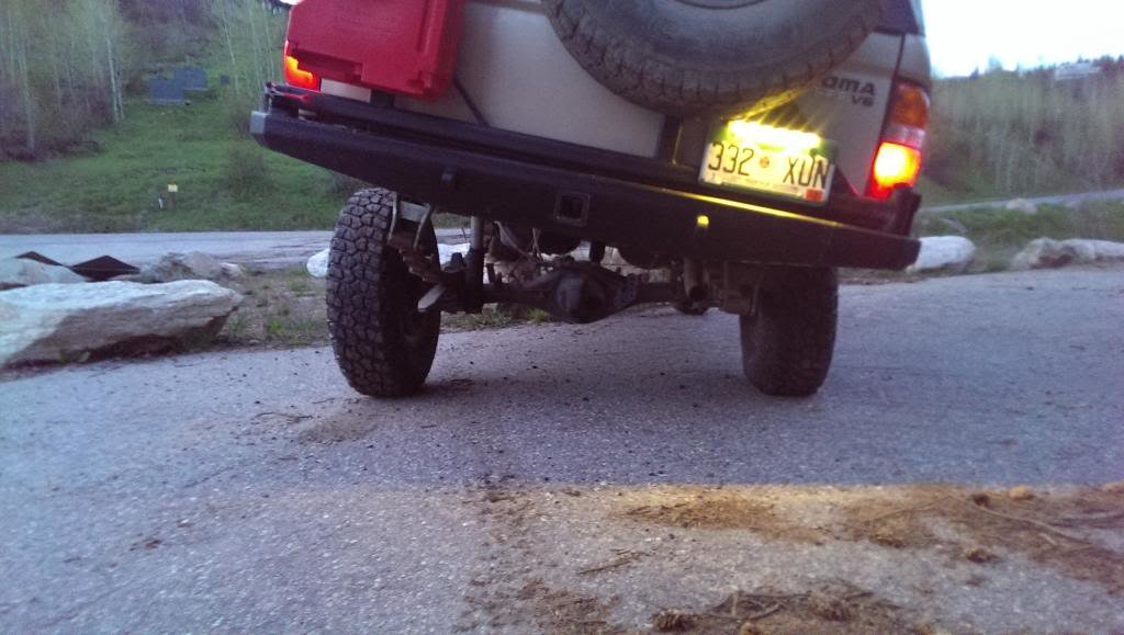

  16. May 19, 2014 at 5:12 PM
    #216
    Squeaky Penguin
    Apr 5, 2012
    #76340
    10,100
    Brett
    Not a fan of the 265/75 Big O AT? :D
    I got two on craigslist for $60 after I got my 265/75s.
    But yeah, it won't be around for long.
    :thumbsup:

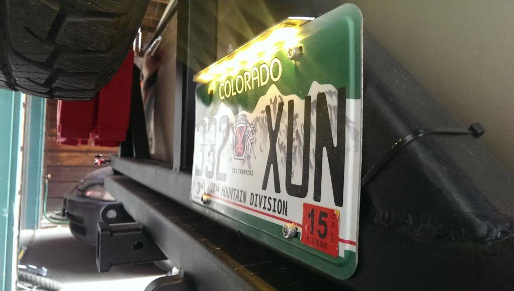

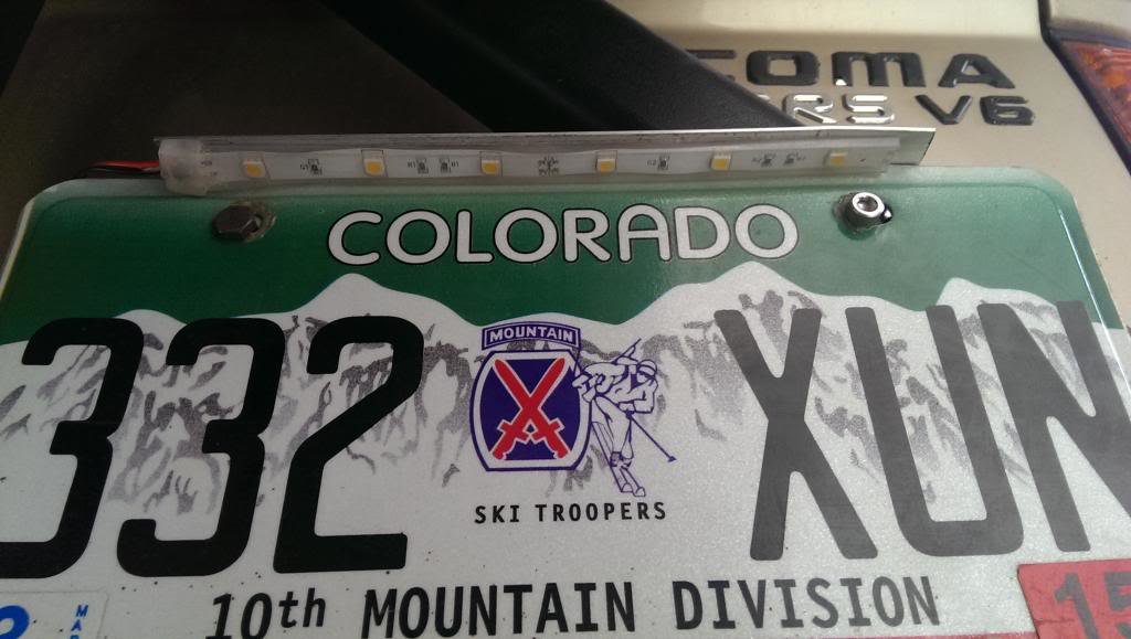

    Also, mounted up some LED tape light for a liscense plate light.
    Nice and bright:

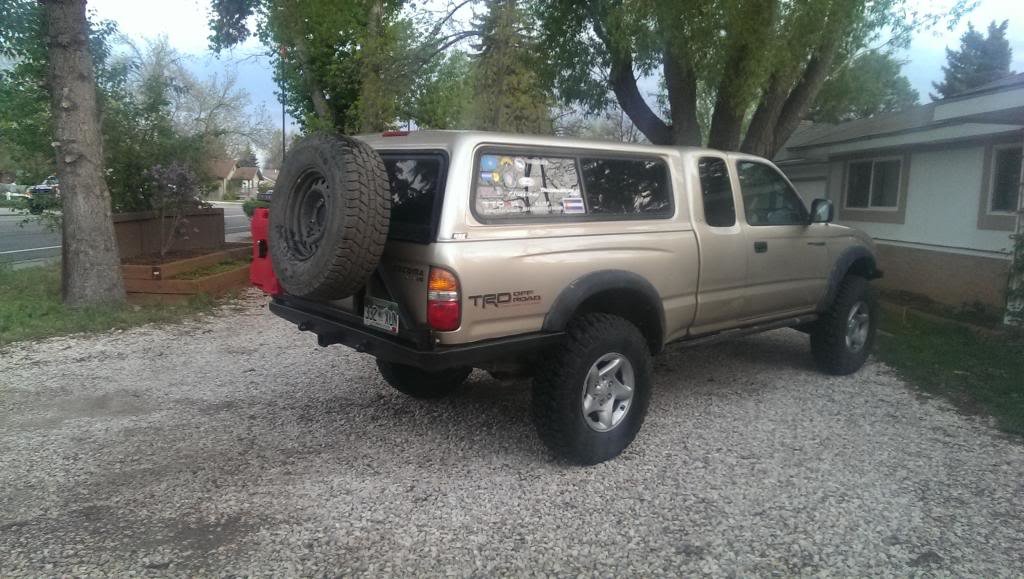

  17. May 19, 2014 at 7:45 PM
    #217
    Squeaky Penguin
    Apr 5, 2012
    #76340
    10,100
    Brett

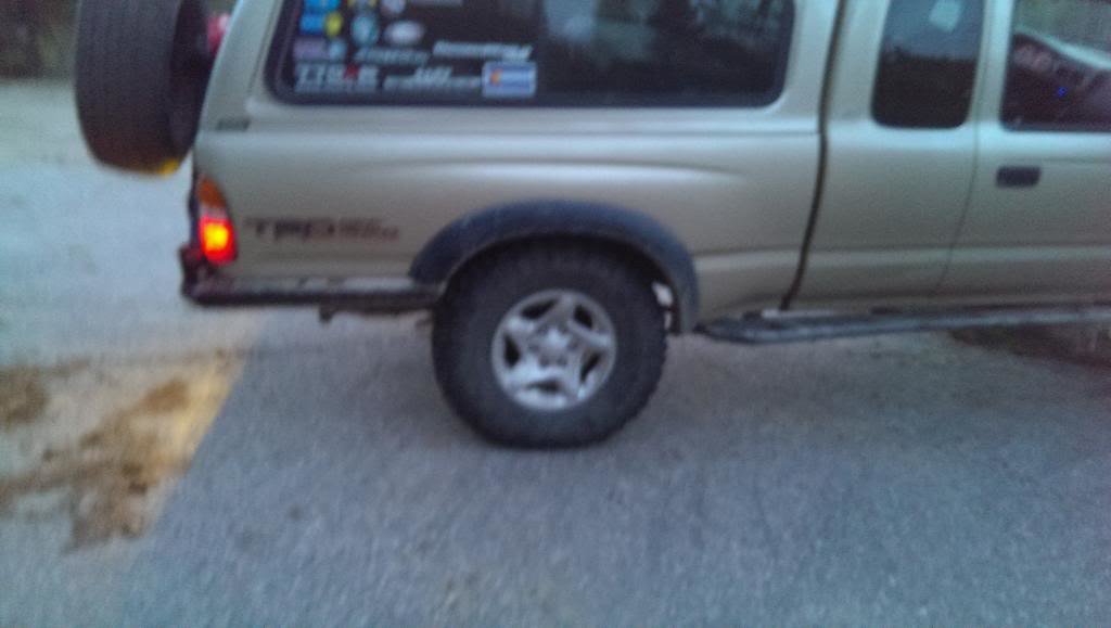

    Installed my 2" lift shackles and 10" 5125s courtesy of Jace.
    Was getting dark, but grabbed a couple pics on my favoirte poser rock close to my house.
