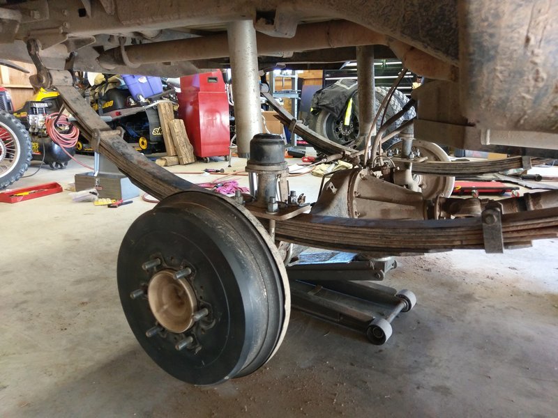

    Wasn't happy with the weight capacity and uptravel loaded down on my last trip. Tossed another leaf in the pack today. Should get me closer to 50/50 up/down travel.

    just curious, how much did you account for your rear superbumps compressed height? I could never get a real answer, so I went with a half inch. I was just worried about bottoming out my rear shocks, so they are set at 5". 4.5" bump being the minimum. But if I knew how much they compressed, I could dial in the bumps better, and get a little more uptravel out of it. Thanks for your time.

    Do you overextend the shocks with your setup now? Limit straps?
    In the process of re-doing my lower mounts now... getting about 3" up travel and 7" down... with my 10" shock I'm gonna have it strapped with 9.5" shaft showing at vertical droop leaving .5" shaft at full bump.
    This was almost vertical with like 2" below the rear end

    They compress way more than that. 1.5" or more.
    Don't know if you read all the stuff I did earlier this year, but my leafs are only good for just over 9" of travel. No need for staps as the Springs limit my downtravel. Have about 5" of shaft showing now, but think my Springs might settle a bit after the changes.
    Trick is to get the upper mount as high as possible. I did end up having to hammer the bed up just a bit for the ends of the shocks.

    Yea I remember vaguely reading it before but these threads move so fast it's hard. My upper mount is about .25" from the bed... my last shocks were angled like / \ but I'll be using more of the shock with a more vertical setup hopefully creating a better ride. Also getting them revalved by my shock dude
