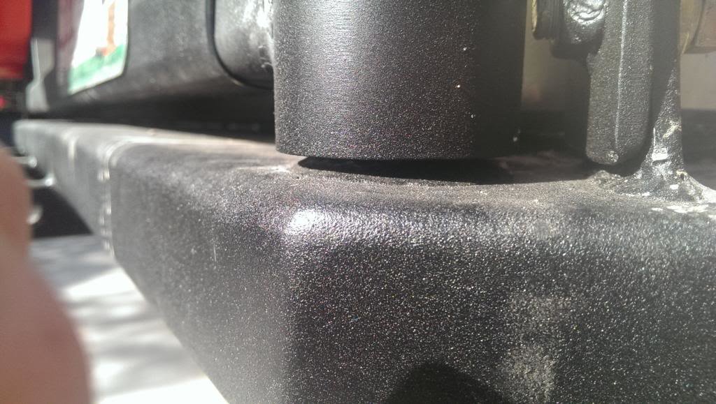

    Spindle goes completely through the main rectangular structure of the bumper, and is welded on both sides.

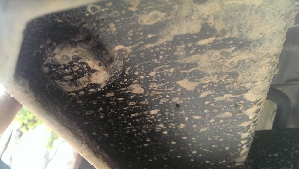

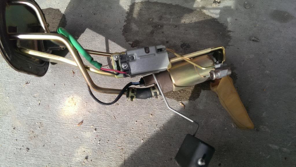

    Pulled the tank, and.....
    Well Shit!! :censored:
    The tank off the older model taco that Yoda Jim gave me has a few differences. It may work, but at this point I'm uncomfortable putting it back in.
    Here's the old sending unit.
    So, looks like I'm going to try and bent it back, and see how much of the dent I can pop out of the tank.

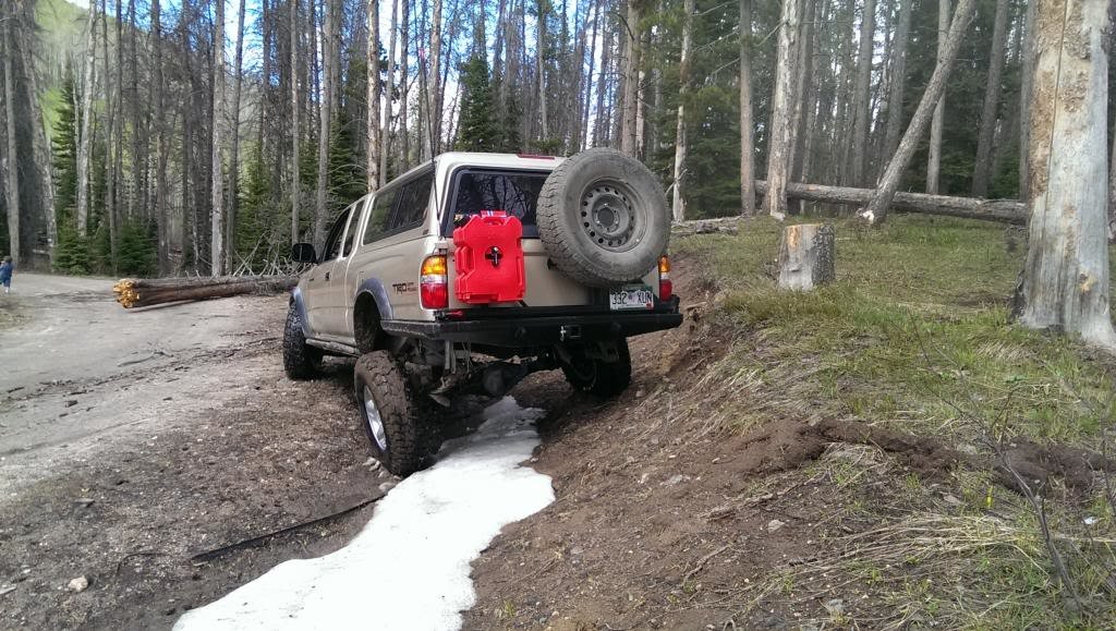

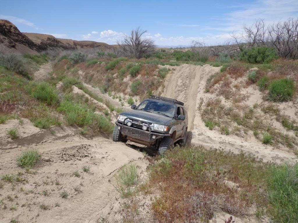

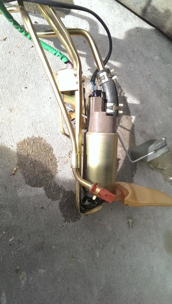

    Managed to get quite a bit of the dent out of the old tank, straightened out the fuel pump mount, and reinstalled everything. Everything seems good except now the fuel gauge is stuck just below a quarter tank. At least now I know how easy it is to drop the tank, only problem is I filled it up completely. Will be dropping in on Monday probably and see what it's hitting. Actually there's only one thing it could be hitting, and that's the plastic baffle thing, so it really should be an easy fix. I do know for sure that the fuel pump is now straight down and right at the bottom of the tank.
    Did burn some gas today though doing a real test of the new rear suspension. Pretty easy forrest service road, but my chainsaw sure got a workout. Some snow bashing, a few little rocks, and tons of deadfall. Got tired of cutting about a dozen trees in and turned around, but not before I got some more poser shots:

    See that big tree in the second picture on the last post? It was bigger than I wanted to cut, and it was in the way, so I moved it :D
    And here's me cutting some deadfall, this is what a lot of the trail looked like:

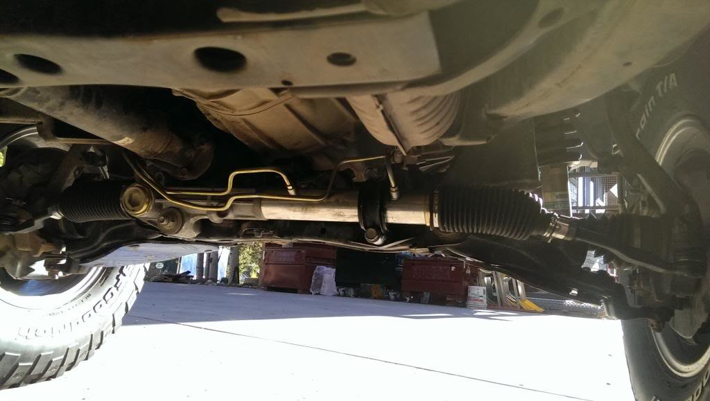

    Finally got the steering rack installed:
    Why is it that these jobs always take way longer than I guess? Took me like 45 minutes at most to remove my skids and all the steering rack hardware. And then another 45 to get the damn steering shaft off. The write up I read said "just pull the rack down and if should pull off" or something like that. Well, that didn't work for me. Lots of swearing, PB Blaster, a bernzomatic, a hammer, a bigger hammer, and finally an air chisel to get it off.
    After that was when I realized I didn't have lock nuts for the OTREs. The new rack didn't come with them, nor did the OTRE. I found one in with my trail spare ITRE which I stole, then proceeded to pull one off my old rack. Only problem with that is how stuck everything was. Took a ton of torque to break the nut free, and then was never able to loosen the OTRE from the ITRE. I have no clue how they aligned it last time... Ended up cutting the old OTRE to get the nut off.
    Alignment was close enough to drive it around. I think I got everything I need for Moab, heading out tomorrow evening to camp at the Kokopelli trailhead.

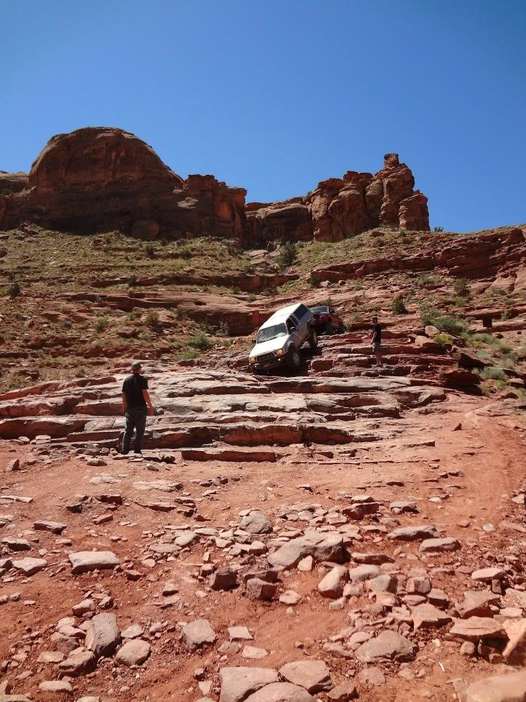

    A few pics I stole from teamhypoxia from Cliffhanger:
    Very first obstacle
    Put the skinniest guy up on the slider

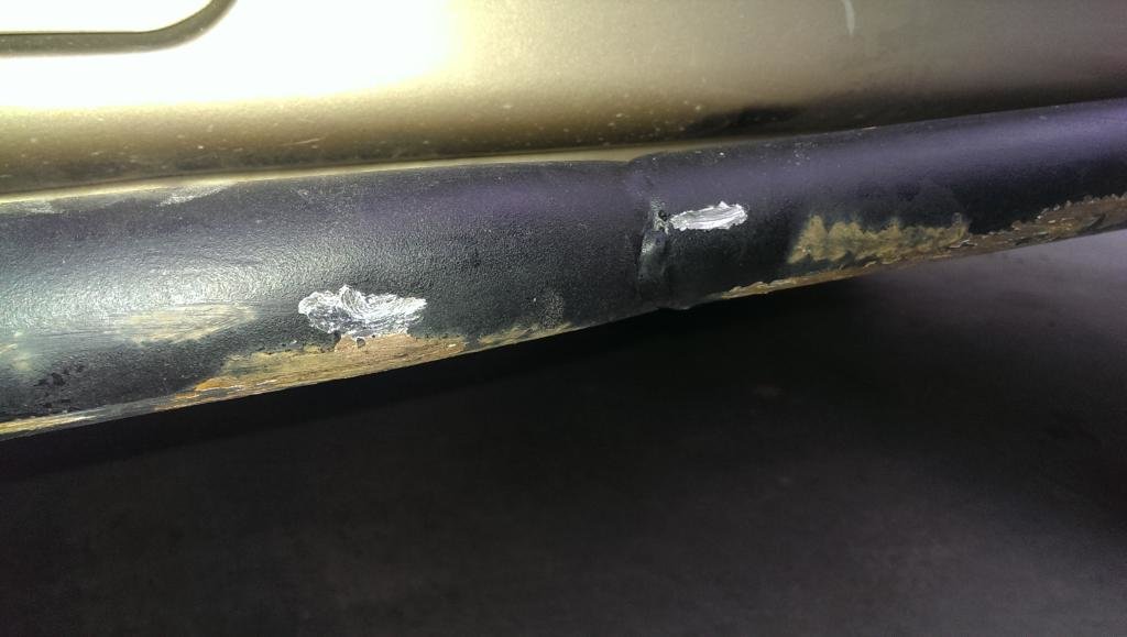

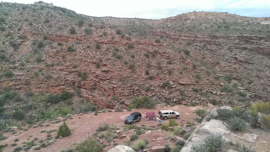

    Forgot to post this one of our camping spot in Cottonwood Canyon. This little section of road was quite interesting with a few bigger obstacles:

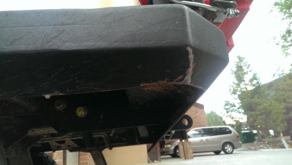

    And rig inspection:

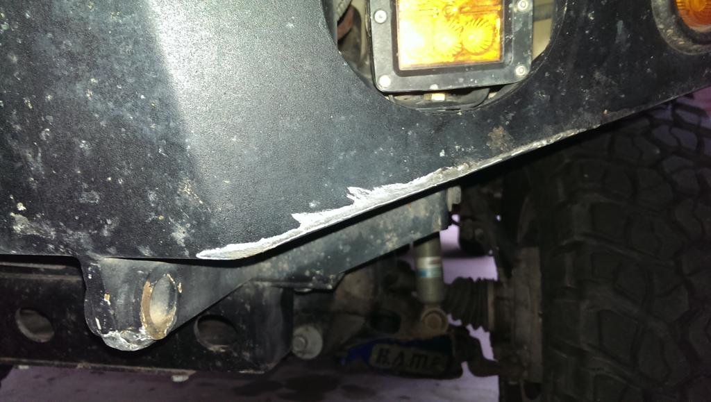

    Hit my new bumper pretty good:

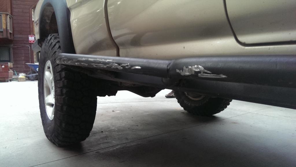

    These are little dents in the slider:
    Hit my front bumper:
    And got this slider good:
