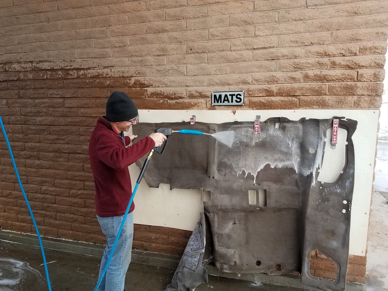

    Enough to make it a lot of fun!
    Here is Brett power washing the carpet out of his truck.
    There was some serious brown slug coming out of it.

    I bought the Noico stuff. Has excellent reviews. :notsure:
    And everything else out of the cab.
