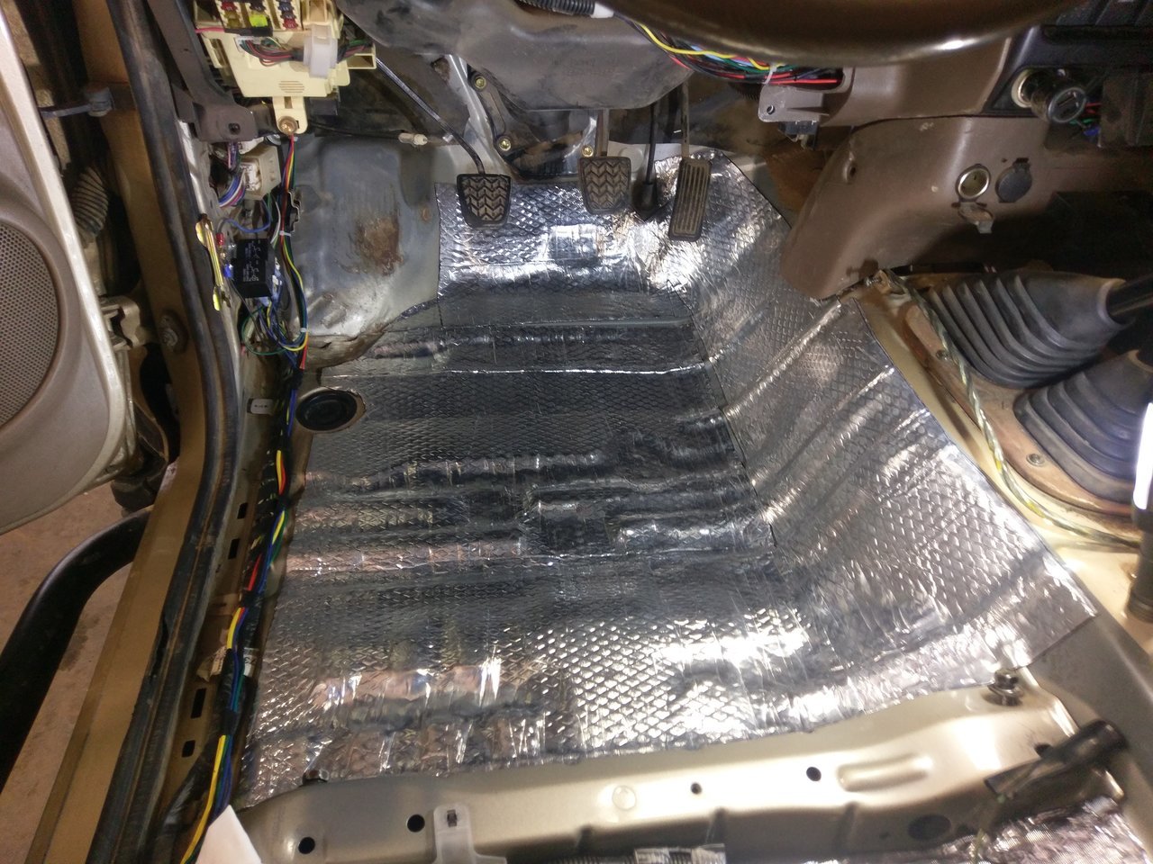

    Found a lot of the stock deadener on the floor was hardly attached, so decided I will do the floor.
    [​IMG]IMAG0459 by brettbjorgum, on Flickr
    Got to work on the first door. Huge PITA.
    [​IMG]IMAG0460 by brettbjorgum, on Flickr
    [​IMG]IMAG0461 by brettbjorgum, on Flickr
    Tossed a little foam over top the inner layer and got the door panel back on.
    [​IMG]IMAG0462 by brettbjorgum, on Flickr
    Glad I'm not in a hurry to get this done.
