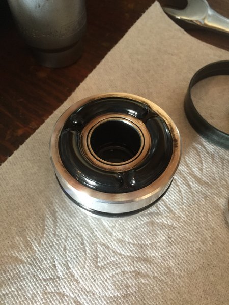

    I don't think you can run a shaft bumper with the welded rod ends.
    Some of the newer Kings i've opened have a small rubber ring on the back side of the seal head to stop at full extension. But I doubt you have anything in there to keep it going metal to metal at full droop. doing it a few times won't hurt anything but repeated and with force can cause some damage.

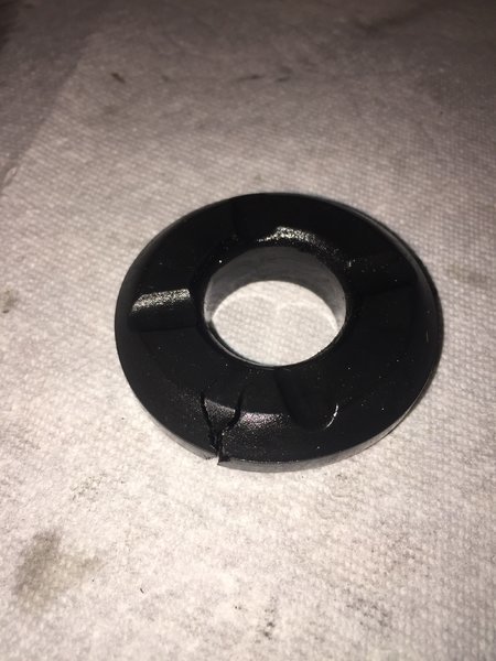

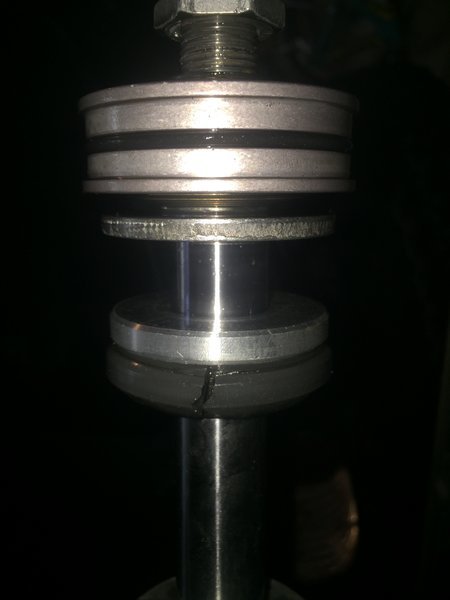

    [​IMG] [​IMG]
    [​IMG] [​IMG]

    My coilovers had both. The the bumper lost.

    Nope, that is just what showed up, the washer is welded to the end. In retrospect not needed and I had to trim the washer to get it to fit in the shock mount anyways.
    Between the o-ring and bumper configuration, the bumper is the weaker of the two, and "lost", as in it cracked in half, shown above. Got it?

    King has some nice beehive shaped 7/8 shaft bumper now, almost like an OEM raptor front shaft bump.
