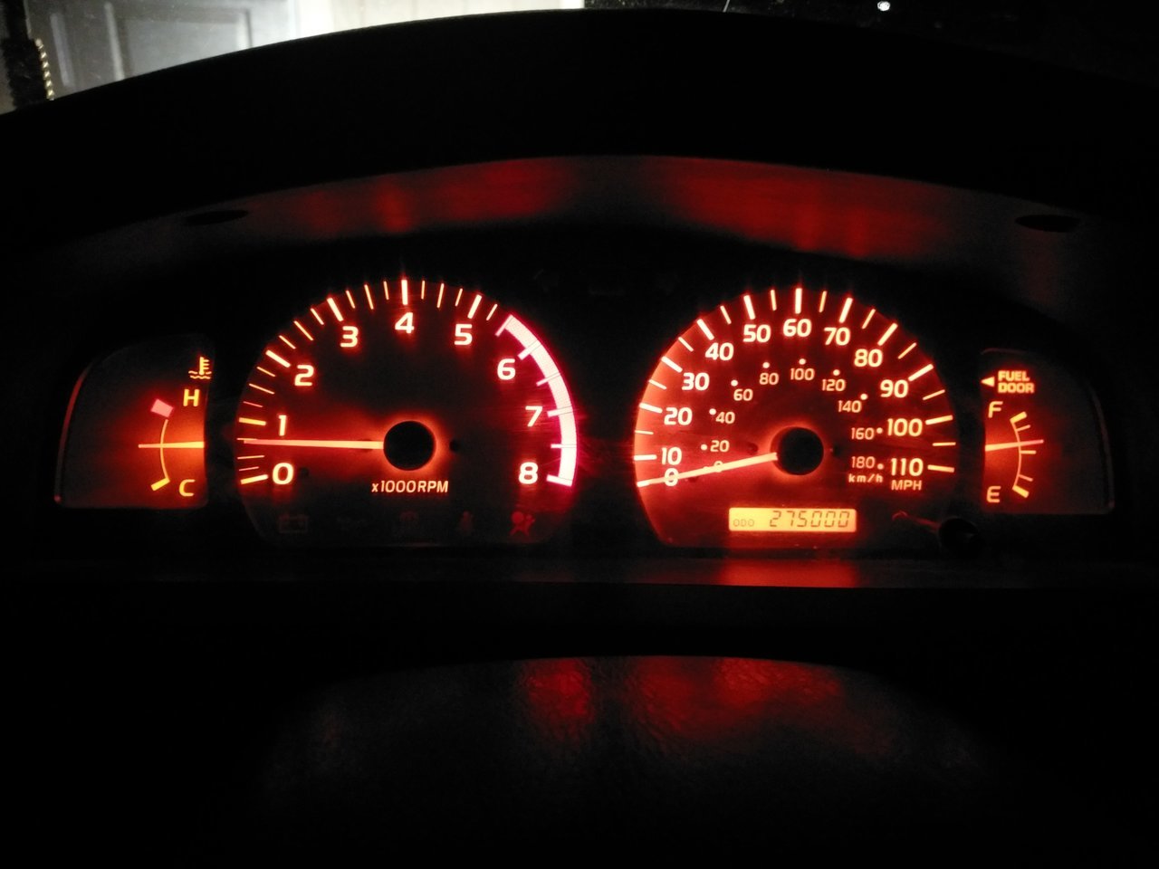

    Would have hit this on the way back from moab had I not discovered the broken leaf. Just took an extra four months.IMAG0484.jpg
