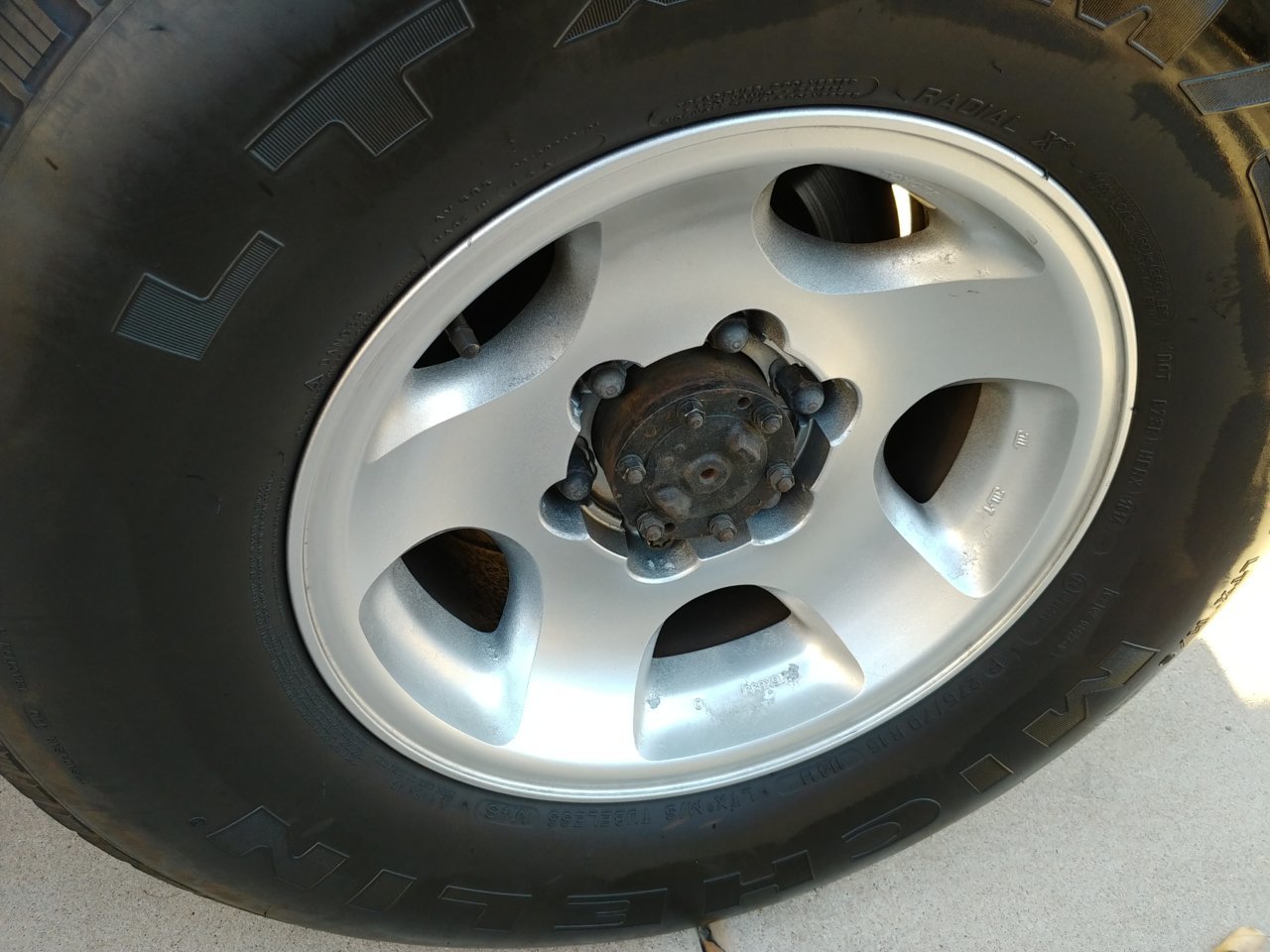

    Yes. LROR and ordered a pair.
    Going to do both at the same time while I have the press fixture and everything out. It's a pretty easy job really now that I have the press fixture and have done it twice.

    Lol^ so are these shafts stronger?

    hope so. They are Chromoly..

    Me too. And the options are used or these.
    Could've called up Yota Jim again and see what he gets for an axle shaft, but then who knows what I'm getting and I would want to go through changing bearings anyways. For the price of these seems like it'll be worth it. :notsure:

    They should be stronger. If i find bent shafts any my other trucks thats what Id go for.
    Doesn't seem hard to bend them doing what we do with bigger tires. But not surprising as they have no support at all other than the outer bearing and at the diff.

    Time for a full floater, they're much easier to change bearing and shafts on haha

    Yeah actually finding an LC rear axle has crossed my mind. Think those are semi float though.
    I know you can find junk yard 9'' ones though for decent money. Id do that if I could find one for a good price.

    80 series rears are full floaters after 9215228885370553833561899359548998.jpg ...
