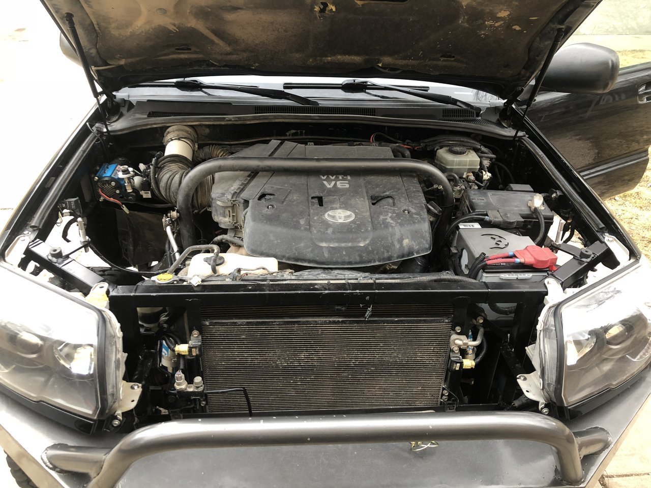

    And started working on PS pump replacement and cooler install, along with a new radiator. Finding more cracks in the core support. :(
    [​IMG]IMAG0741 by Brett Bjorgum, on Flickr
    [​IMG]IMAG0742 by Brett Bjorgum, on Flickr

    I foresee . . .
    A lot of work in your future.

    I was debating welding them up. Not sure it would do anything besides delay the inevitable. Really don't want to do what you had to, but guessing it's just going to keep getting worse.
    I believe the one's I ordered are the only option. Before he was making them your only option was to get the whole mount.

    What did @Wishbone Runner have to do? Just wondering if this is something I should consider doing while I have things ripped apart

    Full core replacement. Just cut the truck in half, you’d be better off.

    You can keep repairing it, but it’s just going to keep cracking. I would repair as needed and just let it go, but ultimately if you keep beating on it the whole thing will need replacing at some point.
    Cool, glad there are aftermarket options, on my truck you had to buy the whole support, bushing we’re not separate.

    I plan to keep beating on it so it'll keep cracking. I'll go ahead and weld these up while I see them and go from there.
