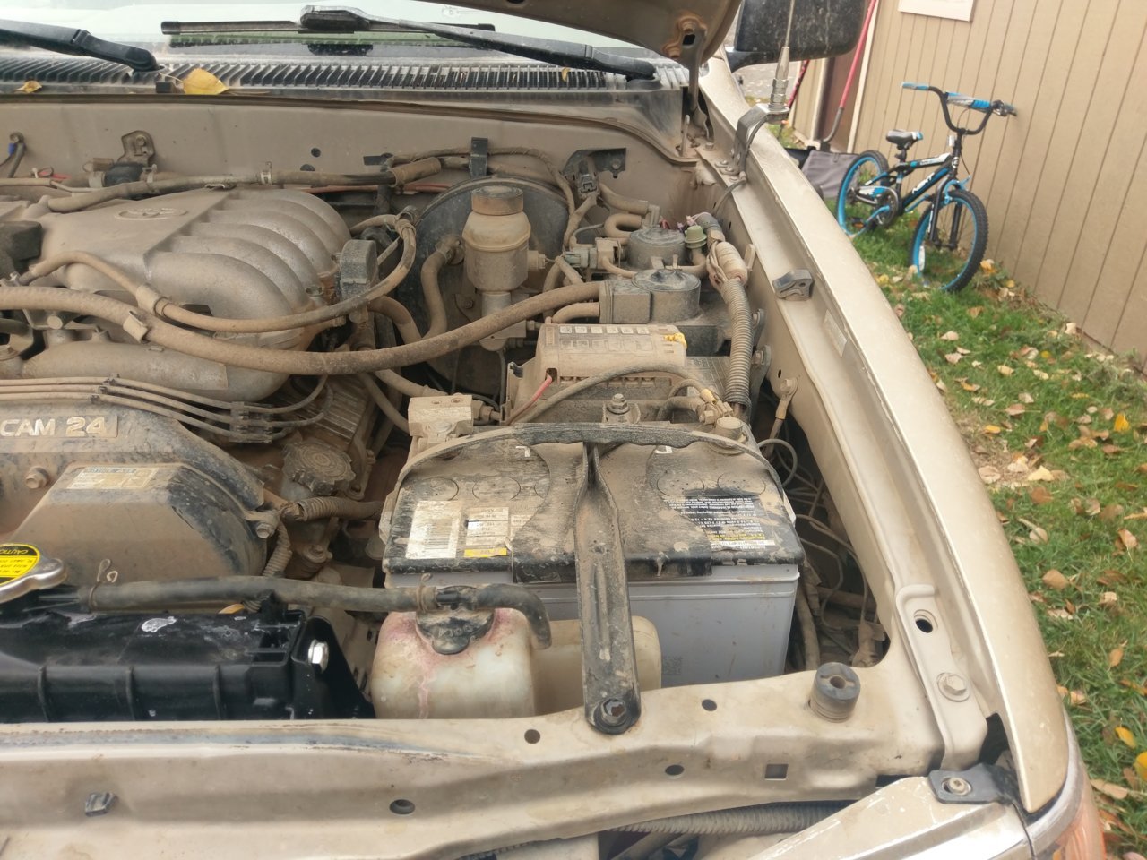

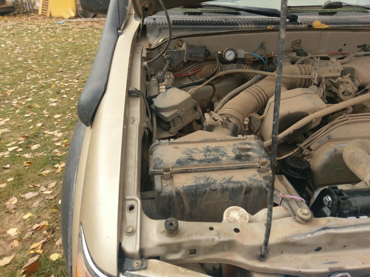

    I was looking at mine while finishing it up, and was thinking there would be way more stuff to have to relocate and mount than yours. :notsure:
    As it keeps getting worse I'll think about what I can do, but wonder if I can beef up the core support without replacing all the fender liners and stuff.

    Where did you get the cooler and line?

    Yep, lotta shit going on in there, good luck!
