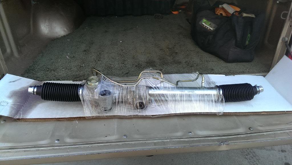

    So,
    Spent today taking out the AAE rack, swapping the poly bushings into the new rack, and installing the new rack. A few minor unexpected delays as per usual, but overall it went pretty smooth. Did a half-ass tape meausre toe adjustment, and the steering wheel is dead on and it's tracking straight, but still going to get an alignment this week. First impression is that it steers with considerably less effort than my old AAE rack, and, as far as I can remember, my 225K OEM rack.
    Thoughs on AAE:
    Overall I don't know what to say. Mine clearly had a defect, that, as far as I know, no one else has had. So that could just be bad luck. But things that aren't:
    - Timmy, Adam, and myself, have all had issues with the inner tie rod ends.
    - There seems to be no consistnecy among the same product:
    - Mine rack appears to have brass guides, unlike Timmy's

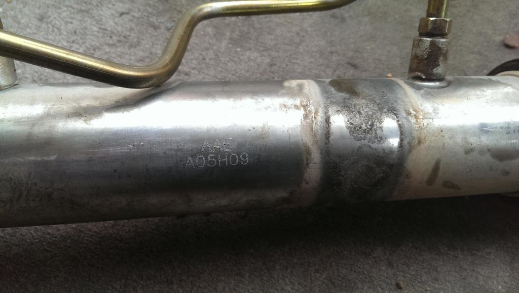

    - Mine has an AAE stamp in the bottom of that rack, Timmy's doesn't:
    Suttle differences like this lead me to believe they're not delivering a consitent product. What that means? Well, your guess is as good as mine, but who know's what you'll end up getting.
    And I'll conclude with this: At this point though I still strongly suggest that no one buy an AAE/Safari steering rack.

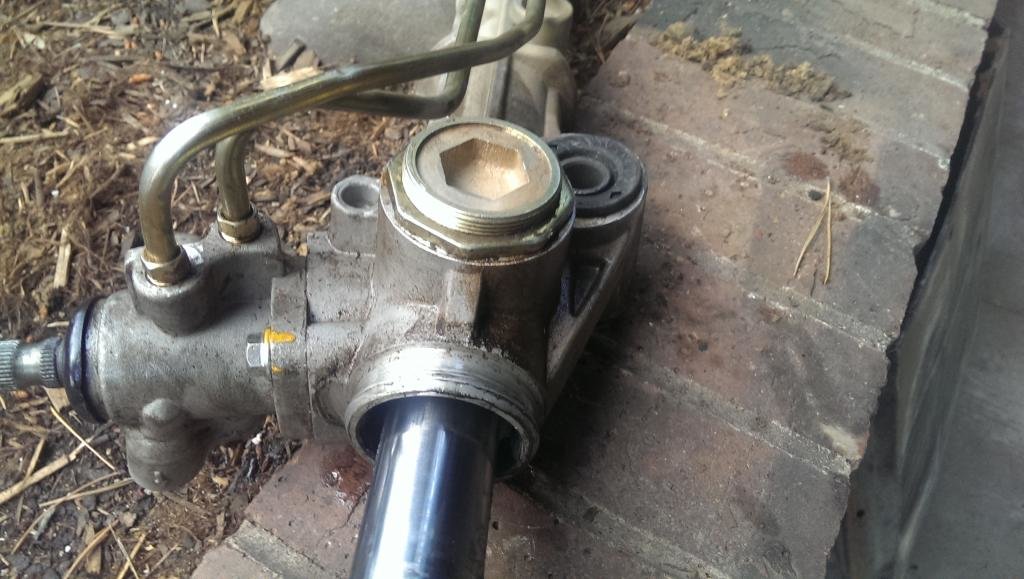

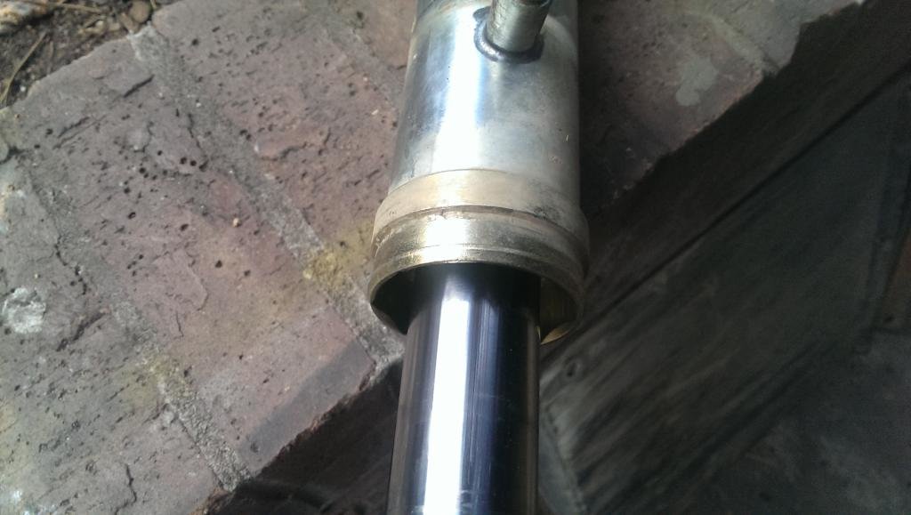

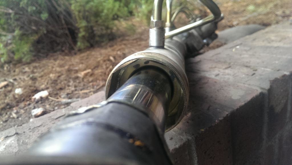

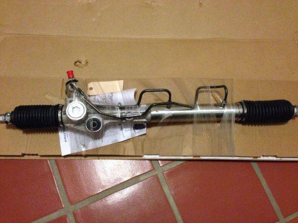

    I apologize for my lack of knowledge, just going off what I've learned and what others have told me. I know you're the expert on this. Anyways, these racks were suppose to come with brass guides which was part of the hype on them. These parts on mine are brass:
    And for further reference. Here's what mine looks like when I got it:
    And Timmy's

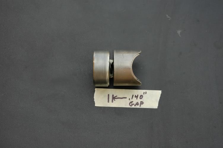

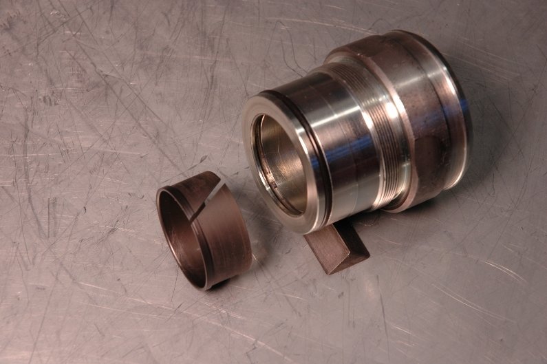

    I have no hands on experience with these these racks but I am curious as to what's going on with them. There has been talk about a "brass bushing" in place of "plastic" on the OEM rack. Any mention of the "guide" being brass is new to me.
    An OEM rack contains only one bushing and one guide, both are inside the rack and can not be seen from the outside.
    Your first and second pic shows what Toyota describes as the "end stopper" on the passenger side of the rack. It contains a plastic bushing and it is/was my understanding that the AAE rack used brass instead, for just the bushing. I am thinking you may be mistaking an external coating or plating process (for corrosion resistance) on the "stopper" for the actual bushing inside it.
    Here is an OEM machined steel "stopper" and the plastic bushing (left) that fits inside it. I have always thought the AAE rack used brass for this bushing and that was the only real or imagined improvement over OEM.
    Your third pic is the preload adjuster for the rack "guide" found under it. Again, the color of the plating on the adjuster would have nothing to do with the composition or durability of the guide itself.
    Below is the late style OEM adjuster and guide (right) viewed from the side. The guide has a plastic friction surface (far right). Did yours have brass instead of plastic?
    Just trying to figure out all the facts, thanks.

    Simple, loosen the lock ring an unscrew the adjuster. Think of it as a giant drain plug. You may need a magnet to pull the guide out after the adjuster is removed. It might fall out if you tip the hole down. They are not a tight fit at all.
    You will need a tool of sorts to fit the giant hex socket. On an OEM rack a 7/8" rod coupler works well. I used a putty knife stuck across an opposite pair of the hex "points" and twisted that with pliers. There may be some sealer causing some drag, other than that it would unscrew with your fingers. Mark the adjuster/housing and count the turns if you want to put it back as it was.
    In your third pic it looks like there may be some "anti-tamper" or "witness" paint on the control valve bolts. Check for anything similar on the adjuster.
    I wouldn't want you to void your warranty over this. What ever you use for a tool, maybe put some tape on it so as not to scar up the adjuster or just whittle 6 flats on a broom handle, the thing should not be tight.

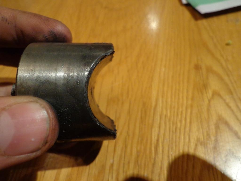

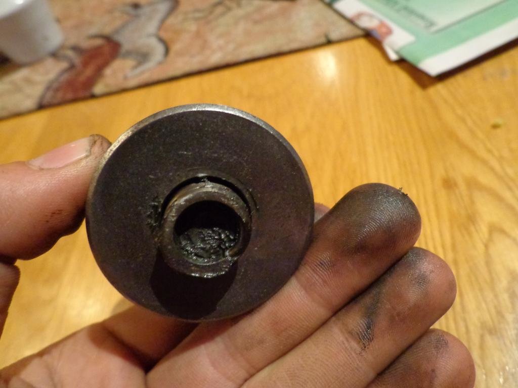

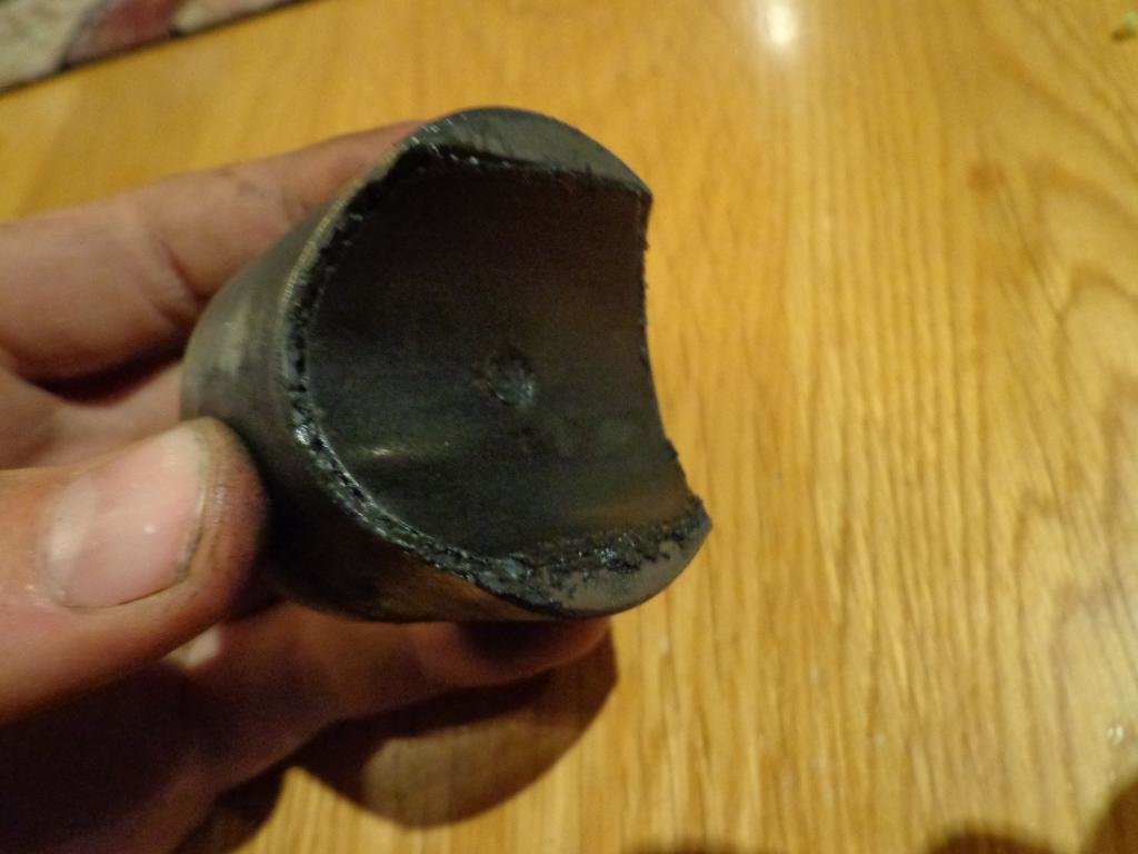

    OK, so for the good of TW I investigated further.
    Rack guide is clearly not brass, but is also clearly not plastic. It's metal of some sort, and looks quite a bit different than yours Dirty Pool. The friction surface, as you call it, does not extend down from the rest of it:
    It's covered in grease, which I didn't want to remove.
    And then check this out. Had a hard time holding the rack, moving the beam around, and holding the camera, but check this out! :eek:
