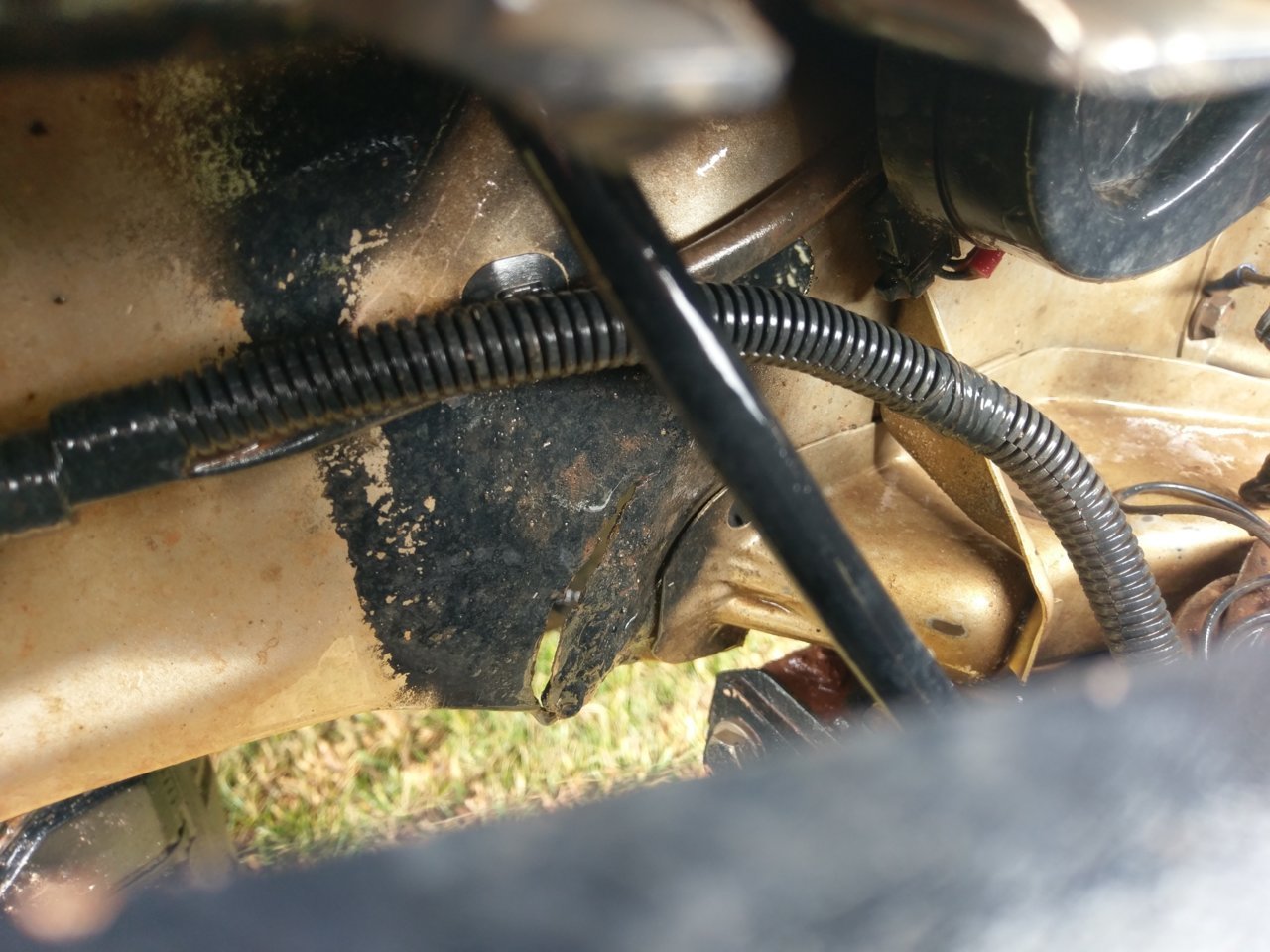

    Did you drill the ends of the cracks before welding them up?

    Do you know what it is, and are you wanting to sell it? I was looking at a JD2, or one of the several that look just like it.
    I can substitute leverage for muscle.
    This was the first one I fixed, welded a little scrap behind the crack. This new one follows the edge of that. I think If I put it in even bigger patch it would just continue to crack on the sides.

    That’s always a possibility. Once you weld it the heat also creates weak points around the weld. The metal is so thin and it’s trying to carry everything on that side of the core support. I’m not surprised it cracked again. Mine doesn’t crack it just bends over and over and I keep hammering it out. It’s just a weak point right there. My main reason to build an engine cage. Good luck on the repair bud.

    Drill the crack and then rivet a doubler over it.
    Why does it bend there? My truck has that as we, I figured I just smacked it into something?

    It's cracking all over my core support, not just there.

    Weight of the battery, fenders, blah blah blah, ect and going faster than most over dirt roads will cause the header panel to sag and crack out.
