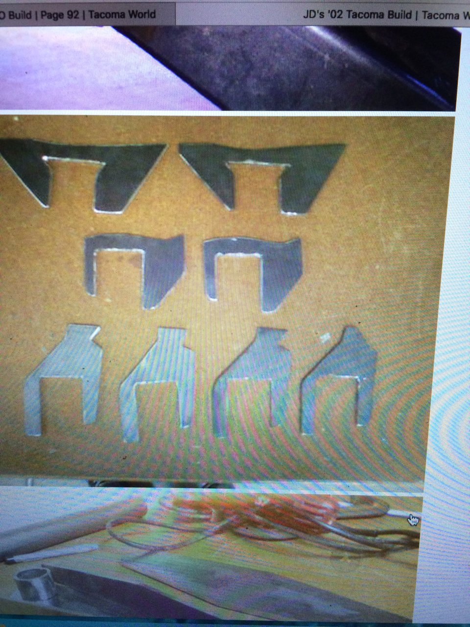

    I remembered you had posted that before.
    You going to cut me some of those on the waterjet so I can do it right the first time? :boink:

    Here ya go. How JD did his. Good luck bud.

    Thats what I want to do. Plate all that shit up.

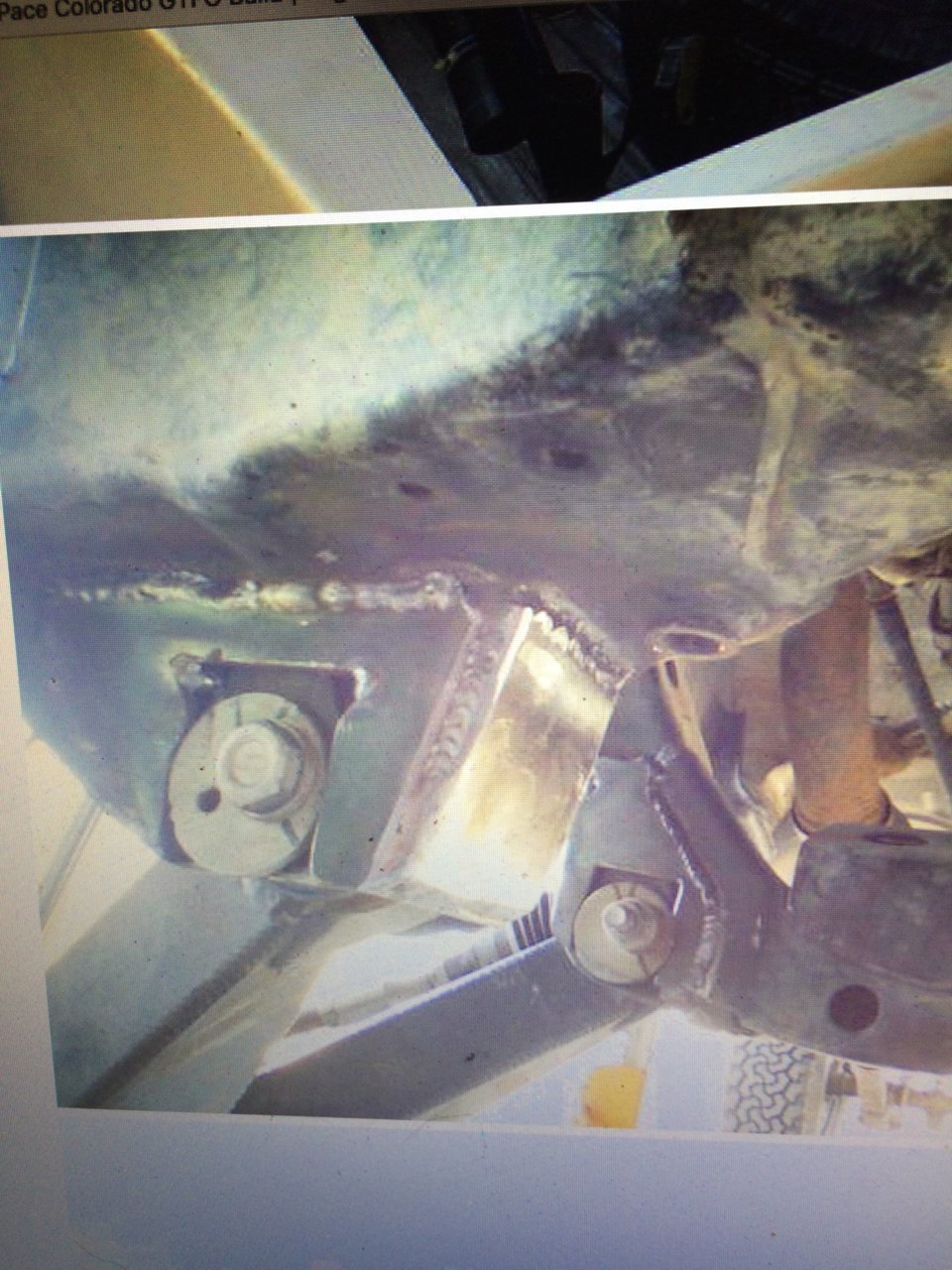

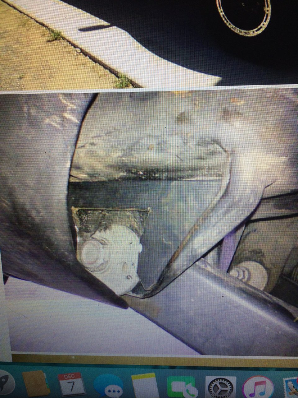

    With engine perches you can add gusset without pulling the motor. I’ve boxed the inside of the perch with1/4” plate. I also added 1/4” plate on the bottom from the front of the perch to the frame. This was all done before my motor swap. I ended up fabbing up whole new perches and running Bomb proof mounts.
    Others have gusset the outside of the perch
