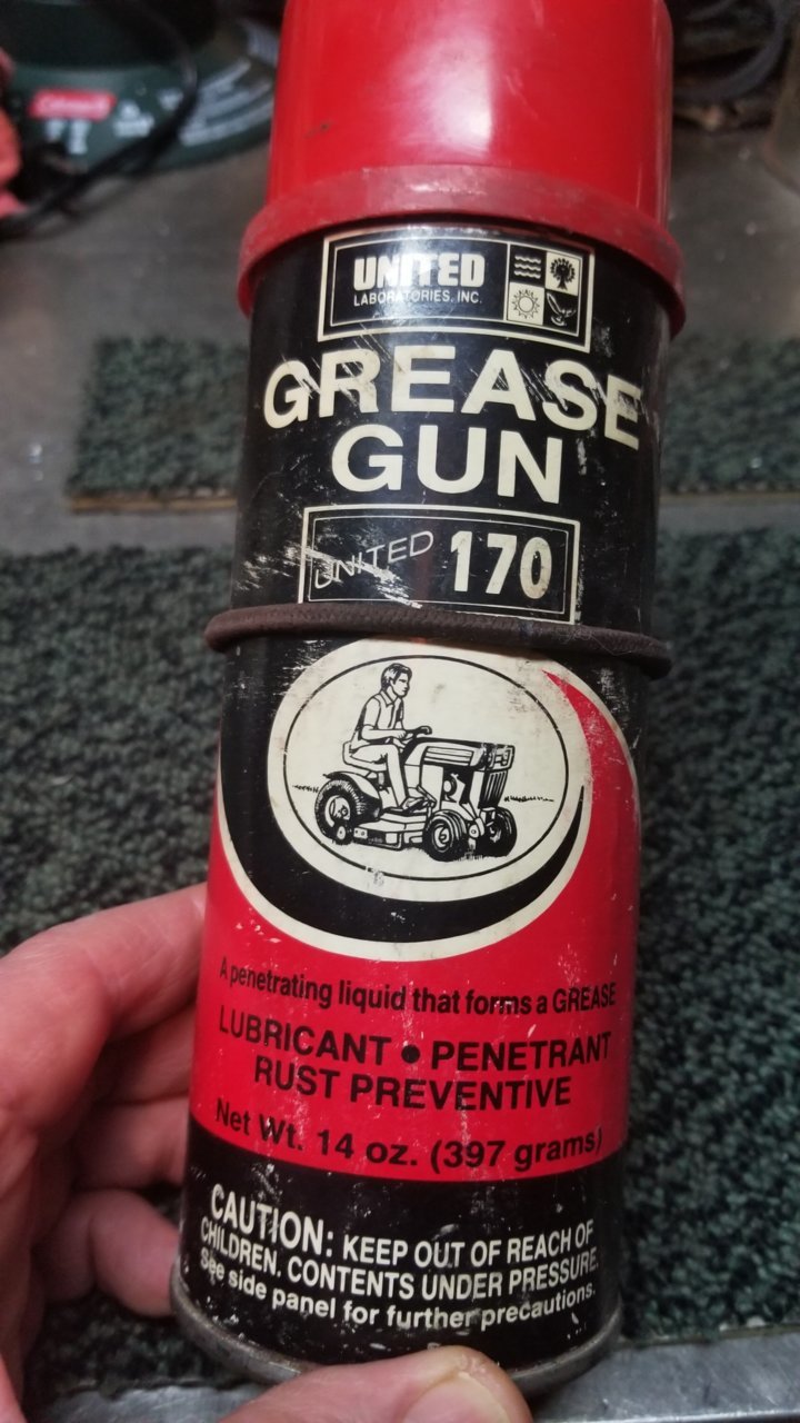

    It's worn out. I you have a lot of keys or excess weight on your key ring, it contributes to the cylinder wearing out.
    My drivers door is like this, sometimes i gotta use the passenger side to get in.
    Spray grease, which thickens and helps to fill in the voids, seems to really help

    White lithium stuff is easier to find but doesn't thicken up quite enough.
    Here are the specs on the stuff.
    http://www.unitedlabsinc.com/catalog/shopdisplayproducts.asp?id=24&cat=Lubricants
    http://www.unitedlabsinc.com/catalog/shopexd.asp?id=1018
