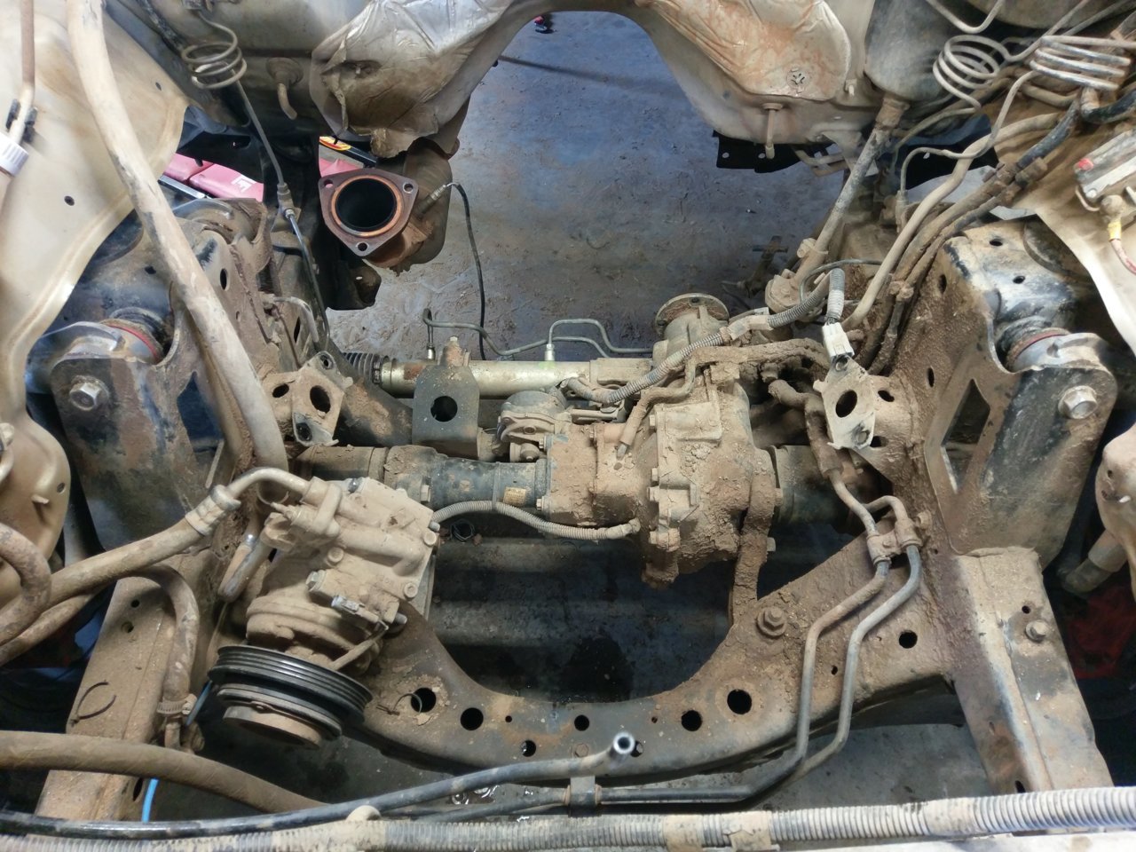

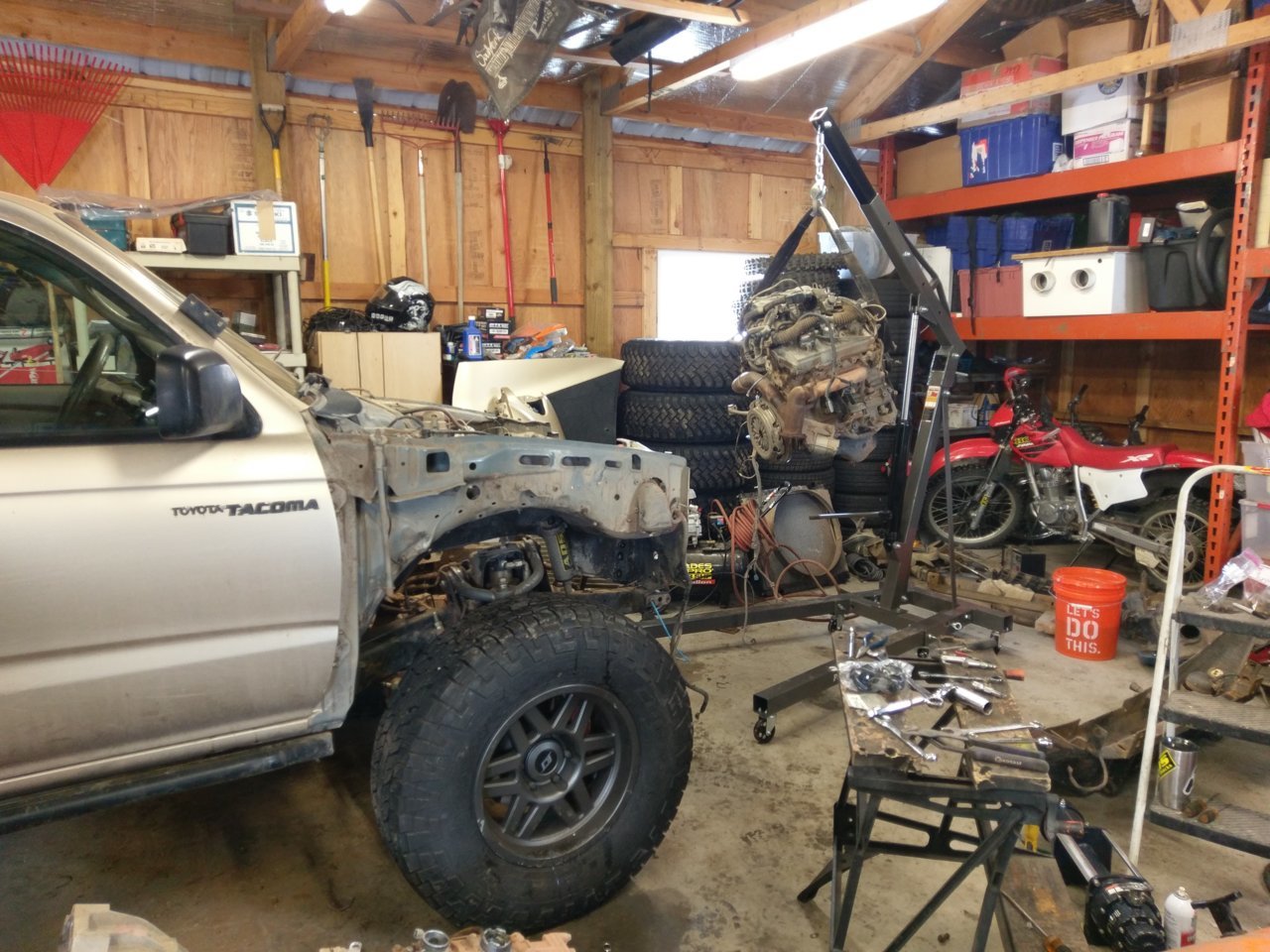

  13. Feb 23, 2019 at 3:04 PM
    #3373
    Squeaky Penguin
    Squeaky Penguin [OP] Nothing Ventured, Nothing Gained
    Apr 5, 2012
    #76340
    10,082
    Brett
    Steamboat Springs, Colorado
    '01 4WD, SR5, TRD & '13 TRDOR AC
    Lots of dust and custom dents, Check Build
  14. Feb 23, 2019 at 3:06 PM
    #3374
    jubei
    jubei would rather be doing something else
    Mar 17, 2016
    #181549
    6,062
    Jason
    NoCo
    White 2002 XC TRD and Yellow 1971 JEEP CJ5
    Stuff. Also things.
    That shop has me :jellydance:
    Looks good, Brett!

    I think it looks like a lot of work.

    2014 TDR Off Road
    Enough to make it a lot of fun!
    We fixed the power issue. He has now gone green. California compliant
    One Brett power!

    '12 DCSB TRD OR
    That's gonna suck bad.
    LS swap instead :thumbsup:

    I am trying to talk him into a turbo kit since he has the motor out.
