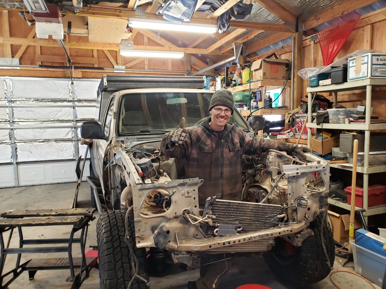

    Do you have a mustache? If so we need a better pic.

    I think he's just wiping his snot nose with dirty gloves.

    He is attempting the facial hair thing but isn't very good at it, but what you see is a shit ton of dirt on his face.

    Good to know I have such supportive friends! :brianr:
