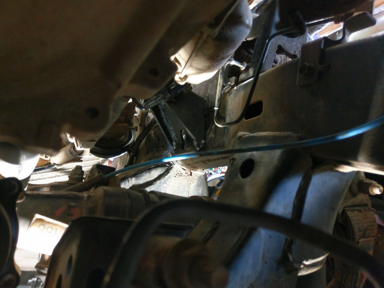

    Transmission bolted in. Need to do some fine tuning and then tack the perches in, but super happy I'm going to be able to make this happen.

    Got everything in place and tacked, and pulled the trans and engine again.
    Fully welded with little frame plates on either side.

    Didn't measure exactly, but I think they ended up a 1/2" higher, and very slightly further forward than the original perches. The higher I expected, not sure why they ended up moving forward though. I had the trans mounted and bolted tight, so it was solid front to back. Regardless, there's several factors going on between the mounts and perches, and as long as everything works I'll be happy.
