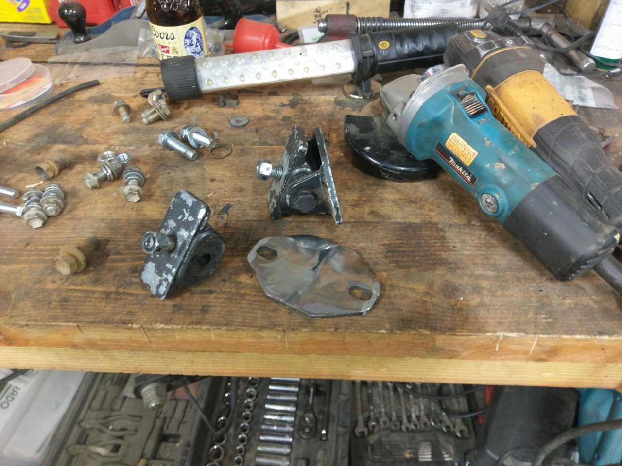

    are you happy with the quality of the perches? one of mine broke off and I need to fix it. I have only seen the dmz ones until your thread with these.

    Quality if fine, aside from the issue of the bottom portion hanging below the frame and needing to cut them. When I talked to them it sounded like an issue with a recent redesign that they would be addressing it though, so it might be fixed.
    Time = money though, so if I were to do it again, I would probably just get the DMZ ones to have them fully welded and ready to toss on.

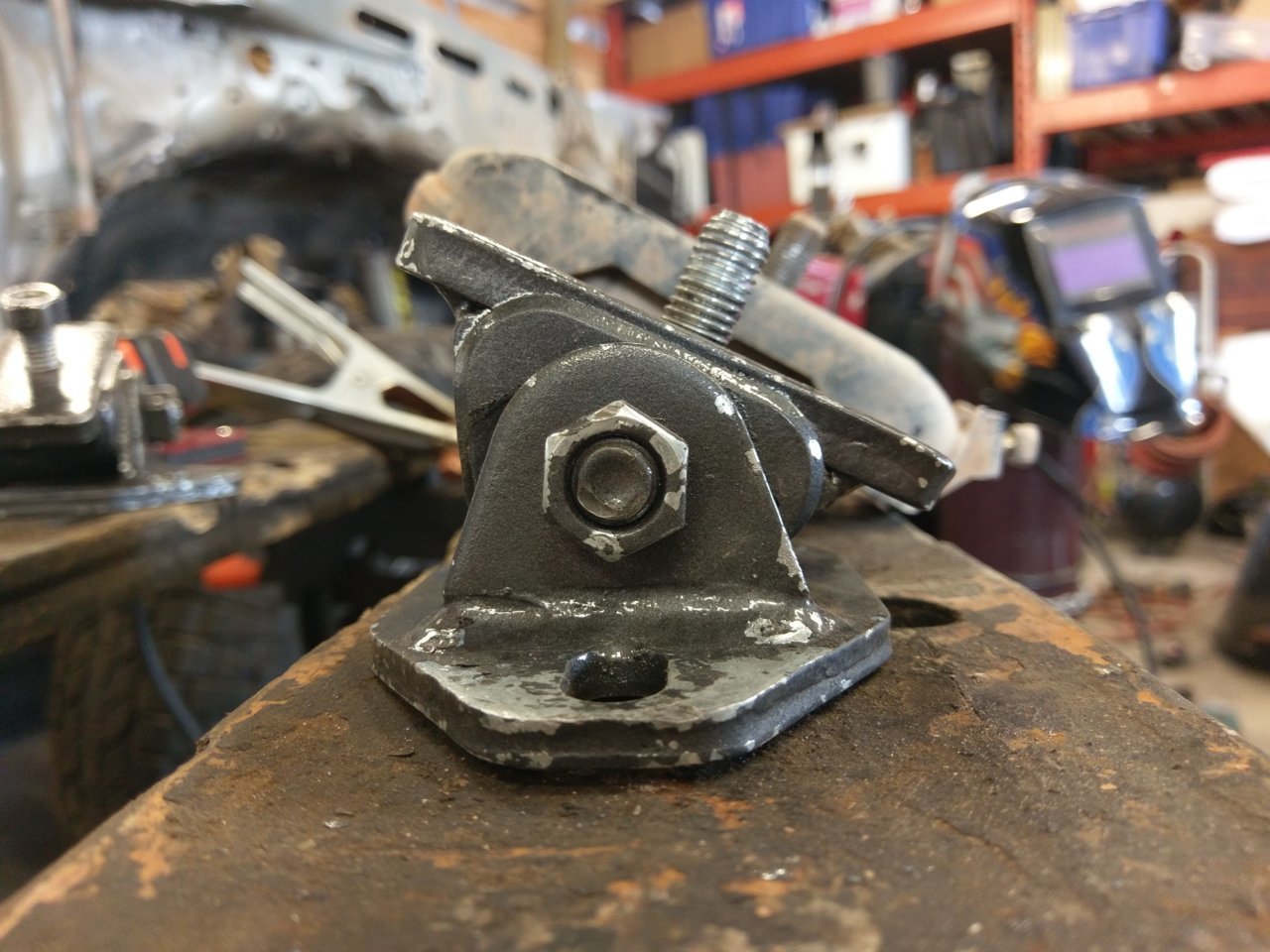

    I think this picture sums it up pretty well.
    Aside from the noticeable height difference, the stud is also higher up on the OEM mount. Also means that like a 1/3 of the plate that's against the engine bracket is sticking out past the edge.

    Maybe I'm not understanding the geometry here (never messed with motor mounts) but if the perches were where they needed to be for the motor to be in the right place would they still stick below the frame?

    I just remeasured versus some measurements I took initially. Problem is all in the mounts, not the perches.
