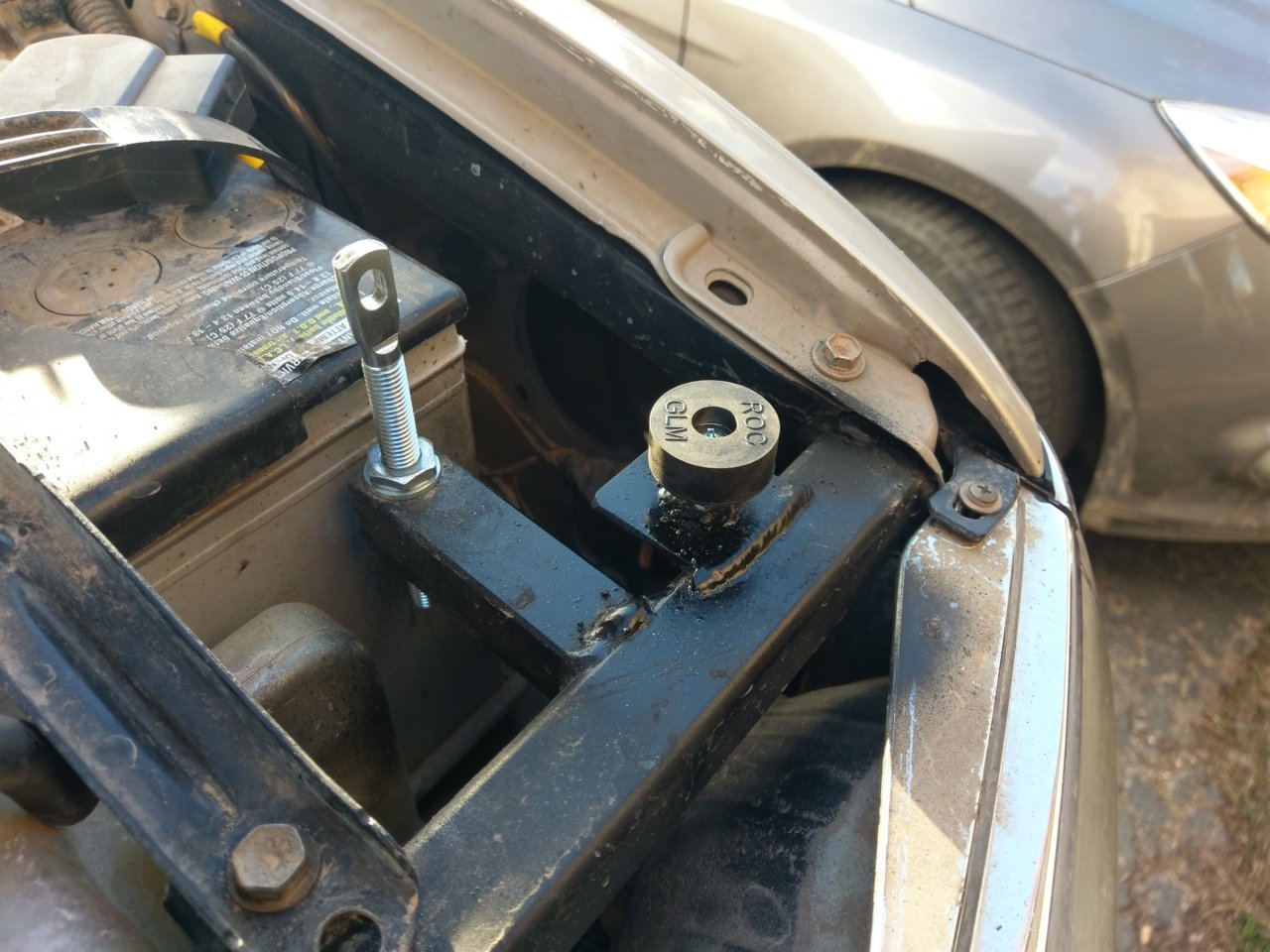

    Salvaged my first attempt and got some hood bumpers installed. These ones have a threaded rod and are much easier to make work than the factory ones. Also got the steel pins in. Thinking I shouldn't have any more issues with this setup.

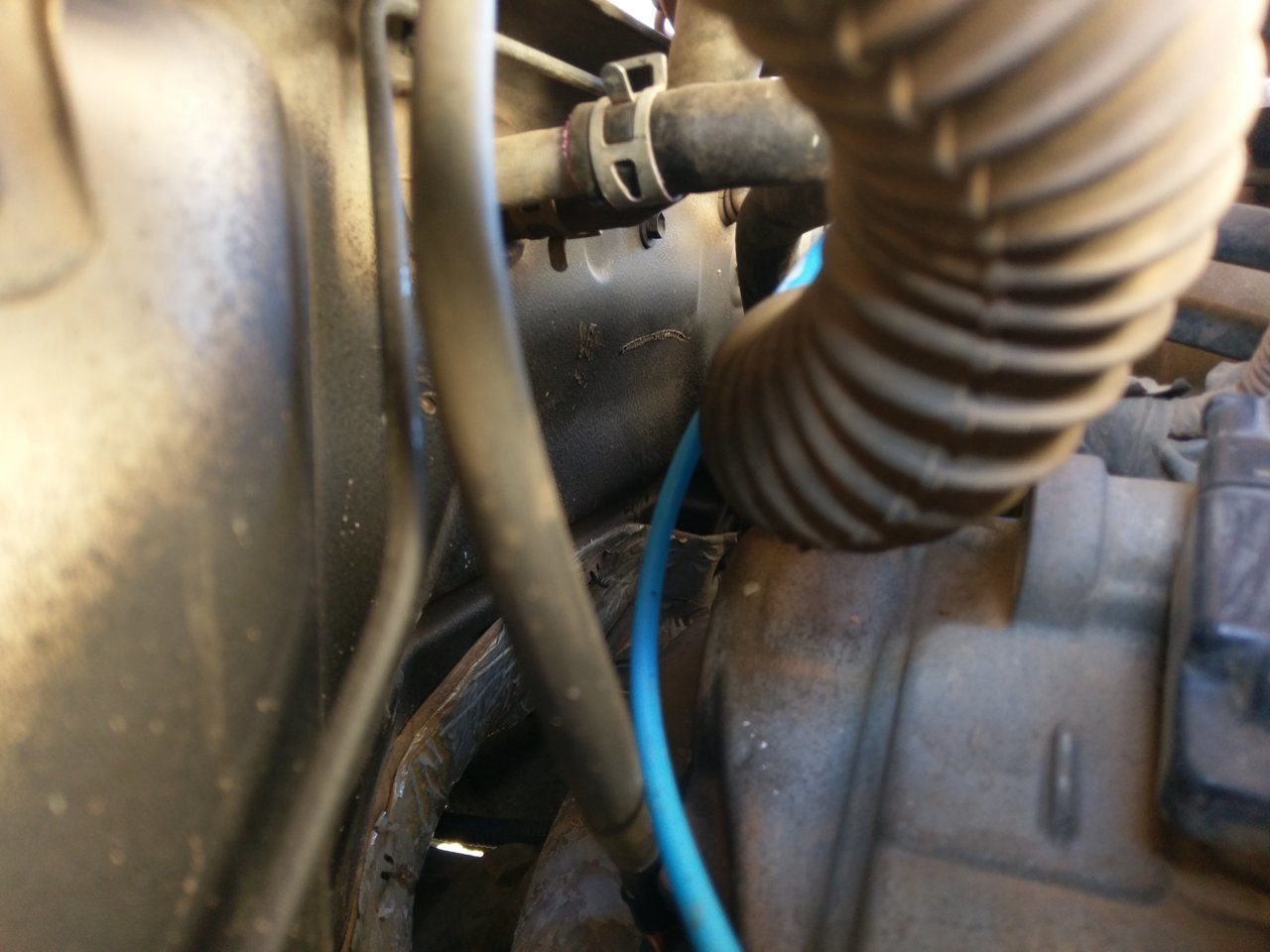

    Other issue that came up during the trip was a coolant leak from my heater core return barb.
    I may or may not have completely bent it taking the engine in and out several times. :oops: Bent it back best I could, but obviously that didn't work. Currently testing a wormgear hose clamp in place of the factory spring clamp. If that doesn't work not sure what will fix it, aside from replacing the heater core.
