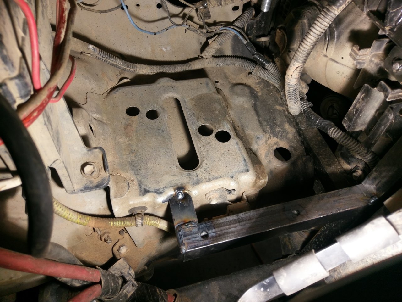

    Lower part of the bumper got the angle grinder treatment. Now on to winch install and new skids.

    Did you shave it and then plate it over, Brett?

    I cut like 2" out of that lower radiator cover piece and welded the original bottom piece back on.

    Are you going to leave it like that?

    Yes. Maybe that wasn't the best picture. It's where the skid plate mounts, so just raising that mount a couple inches. They designed that part around the bigger AT radiator.

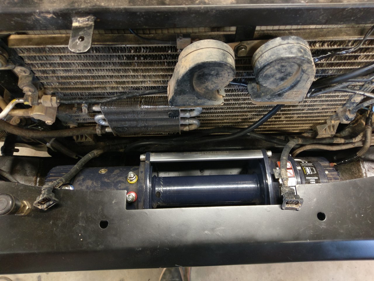

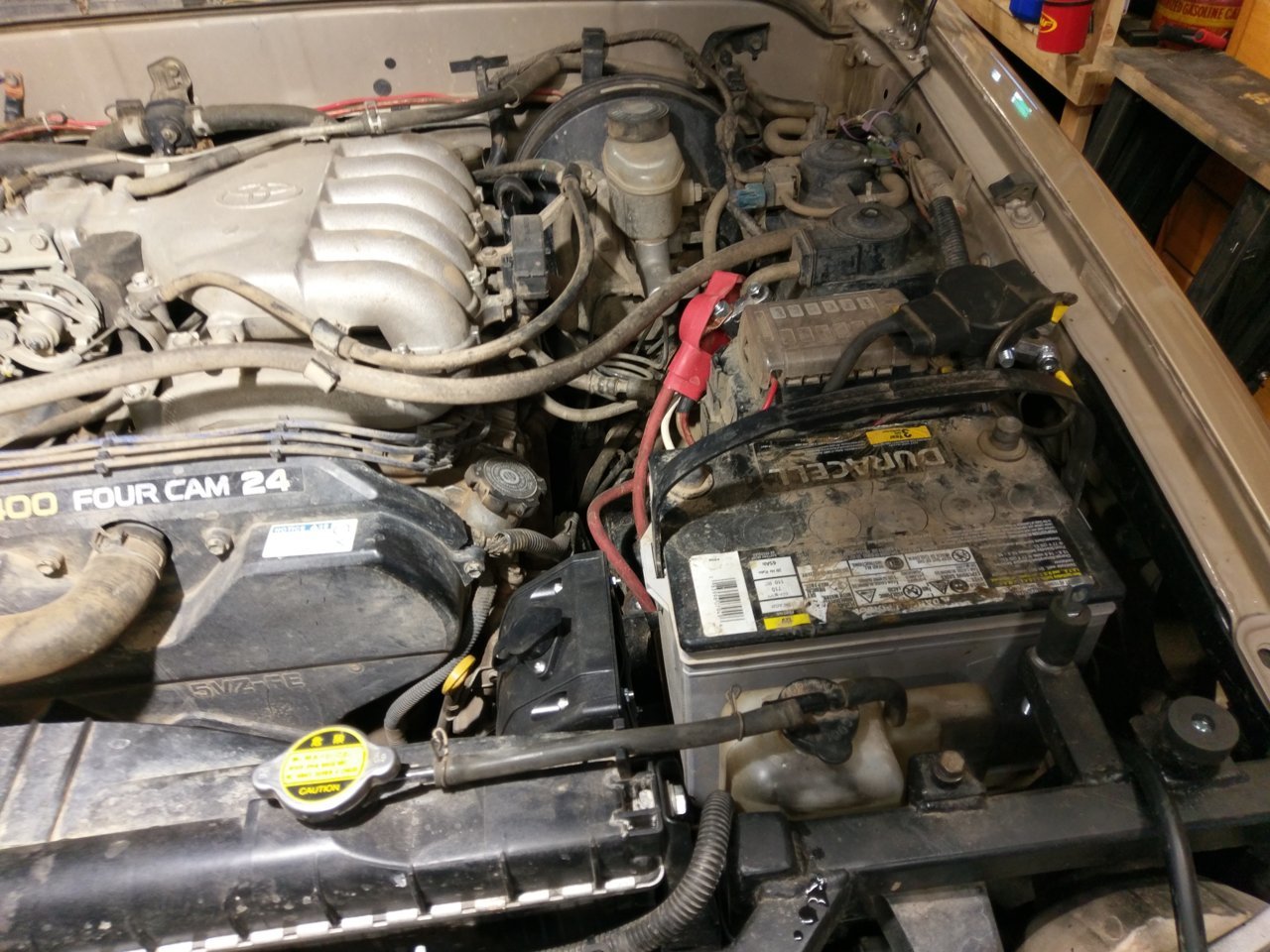

    Winch bolted up, cleaned up all the wiring of the lights, and remounted the horns. Don't think I've hardly ever used them, but figured they should be there for safety.

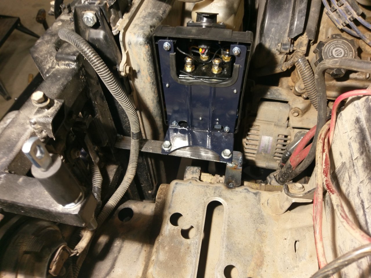

    Then started trying to figure out where to mount the solenoid. Came up with this.
    And then quickly figured out the bolt heads will hit the battery, and it's in the way of the coolant reservoir. :( We'll see how take 2 goes.

    What fairlead is that? Remember that the solenoid is ground switched, so your existing wiring will need to be modified if not already ground switched.

    It's a custom splice fairlead with the liner upgrade. My previous in cab winch controls came with the last winch, so not entirely sure how it's setup. Need to back track to the switch and go from there, but thinking I can make it work.

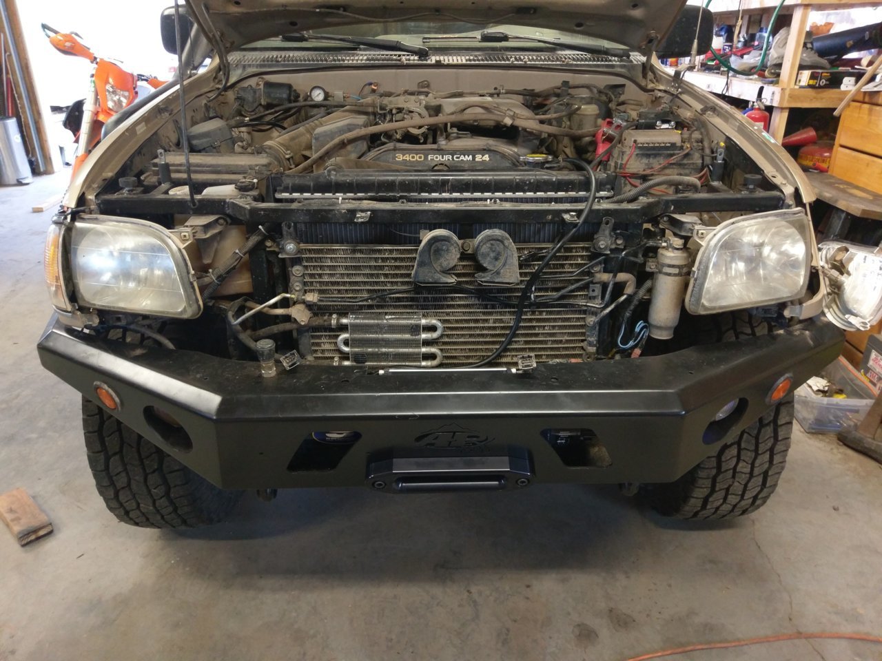

    Anyways, a little more fiddling and got the battery, solenoid, and resevoir all fitted.

    is that how you're gonna leave it?
