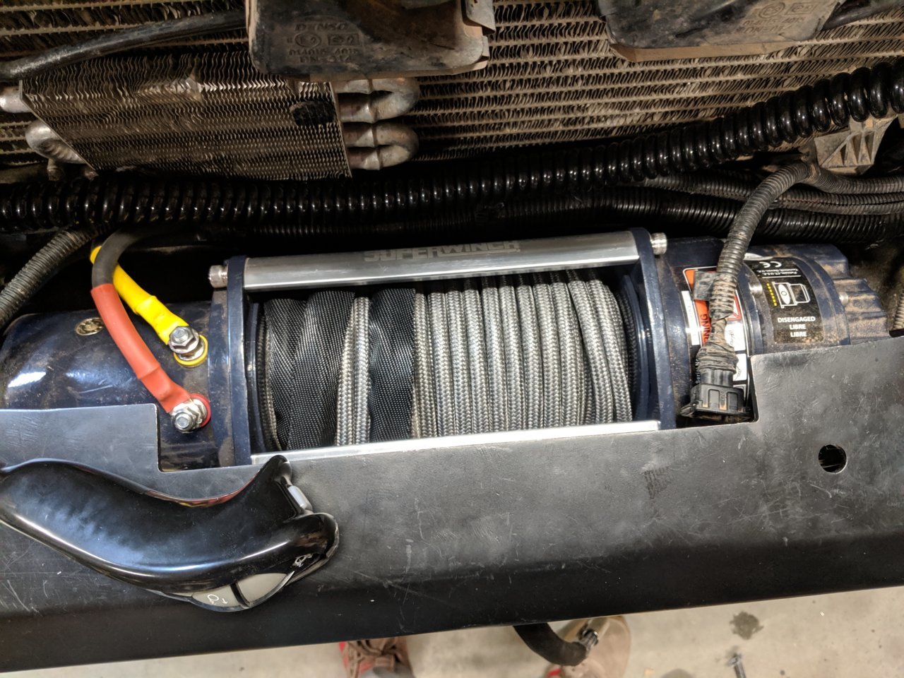

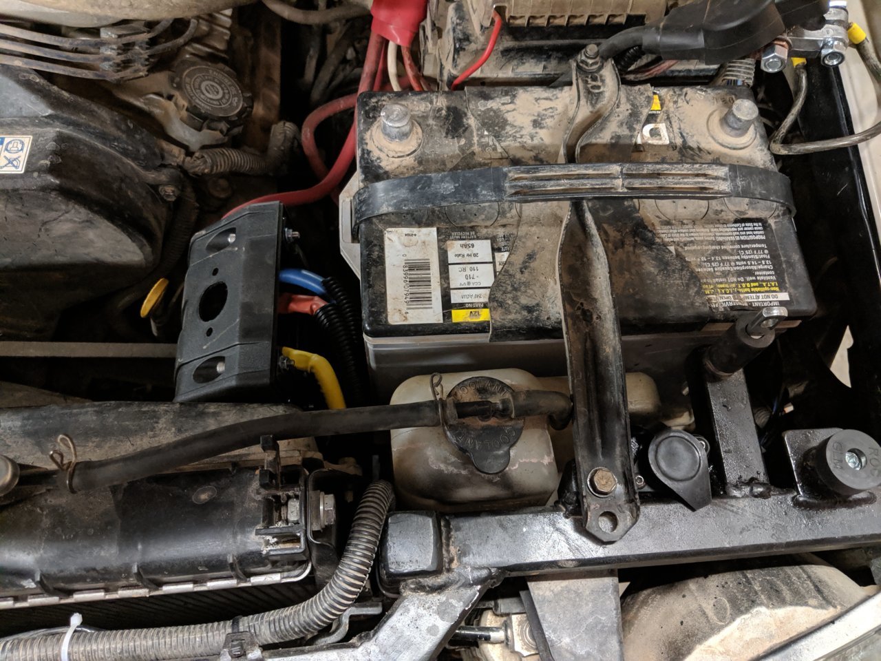

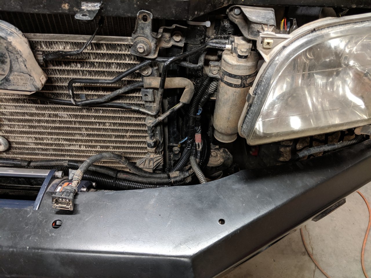

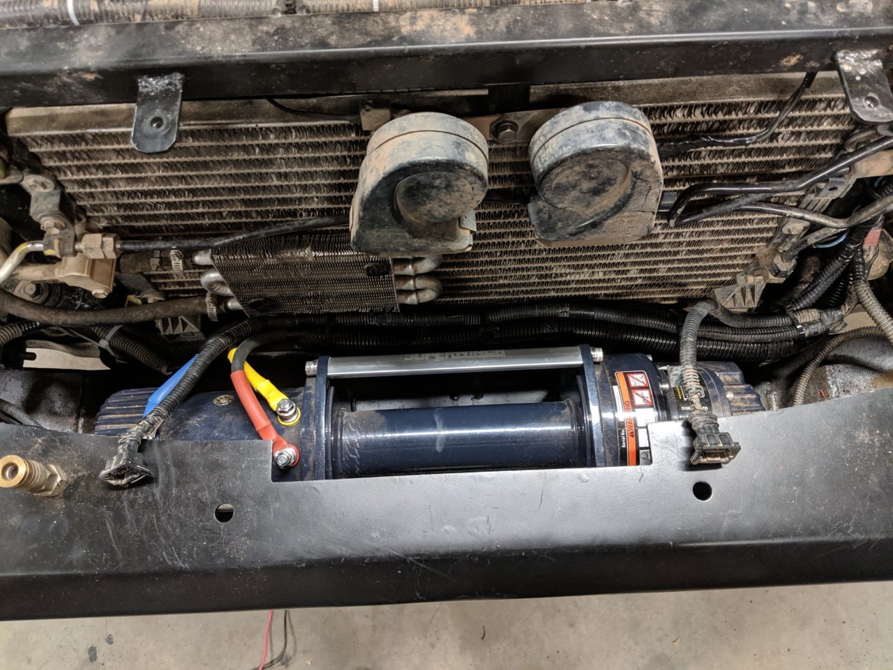

    I've got entirely too much time into this install, but it's mostly done. Was also able to get the in cab controls working perfectly without too complicated of a wiring setup and no additional relays.
    Decided I didn't have enough brackets, so I made another.
    Did this install and wiring to the best of my abilities, wanted to be able to rely on this setup for a long time to come.
    And spooled up with the Custom Splice Diamondback.
    Only thing I need to pick up is a new hook, as the one that came with winch doesn't fit the new winch line.
    Now to finish the radio install and build some new skids, then I hope I'm done for the year.

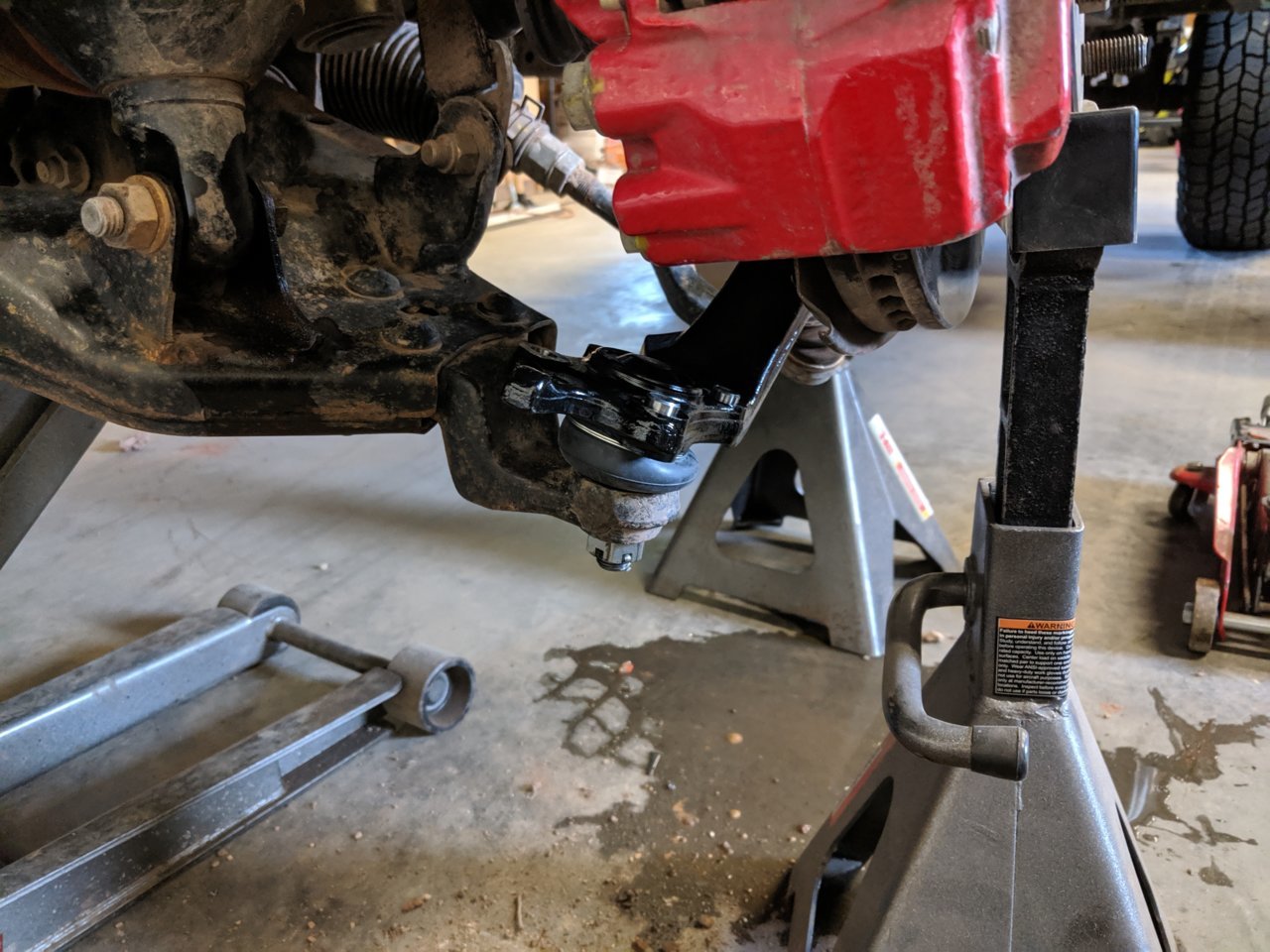

    Year old LBJs replaced.

    You only got a year out of your LBJ’s!? Why you wheel so hard bro?

    Are you talking about the ones where someone cuts a LBJ apart and adds a uniball? Have you heard any feedback on those? I've seen a few people bring them up, but no one that's actually used them.

    No not really. But sure. Just meant in general. I haven't seen anyone running them either. Is a curious idea but man if they aren't welded right it's a ticking time bomb.
    Other option is solo spindle with uniball conversion :bananadead:

    Who's doing it? Is it just cheaper to swap the uniball when it's bad? I can't imagine longevity being any better.

    Some dude.
    Not exactly a good choice: https://www.tacomaworld.com/threads/uniball-lbj.522820/
    Longevity would not be better. Be a year or so Id guess due to location(getting dunked ect). Not that much easier. Have to remove the whole unit to press out the old uniball. But would be a $30 uniball..
    I think the Solo option would be more useable but has an insane buy in price(2k)
