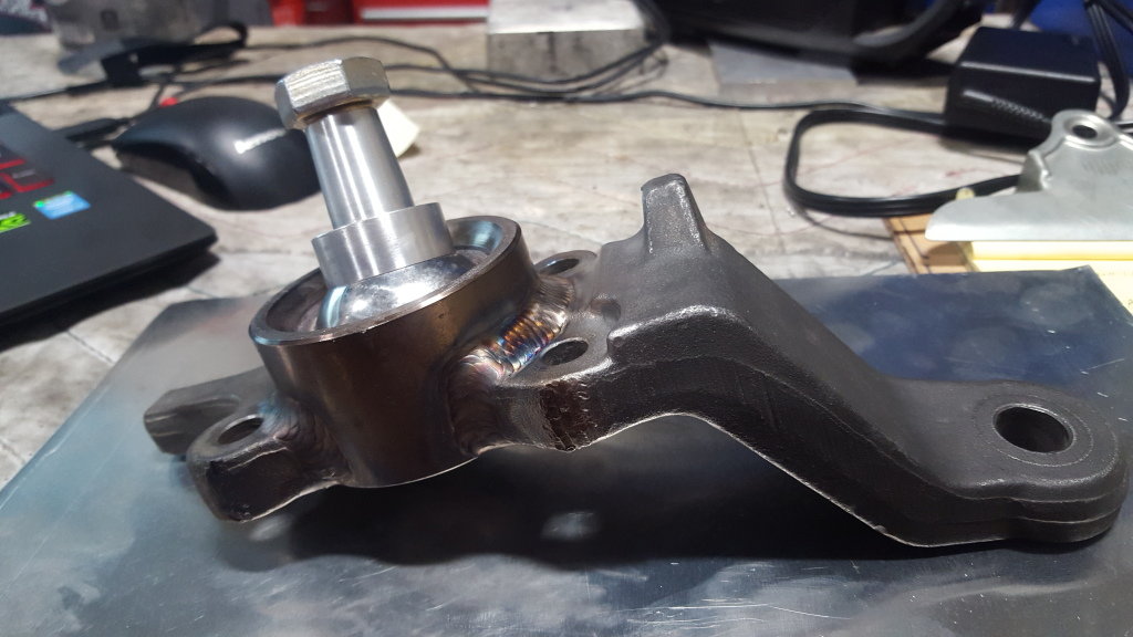

    01 SR5 TRD 4x4, '23 Bronco Wildtrak, 2017 HSQV FE350
    Drop bracket lift and booger welds

    Lots of dust and custom dents, Check Build
    Don't jinx it. I've been missing that one for a while, so now I'll probably loose the other one.
    I can buy a lot of ball joints for the cost of that.
    Didn't get my act together to try to warranty those while frantically finishing my truck. I'll keep a closer eye on the new set.
    That's not confidence inspiring. Need someone who really knows what they're doing to make the same part, and then maybe it would work.
    I think they would get creaky fast being exposed to lots of water and mud and stuff. I think the benefit would be the off the shelf uniball that's less than half the price of the OEM LBJs. If I'm going to be replacing them yearly, I would much rather just swap those.

    Probably true. Wouldn't be quite im sure. Im not sure you could find someone that makes them good. The photo I posted was the first guy I'd seen do that. But he quickly disapeared and never made more. The ebay dude is well..not a good choice.
    I'd wonder if you found a really really good fabricator with the right skill set if then it would be worth it. You'd want them TIG welded like the photo I posted and a full cup. But you have to hole saw a LBJ the right way too. Seems like a bitch.
    haha i never said it was cost effective in the long run haha

    The only way I would run something like this is to have two sets. Easy pull out and bolt in when the time is right. Then replace the uniball when it's convenient to do it. It keeps haunting me on wanting to do it. But I really don't know if it's worth it.
