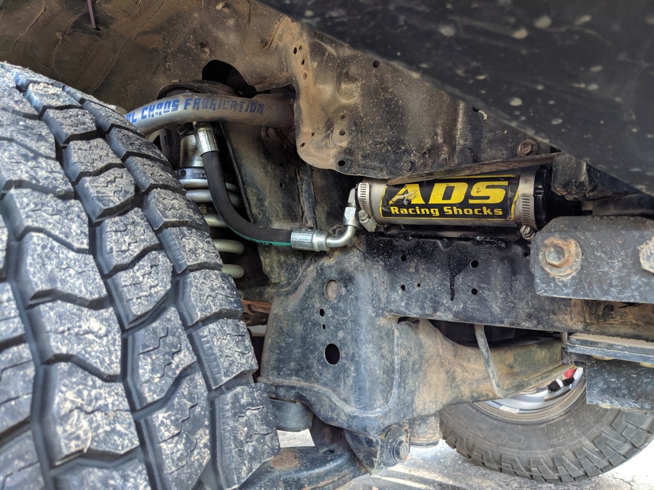

    Oh, and minor update. #superextracustom resi mounts and valving thanks to Tim!

    Best mounting location I have seen so far.

    Yeah it's a lot better spot on top of the frame then on the side. :thumbsup:

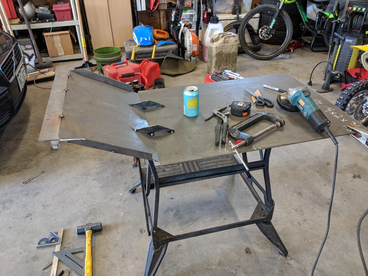

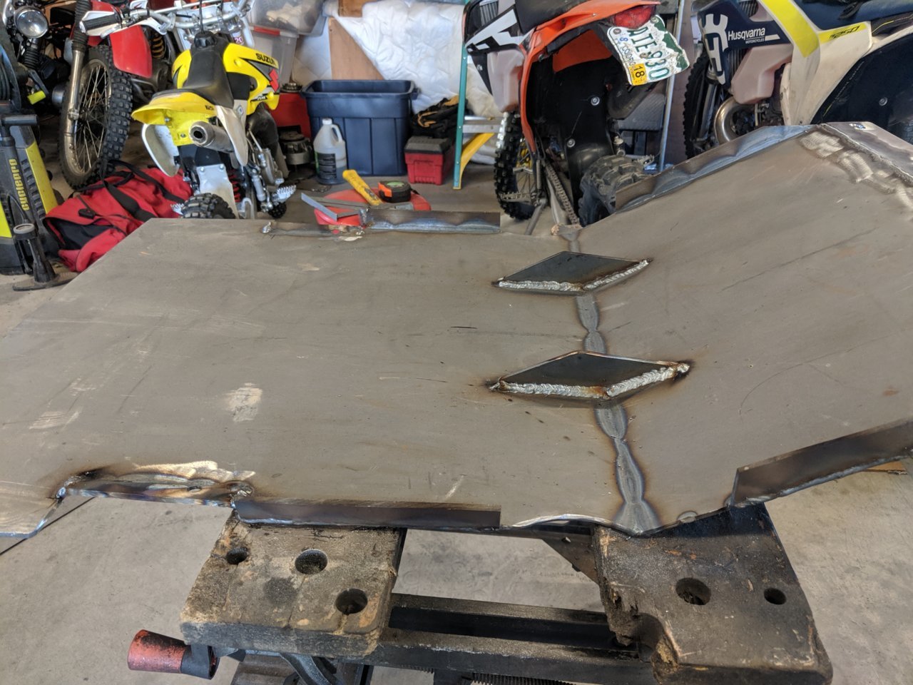

    Wheeling tomorrow. Probably about time I start working on a skid to fit my chopped up bumper... :anonymous:

    You finally use the piece you bought from me? Looking good! I need a welder again

    Yep, finally using it. Don't have time to finish it now, but it bolts up and will work for this weekend. That was a lot of work for an afternoon.

    Nice work! How thick?
