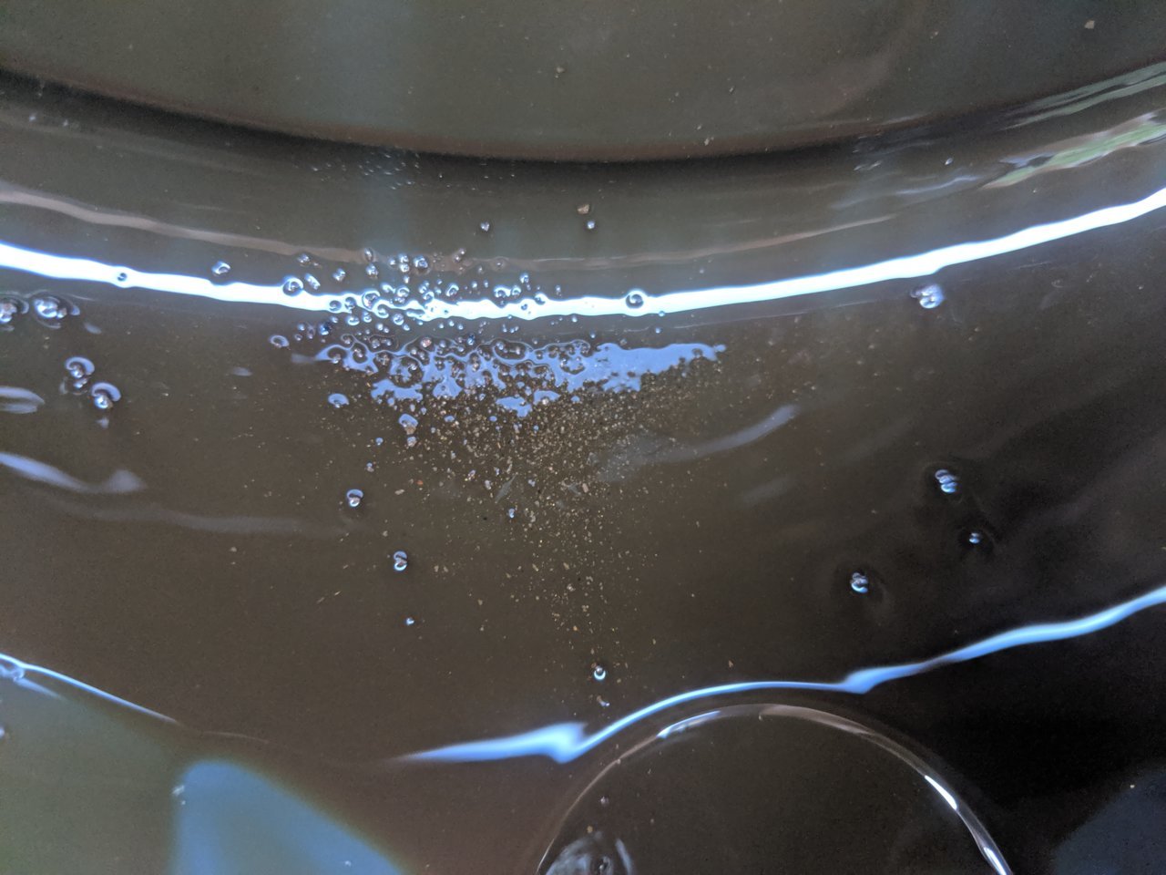

    Any thoughts, Brian? @thefatkid
    About to hit 290k. I've always had a little, intermittent tick at idle, but thought it sounded louder this weekend.

    2004 thingy
    Eeewwww, is it ferrous?

    Lots of dust and custom dents, Check Build
    No, sure doesn't want to stick to my magnet.

    The Trifecta of Taco's
    is that your engine oil?? jesus.
