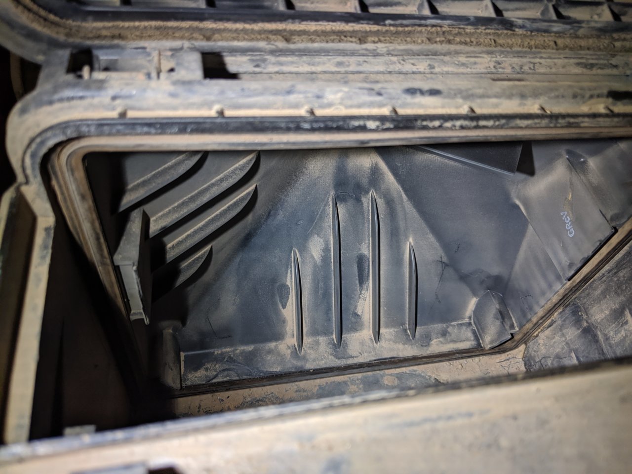

    Looks like you're running a K&N dirt ingestion intake

    What does it taste like?

    On the computer screen it looks like sand/dirt. Couldn't really tell on my phone. Really need to see it in person though. Have you ever seen mashed up bearing material before? Almost looks like aluminum shavings.

    Lots of dust and custom dents, Check Build
    Yes. :pout:
    Think you might be on to something.
    Quite a bit of dust behind the air filter. However, I've always run a paper filter and replaced them at least once a wheeling season.
    I remember comparing with @Deathbysnusnu once, and his looked better with a K&N. Maybe I should switch. :tinfoilhat:
    Pretty sure it would taste like motor oil. :cookiemonster:
    Feels like fine sand. Never seen bearing material before though, so don't know exactly what that's like. Doesn't look like aluminum shavings.

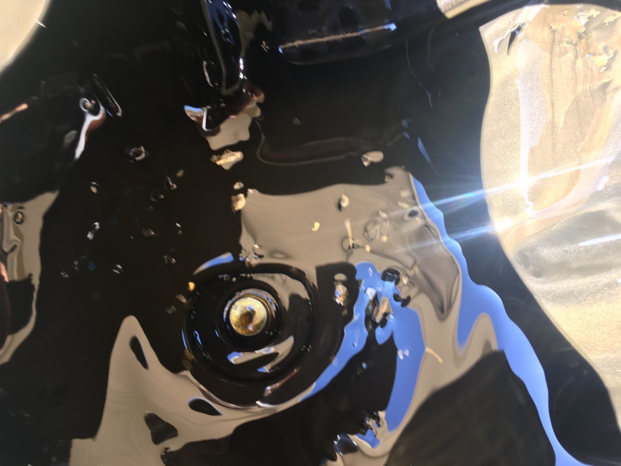

    My 3RZ main and rod bearings looked like this

    Cut your oil filter open and you’ll remove all doubt either way

    I'll cut it open tonight.
    What exactly am I looking for that will confirm bearings or not?

    Pull the media pleats apart and see if they are full of glitter basically. If you aren't sure but it seems like there is material in there, just scrape it out and rinse it in water to get to the particulate matter so you can better see what it is. Shiny is bad in a nutshell.

    The oil that came out of the filter looks like it was sprinkled with gold glitter.
    All these larger pieces are ferrous, and theres some on most every pleat.
    Well shit. :bananadead:
