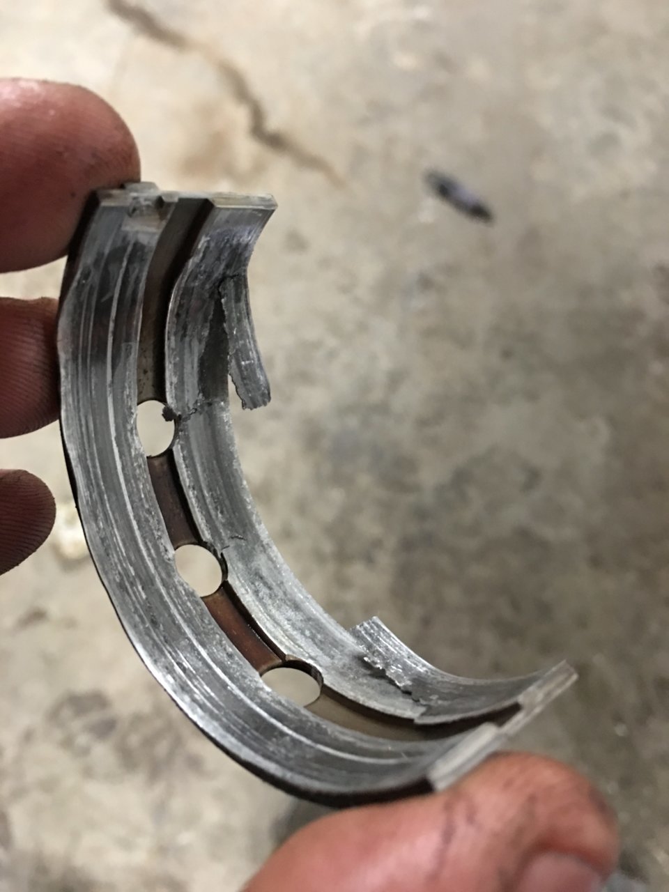

    You could try to roll new rods and mains in it now before it’s too late and they end up looking like mine. Still had oil pressure within spec and just a very faint knock under light load

    At this point I think I'm just going to pick up a used engine, or do a more complete rebuild on mine.
    It'll be interesting to see what the old bearings look like though.
