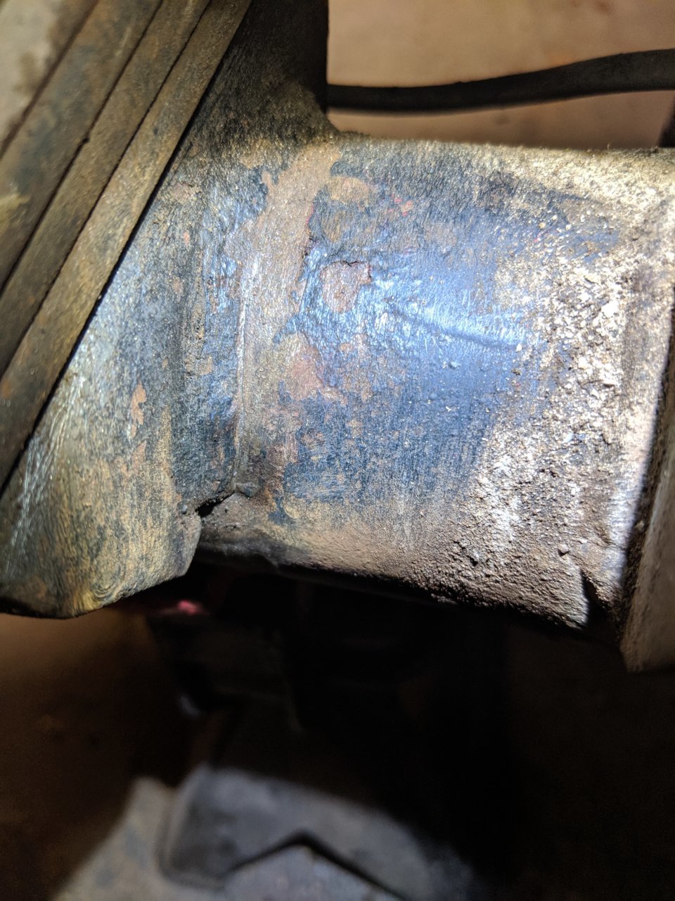

    Lots of dust and custom dents, Check Build
    Nope. Need to investigate this further... :annoyed:
    Looks like I'll be adding axle housing to the list of things I've cracked.

    '01 4WD, SR5, TRD & '13 TRDOR AC
    Yep. That's gear oil by the perch. Pulling it apart now to investigate further.

    Damn, Brett.
    Where did it crack?
    Confirmed.
    Can't catch a break this year.

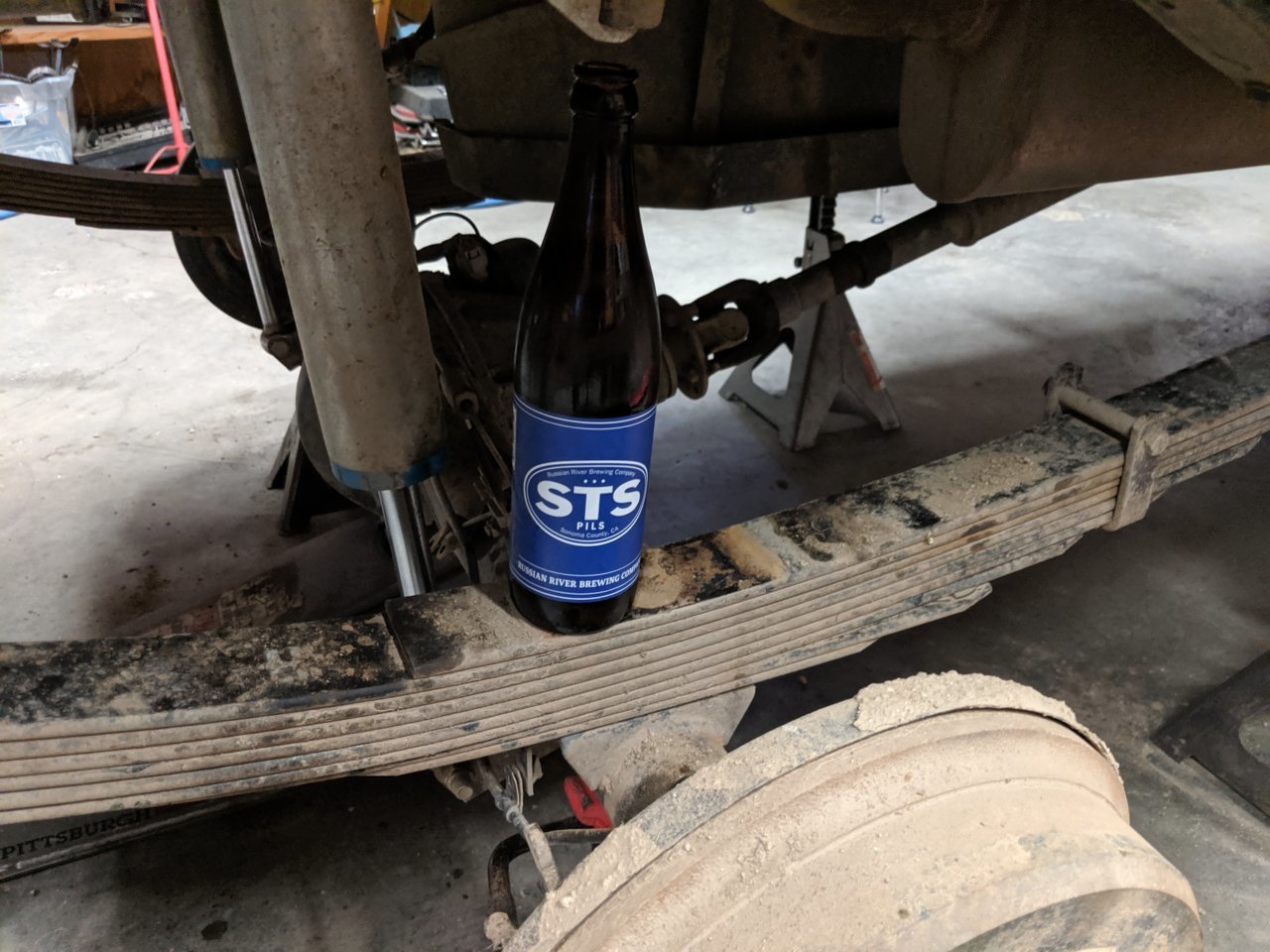

    I (temporarily) solved the problem. :cheers:

    With bubble gum?
    Is that something you can weld?
    Or will it just be a failure point now?

    Just burn it back together and you’ll be fine. My traction bar ripped the housing too. They are pretty thin

    Are those the stock perches?

    That is a drill the ends of the crack, cut off wheel the crack, and weld the fucker kind of fix! I've seen it a few times before, the housing is usually D shaped buy now.
    @Squeaky Penguin Don't forget to flush the fluid a few times with the cheap shit before the next trip.
    with my "new" housing and used gears I drain and filled at 100 miles and will again at 500 with good 75-110wt

    I always thought they were pretty thick, but I guess not. We'll see how it welds up.
    Always appreciate the advice, Connor!
    Wonder if it's bent too. I know people truss axles to keep them from bending, haven't heard too much about cracking housings.
    Yes. Interesting to see it cracked right along the factory weld.
    Trip next week again. Great timing.
    I'll weld it up best I can, daily the truck until then, dump the fluid, and send it.
