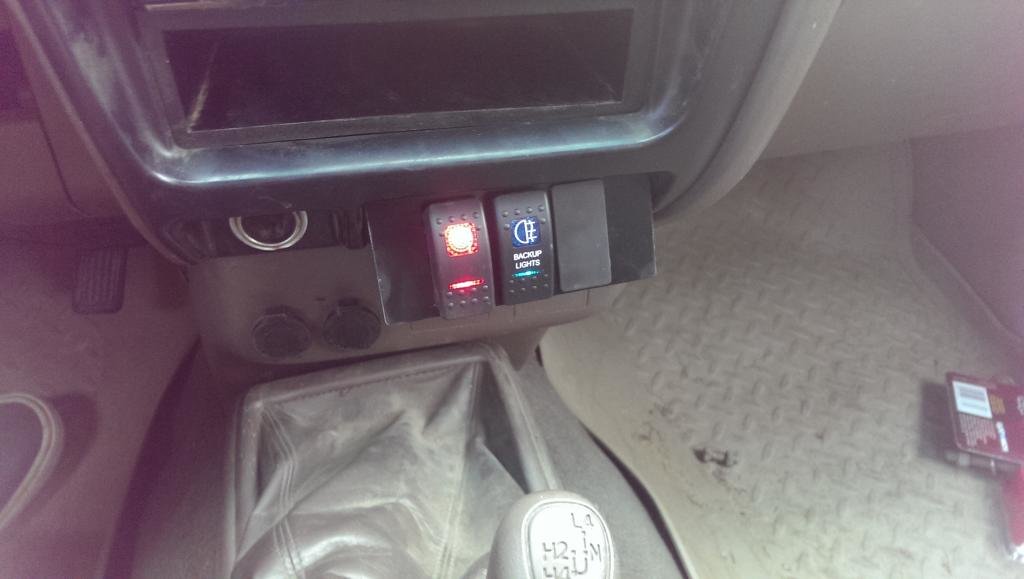

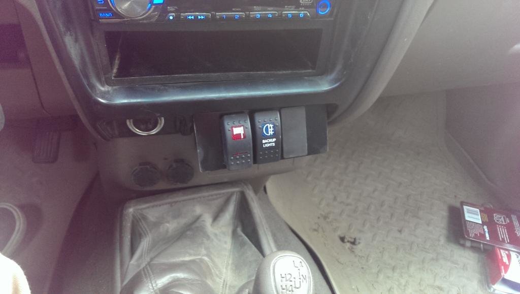

    OK, here's the new switch panel. Need to do some monkeying to get it to sit in there right. Also, I was a little impatient a got some finger prints on the paint, oh well...
    I moved the winch switch up from the slots just below here. Much nicer location. One thing I'm a little stumped on though is the wiring for the winch switch lights. For all my other lights, the lower light comes on and dims with the dash light, and the upper comes on when the switch is turned on. For the winch switch wired in what I think is the same way, both lights turn on with the dash lights, and only the lower one dims. Who knows, it's a carling switch but it came with the winch and was never wired to use the lights:

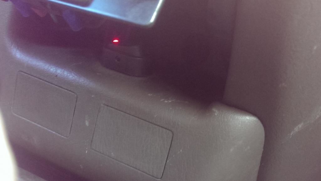

    Winch master on is still down here, although it may need to be moved when a thrid switch is added:

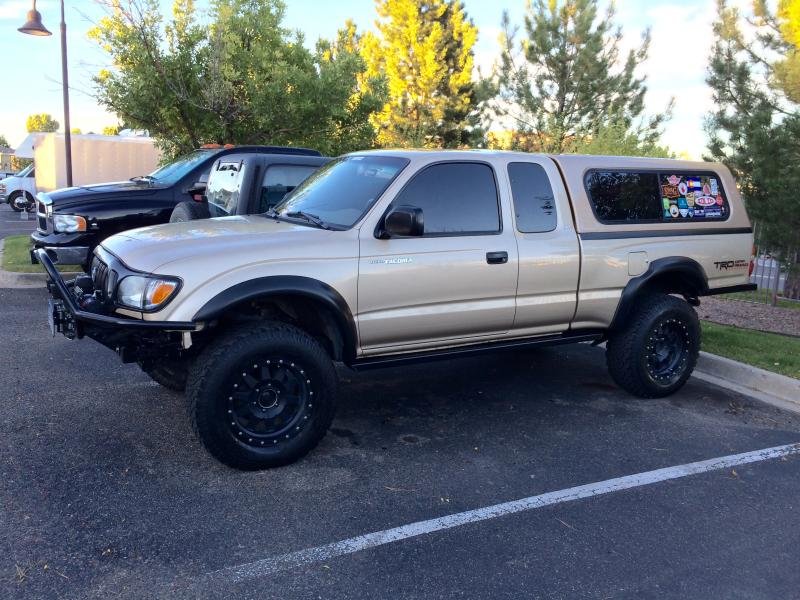

    They screwed up my half Duratrac half LTX order so I settled for these :D
    295/75/16 Dynapro MT. Not quite skinny enough, but they should do.
    Holy shit! The ride is so much smoother and quiter. Can't wait to break them in proper this weekend.
    KM2s, never again...
