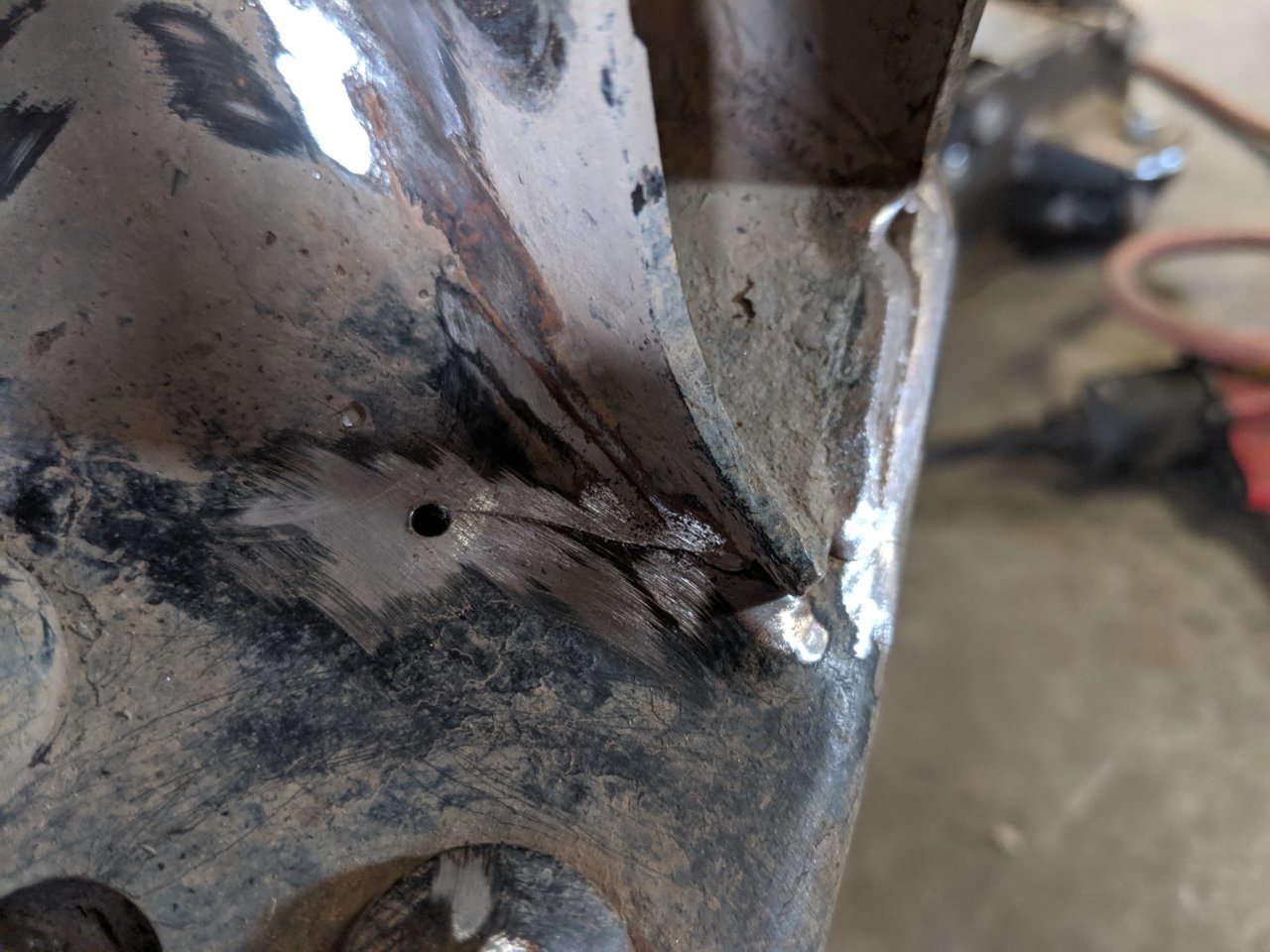

    In the last couples day's, I've found more cracks on:
    Bed Mounts
    LCAs
    Steering Rack Mount
    Time to burn it to the ground!

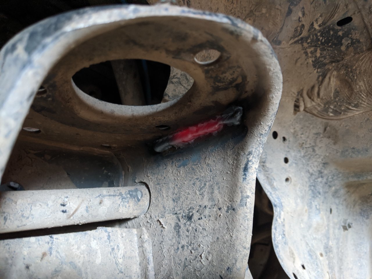

    I hear ya, but the ratio of paying to playing is getting worse. Don't even think I've put 5k miles on it this year.
    Anyways - truck fixed. Possibly check
    Still get a ride in. Check
    Enjoying a beer. Double check. :cheers:

    I see you grinding a surface for your bead but are you grinding out the crack for penetration?
  16. Sep 28, 2019 at 7:27 PM

    Yes. Put a little groove in those LCA cracks to lay the weld into.

    Is that weld inside the coil bucket going to be in the way of mounting the coilover?
