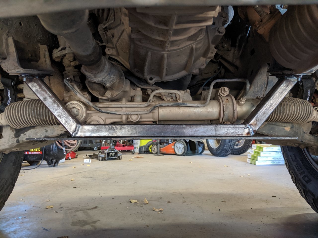

    Fabbed up a new crossmember to finish up my ifs skid after I pull it and add a few more bends, and build off of for a new mid skid.

    It's crooked...:boink:

    Good enough for it's purpose.
    Maybe once I smash it against a few rocks it'll straighten out. :rofl:

    I say this about some of my welds...

    Funny is say that about ALL my welds. :p
