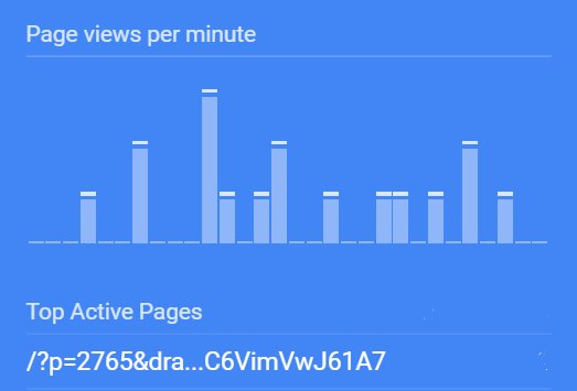

    Never. Nope, doesn't happen. I have no idea what you're talking about. Don't let Monte and Mike fill you with stories of the last hour in Colorado. It was completely uneventful for me. Easy peasy. Truck definitely didn't almost end up on its side. Nope, it didn't.
    (why is the : anon : smiley now a pumpkin?)
    Where have you been? :p
    You don't need them for crawling; you need them for speed.

    Enough. This link will work for 12 minutes. Then you have to wait for it to be posted.
    Edit: 12 minutes later. That was fun.
