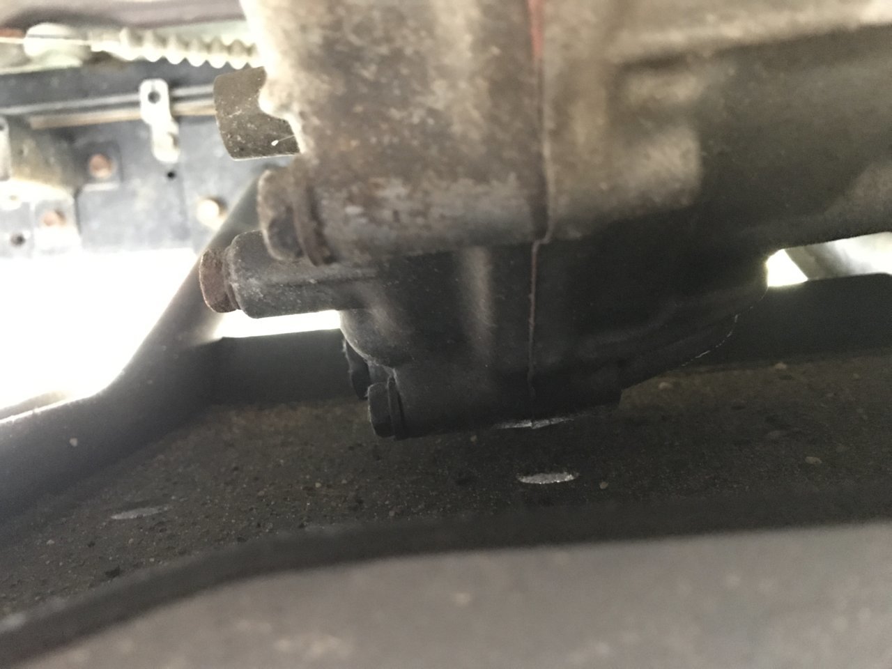

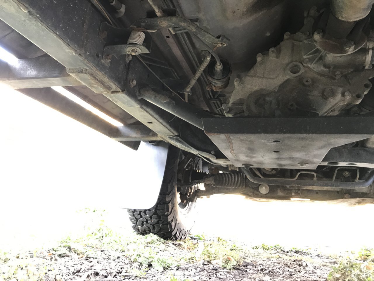

    I'm pretty sure there is an adapter available. Not sure about your rig.

    Ok, mine stock you can’t. One thing I’m really looking forward to from an Atlas.

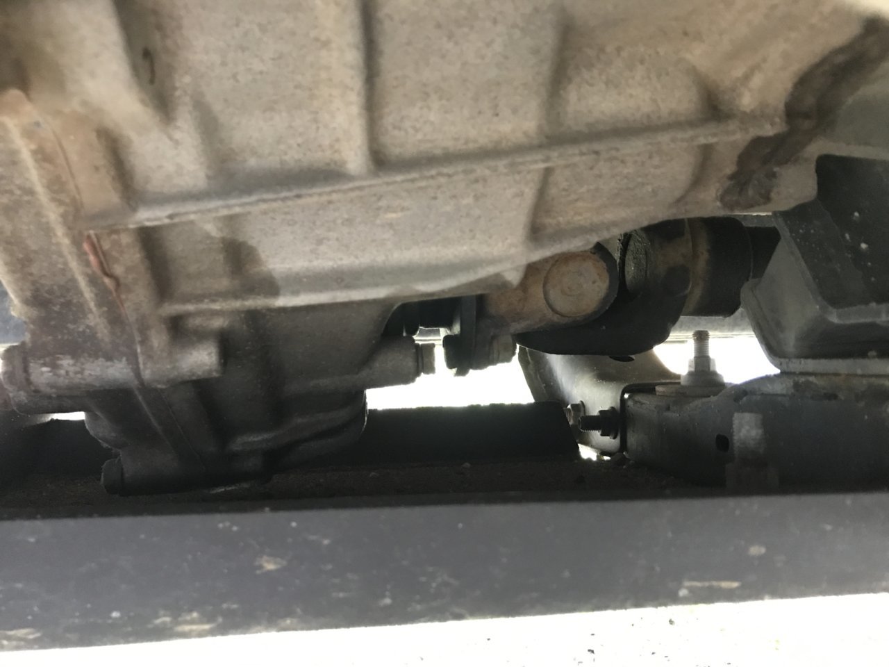

    this was going to be my suggestion.
    You can do it with an adapter plate. Then its just a flat belly setup. Be super easy to add a small skid to protect it.
    and even if you can't do a stock clock(pretty certain you can) just get a crawl box. I think @jubei has one you can borrow :p

    I really don't think anyone makes one, unless you're going to a dual case setup.

    apparently Bud Built makes a ring for clocking the stock tcase. Not on their site but I think a phone call will get you one.

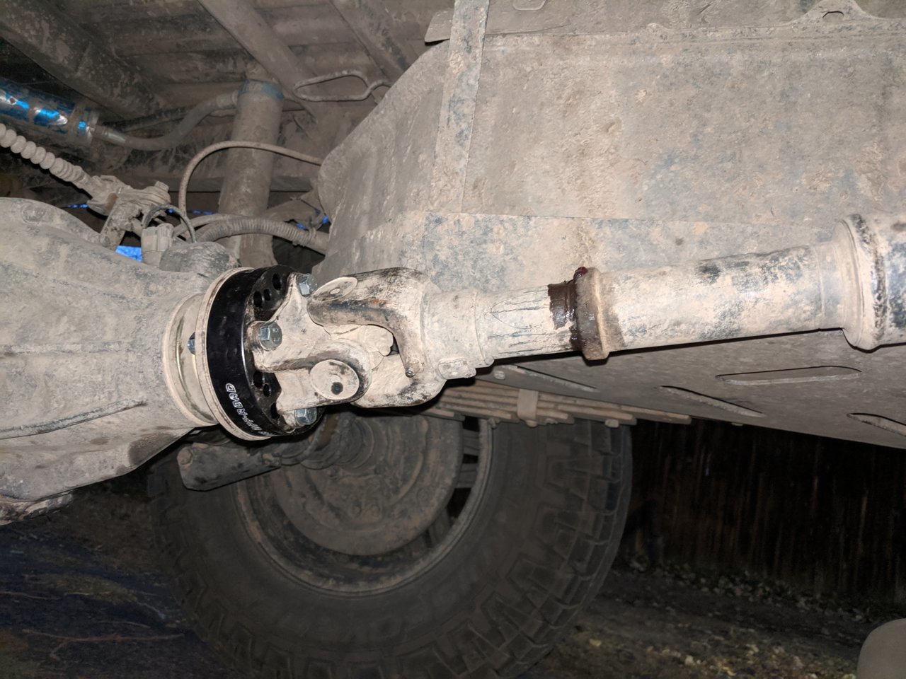

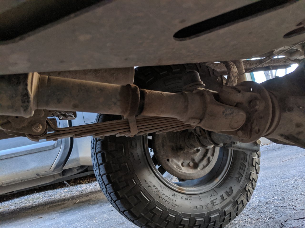

    Tossed a 1" driveshaft spacer on. Getting more play in my slip joint, I think mainly due to it being over extended. Don't think it helps that I didn't realize the zerk wasn't getting any grease to it either, just piling it up in the bottom.
    May get my spare driveshaft lengthened and retubed if I want a permanent solution.
