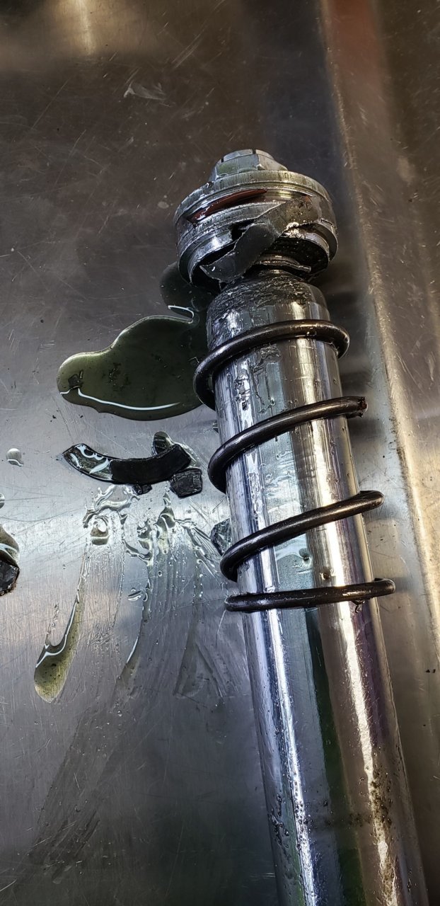

    All that they are installing is a linear spring inside to slow down the last 2-3" of rebound, maybe shorter with the 5" travel shocks our trucks have. It's been a standard issue part on airshocks for years.

    Probably still is, Air shocks do not have much for rebound so the internal spring helps them a ton. At least till the parts break inside and wreck the entire shock.
    Pic for fun of some SAW Air shocks. The thick washer the spring is caught with below the piston broke and the pieces destroyed the internals.

    Nice carnage!
