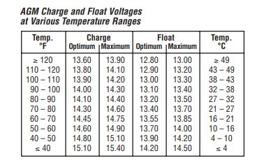

    It is kind of new however, I have been working with Off Grid engineering the past few years and we've run them as a recommendation for most dual battery systems. Some over which have been running this set up for a few years now without any downsides. The alternator still functions exactly as Toyota intended charging when it needs and reducing when it doesn't all it does it increase the baseline voltage.

    Means I'm below the optimum charge voltage if it's below 70 degrees. However, there was also a warning about not charging above 14.6v at room temperature. Makes me wonder if anyone is doing harm to their batteries by upping the charging voltage in warm seasons/environments. :notsure:

    Alternators specifically older Toyota are temperature based chargers. They charge the highest voltage when cold, say below 32°f and then charge at a lower voltage at above 70°f, so if it's charging 14.2-14.7 it's charging 14.7 when you start you truck in the cold. Then, as it warms and the battery becomes more charged, or it's hotter out, the alternator reduces charge To 14.2 to reduce the charges of "boiling" or overheating the battery. Batteries function best between about 60°-75°f.

    What voltage does you battery say it wants for float and charging voltages?
    Yes, it’s not needed but helps get the voltage up to what some agm’s want
