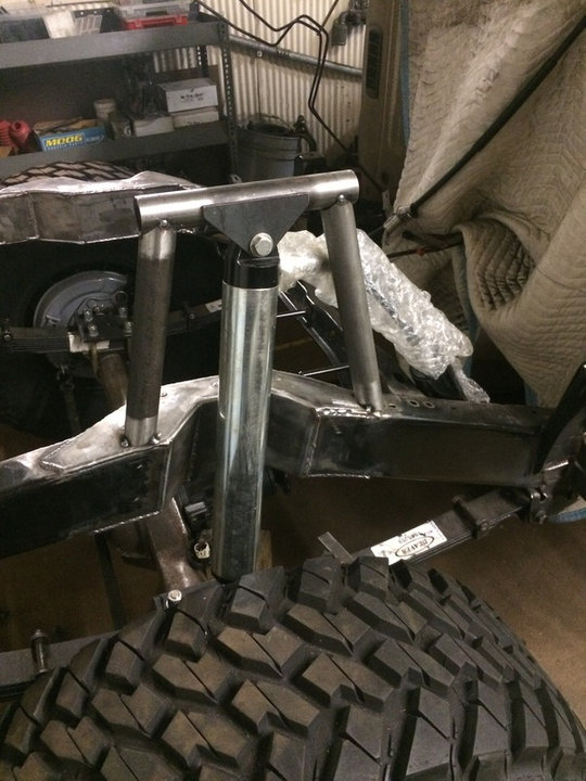

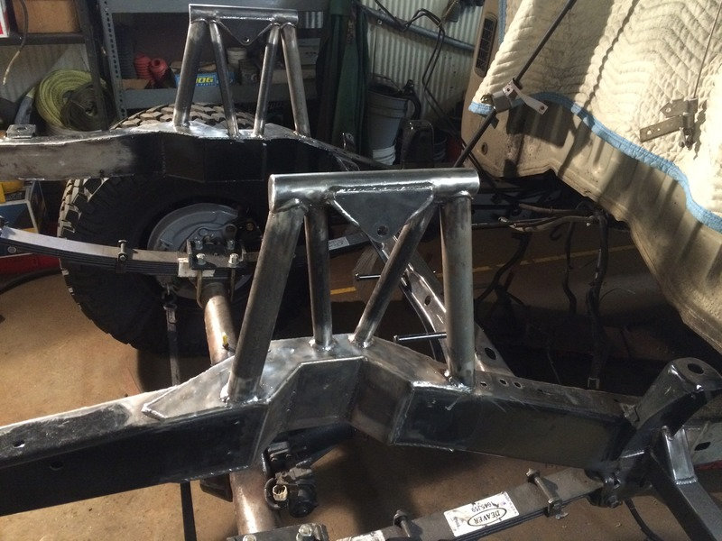

    If you are going with the FJ80 rear, I'll point you in the direction of my buddy's build and what he needed to do to go outside the axle.
    https://www.pirate4x4.com/forum/toyota-tacoma/2423298-godzilla-2-0-a.html
    I know the photos are blurry because photobucket is absolute shit, but you can view the pics if you open them in a new tab. Basically he notched the frame in order to get the clearance, obviously I know you can do it, but just wanted to send what it might end up being.

    I was wondering about notching the frame, but that looks like more than I was envisioning.

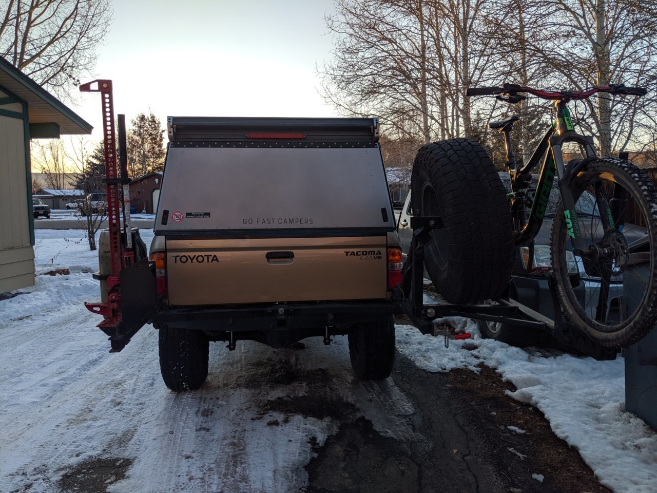

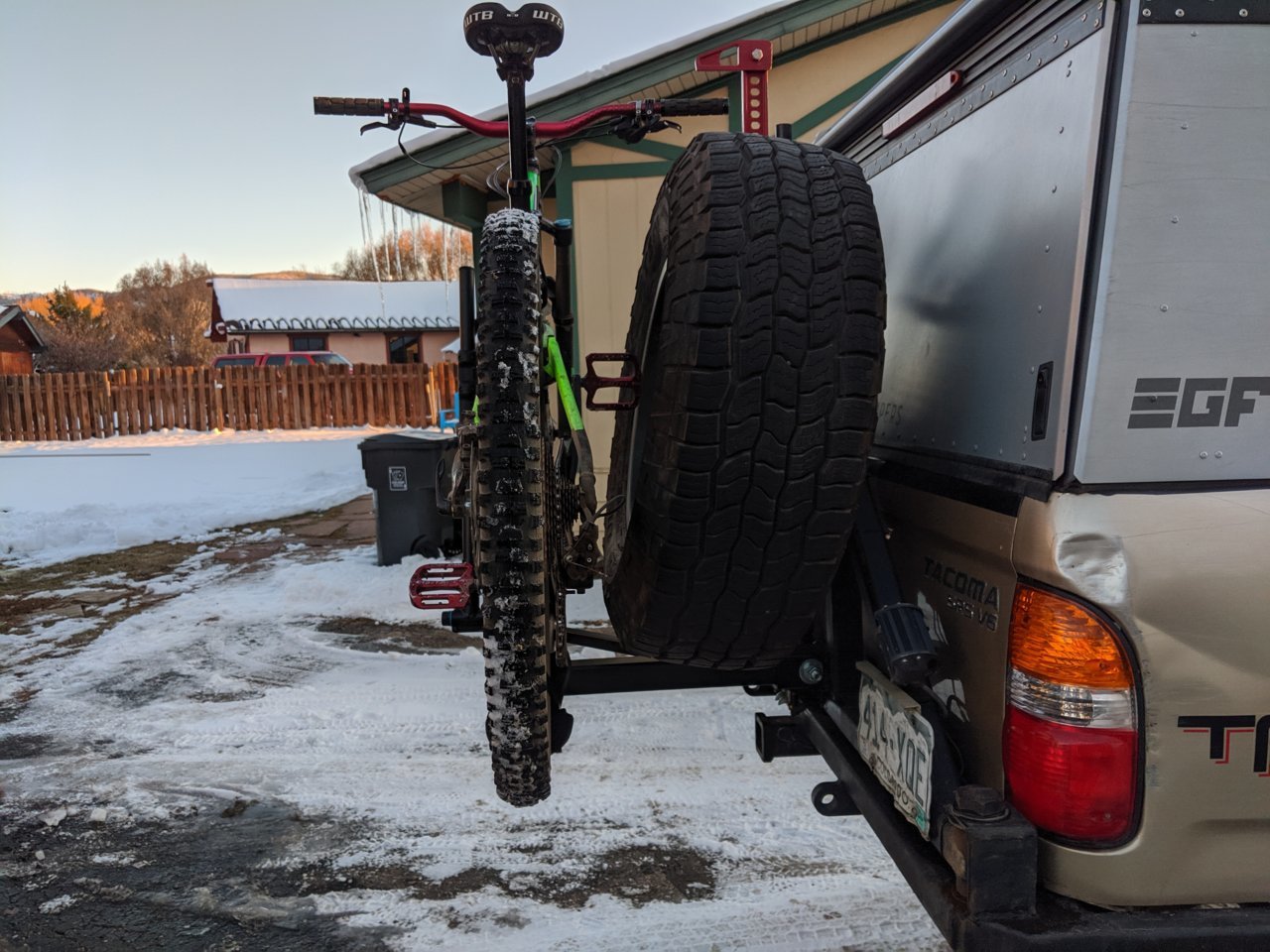

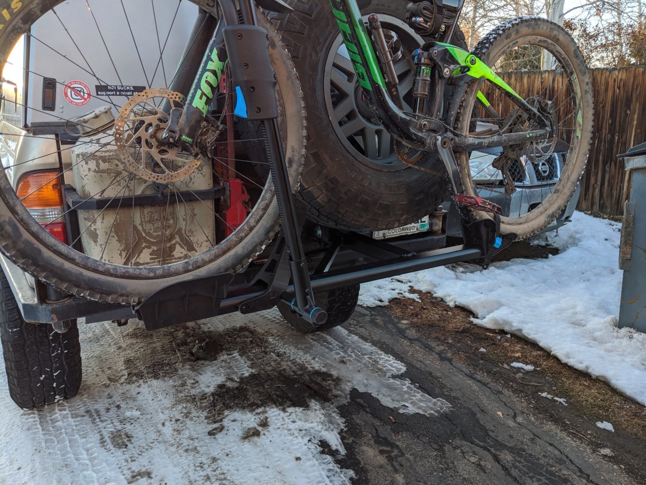

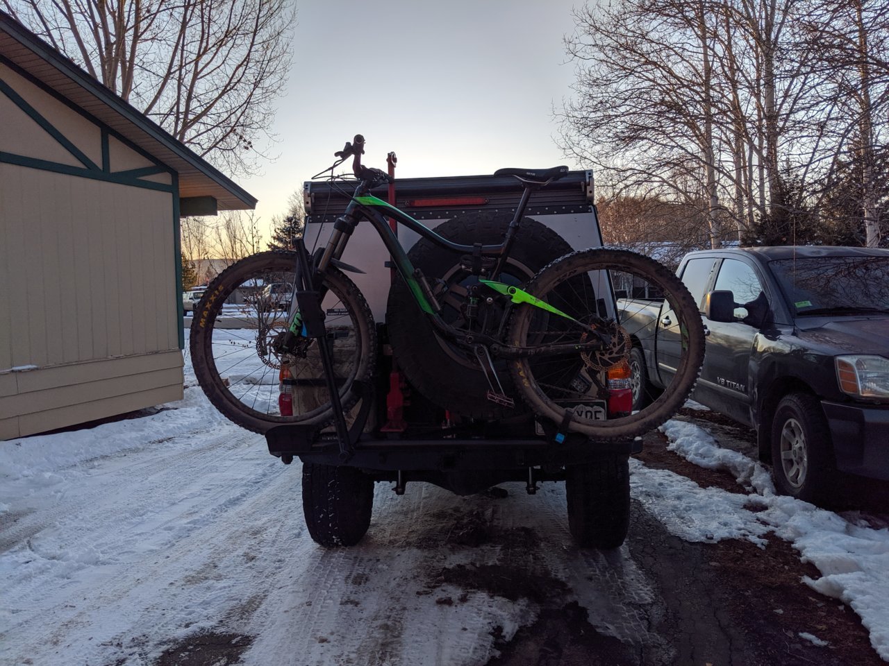

    Great idea on a receiver mount location, just got to wrestle the heavy pig (my Kona 153 Process) up that. How are you liking the Giant? 27.5? I’m jonesing to get my Kona back down to the states and get a pilgrimage to Moab, it’s been too long....

    Yeah, it's a Trance 27.5. I've been very happy with it. It's a Giant, so nothing too special, but I think it's a solid bike for the money.
    There were a few other similar spec'd bikes I would have preferred, but couldn't find anything in my budget.
