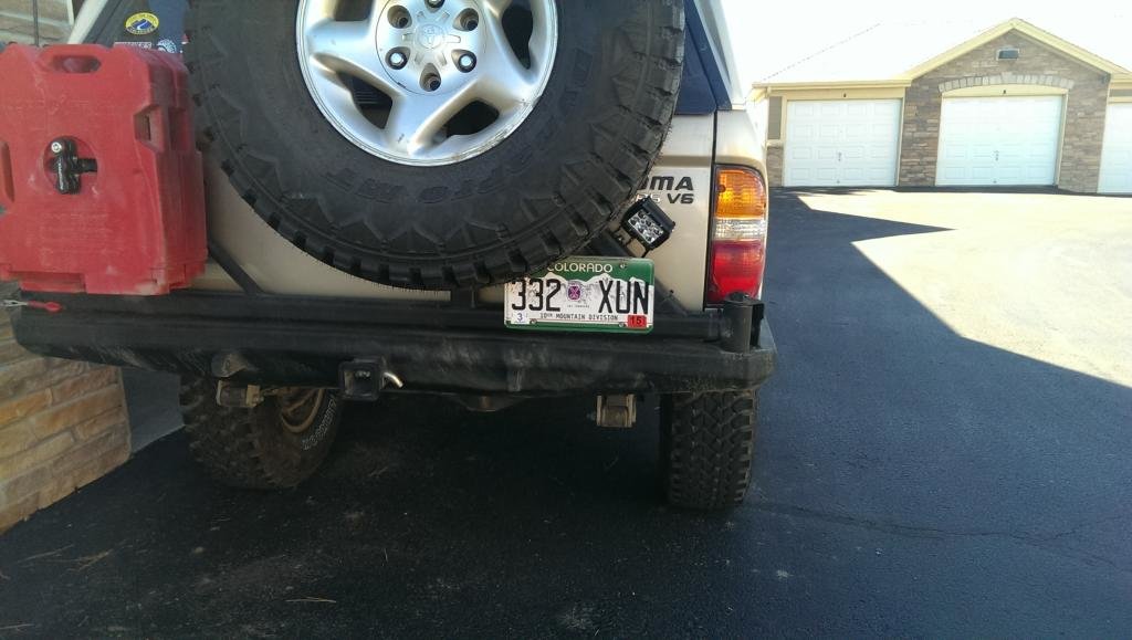

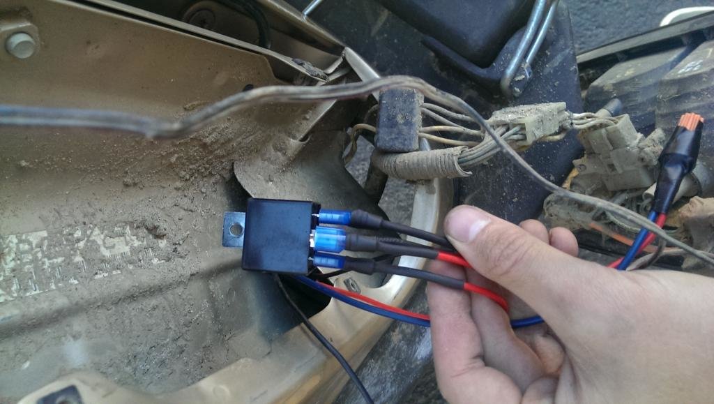

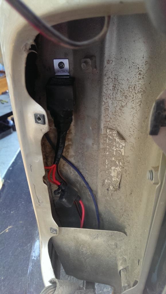

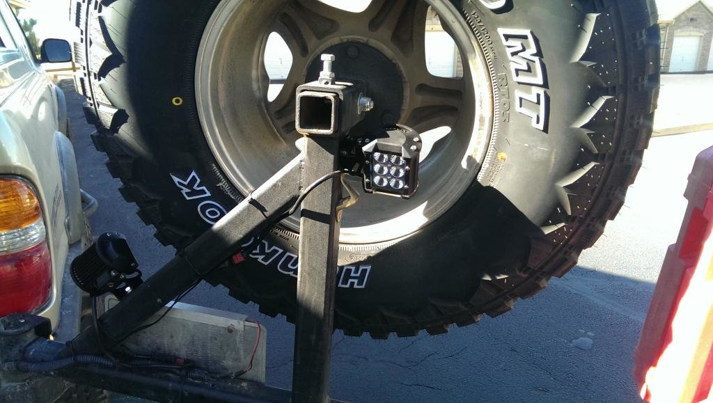

    Worked on wiring and installing the lights on my swingout today. First was to run the wires to the back. Ran a 14ga wire straight from the battery in case I want to add anything else back there. Relay is tucked up behind the taillight:
    Taped it up and installed:
    Here's the only places I really found for the lights:
    Ended up removing the reflector panel from the light behind the tire. Turned it from a spot to a very wide flood. Looks a little funny as you're looking at a circuit board, but actually worked out pretty well.

    good idea on the reflector.
    pretty sure the style of reflector is the only difference between spot and flood

    Just wish there was an inbetween. Without any reflector, it makes a very wide flood. Which actually works well in that location. But I still have too much of a spot for the backup light. That's the biggest downfall of these cheap lights, way to acute of a beam angle. I guess you could cut like 3 of the reflectors out, have a half spot have very wide flood.

    wad up some tinfoil to get it all crinkly then flatten it back out and cover the original reflector with it, cut out the holes and replace it

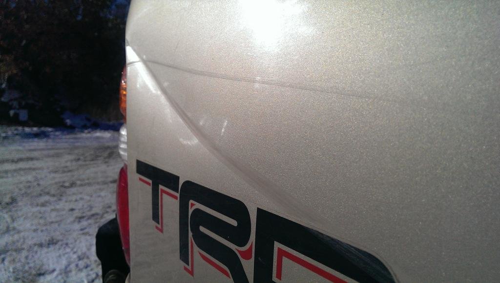

    More character added yesterday. It's always the passenger side with me
